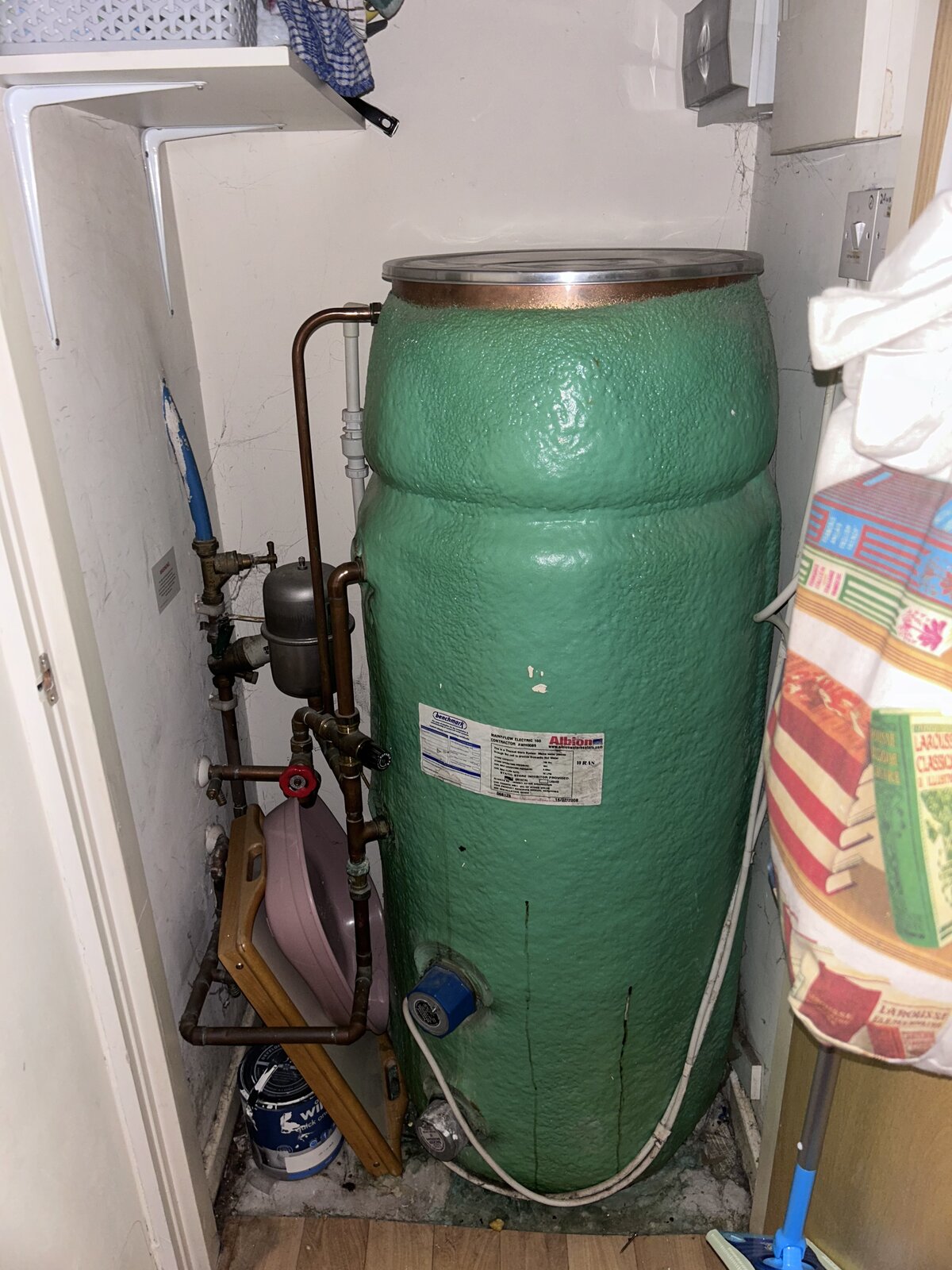

Hi everyone,

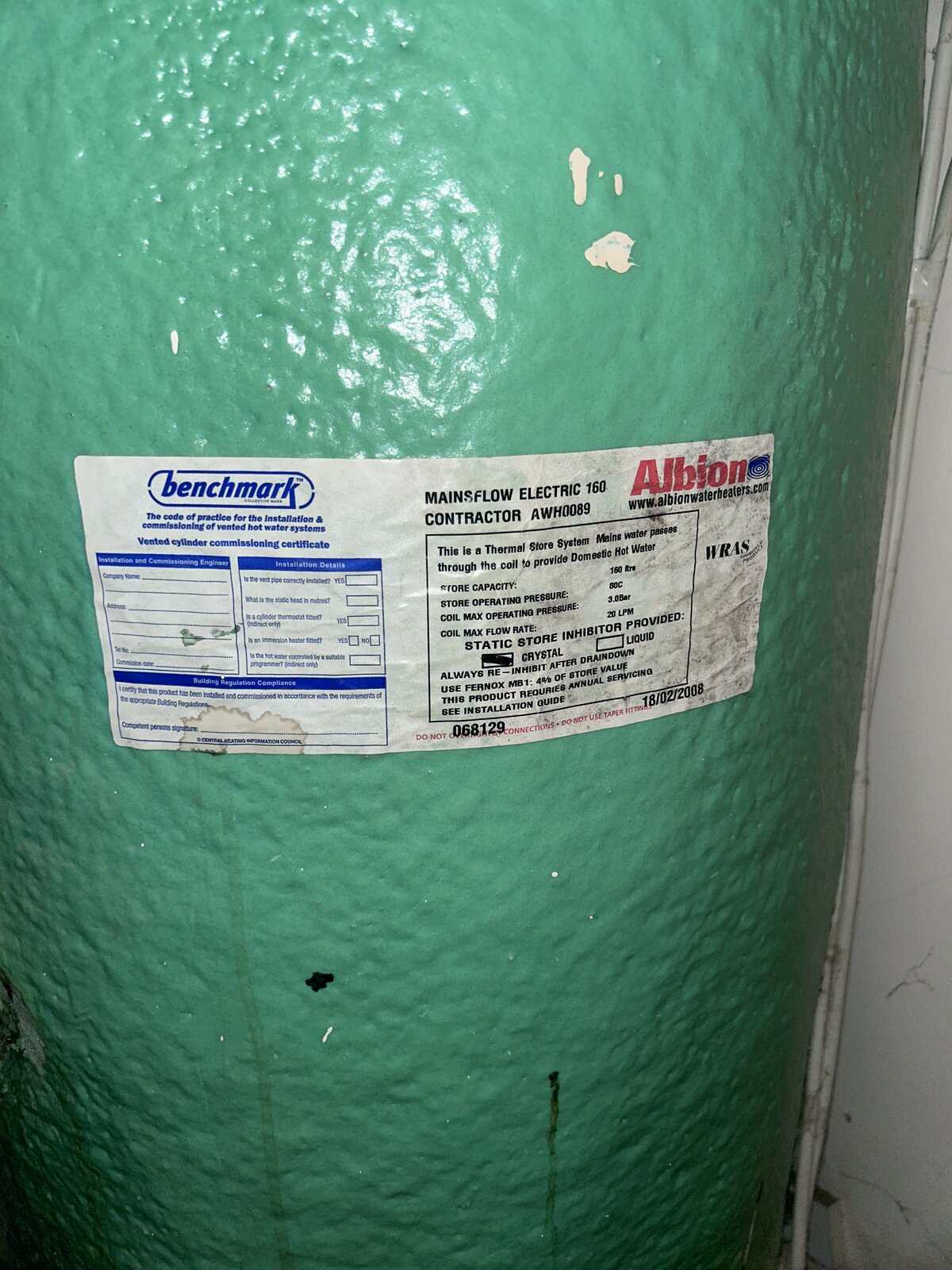

I'm a 20 year old newly living without their parents and need some advice. My electric bill is crazy (~£200 a month) considering I live in a one bed flat with only other person. We're doing everything we can to reduce our energy bill (we dont have gas) and nothing has changed so we've come to the conclusion it's due to our boiler. I know very little about this and any information especially when it comes to the energy efficency of it would be greatly appreciated. It is an Albion mainsflow electric 160 contractor AWH0089 that appears to have been installed in febuary 2008. Any help would be greatly appreciated, I understand that times are hard for everyone but I'm currently paying about as much as my parents so it doesn't seem right.
thank you in advance
(Some posts have been removed)
that's creepy as ****. the issue isn't heating we don't use our electric radiators and only ever touch the boiler to put the boost on to get hot water cause thats the only way its warm enough to wash dishes or have a shower (even though it still takes about an hour to heat up).
this is the only sticker on it, if more pictures are needed lmn. its honestly a huge ****ing thing

Are your pipes insulated?

Are you pipes insulated?
honestly unsure, cant find anything about it in any of the info we were given when we bought the place and i don't have the contact info for the previous owner. property manager just keeps saying that they don't have the info on file for anything to do with the boiler
Send a better picture of the cylinder. Stand back
I replaced one of these a few weeks back.
Using immersion heaters is expensive but that what you have there isn't insulated like the modern ones are. And I can't imagine the immersion are as effective as a new unvented direct cylinder.
You loosing heat from the header do all you can do is insulate, other than replace it.
do you recon i could replace it with an electric boiler and get it all insulated properly or is that not a great idea
My Neice has one and it's expensive. So until technology improves I'd say no
