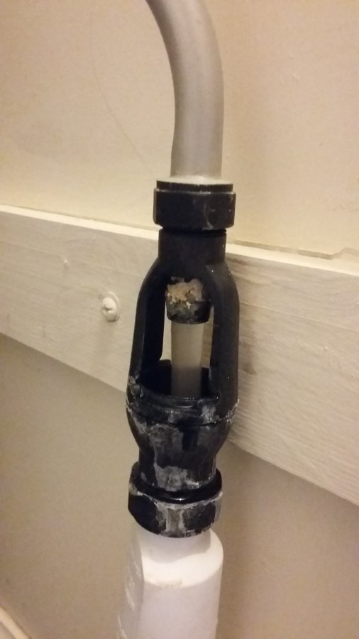

First of all - I'm completely new at this, so please forgive what is probably a very basic question. I've googled without success and would really appreciate some help.
This morning, there was a fast flow of water through a pipe with an open section, next to the boiler. It was loud and initially we were concerned that there was a leak. I turned off the immersion heating switch and after 20 mins or so the water flow stopped.
Does anyone know what this pipe is for, when we should expect to see water flowing through it, and if this indicates a fault with our boiler which will need fixing?

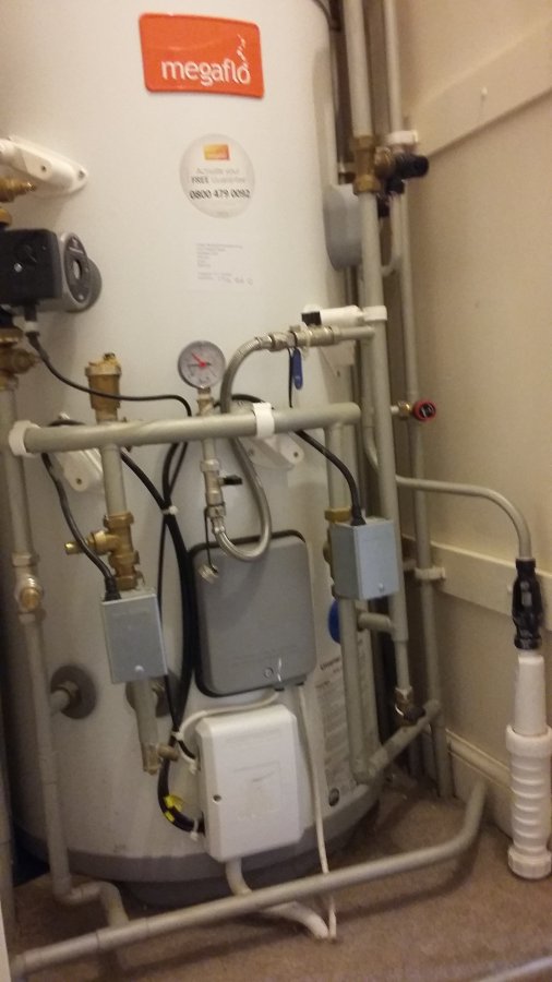

I've attached a couple of photos (hopefully) - one is a close up of the open pipe, and the other shows the whole boiler with the open pipe at the bottom right of the image.
Any advice much appreciated.

1. Its not a boiler, its an unvented hot water cylinder.
2. These cylinders should be serviced annually. They contain water at mains pressure, which when heated will be at a higher pressure. If a cylinder fails (almost unheard of), it has the explosive potential of a bomb.
3. Water flows through what is known as a tundish (the black plastic thing with a viewing hole) to relieve excessive pressure and or temperature.
4. Because it is unvented it must only be worked on by someone with what is known as a "G3" qualification.
5. You will need to get an appropriately qualified engineer to diagnose the fault and correct it.
Yep. As above. Try regeneration of the air bubble/gap first. This is a user procedure that you can do yourself, before having to call in a G3 engineer.
However, even if this cures the fault get your Megaflow booked in for a service, and maybe your boiler at the same time (y)

A mentioned you need a G3 qualified technician to repair the fault. The flow is from a valve that opens to relieve excessive pressure in the cyclinder or to dump water that has become too hot.
If the water through the open section ( the tundish ) was very hot then the technician needs to check the immersion heater's thermostat and over temperature cut out.
If it was cold water then the technician needs to check the pressure regulator on the cold water supply.
The relief valve(s) needs to be tested and maybe replaced.
