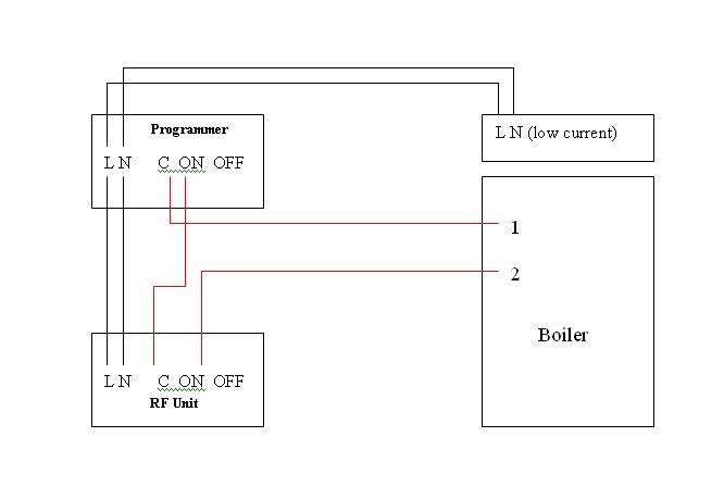

Okay, you'll need to find some way of getting power to the programmer and RF unit for the room stat. Preferably you want to take it from a supply within the boiler but if it hasn't got a low current mains voltage output you'll have to install a fuse spur from another source. This will only be for the power to the programmer and RF unit. You then need to take a cable from terminal 1 of the boiler (remember this is a voltfree contact so must never have 230V fed on to it) to the Common terminal of the programmer. You will then need to connect the CH ON terminal on the programmer to 1 on the RF unit. You then need to connect 2 on the RF unit to 2 on the boiler. I've done i diagram below which will hopefully help. You can do all volt free connections in flex but make 100% certain that you do not put 230V down 1 or 2 on the boiler as you'll blow control fuses and worst case damage the electronics.
With the control wiring sorted you just need your high current supply 16mm T+E by the looks of it from your consumer unit. I recon a 63A rotary isolator would be your best bet for terminating a cable that size then another piece of cable in to the boiler. That should be all you need to do for a central heating only setup.

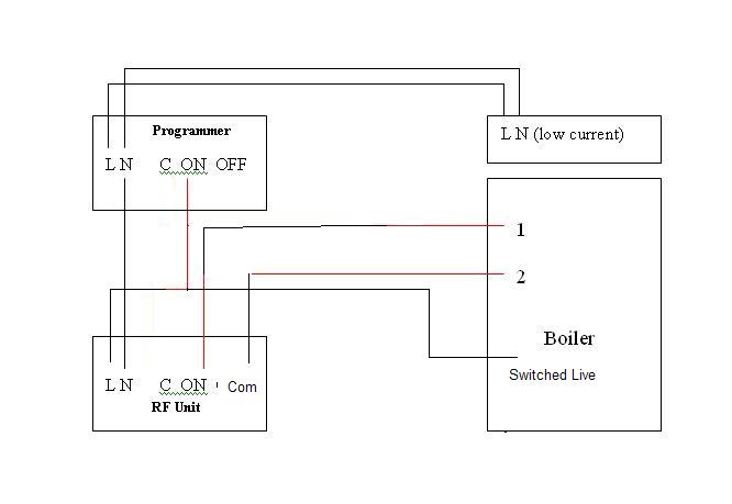

Thanks for all your help with this. I've been doing a bit more digging and to me it looks like it should be wired thus...
Any thoughts would be most welcome.
That's not tight. The RF receiver needs a permanent unswitched supply.
The first drawing was correct.

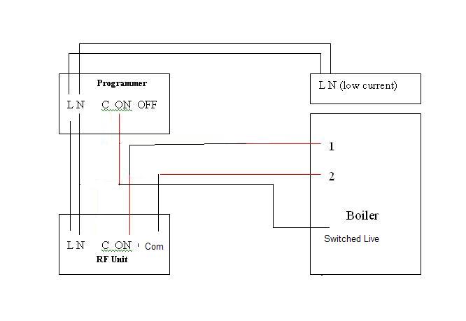

But the boiler also needs a switched live. How about this?
I'm not disagreeing with you, but as I said earlier, I haven't done CH wiring before so I'm just trying to get a full understanding. If I'm wrong then please tell me, I'm just trying to get it right.
It doesn't. The swiched live is optional.
You just connect your thermostat / time switch combo across pins 1+2 on the boiler.
Steve
As Slup said my first drawing was correct the switched live is optional, the instructions state that it's only used when the boiler is heating DHW as well as CH. Your only using it for CH so terminals 1 and 2 are the only ones that need to be used. All things considered it would be far simpler having a wireless programmable roomstat but if what you've got is all you've got just follow my diagram and it'll work. Just remember (and i can't say this enough times) do not put 230V down pins 1 and 2 of the boiler otherwise you will have problems.
If it makes it any clearer there is no physical connection between live and common on either the RF unit or the programmer. The only thing that is switching within these units is a relay which changes between common and on and common and off.
