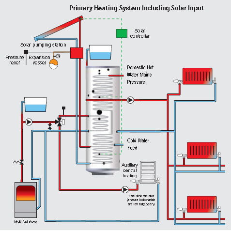

The boilermate was a method of getting mains hot water pressure with a stored water system without the need for an annual pressure test.
the idea is the DHW is heated as it is required by the store of hot water.
This can be taken a step further allowing multi heat sources to be combined, there are also systems where the whole tank is at mains water pressure, but these need an annual test, which is not required with open vented tanks.
The modulating gas boiler removed the need to use other methods to get mains pressure hot water, I had a very early system called a Main 7, where the boiler fired up as the tap was opened, but since the house still had 22 mm pipe work, there was quite a delay between opening the tap, and getting hot water, also there was a min and max output, so had to select a shower head which would use over the min output of the boiler.
As time went on, the instant water heater was combined with the central heating boiler, and also a method was developed to gain the latent heat from the flue gases, to do this the temperature of the return water needs to be cool enough, this required more careful control of the flow rates, the water store could help ensure more economic flow rates, however be it direct or indirect the big problem is it needs setting up correctly.
Since I now use an oil boiler, I am not worried about return water temperature as it does not modulate, but the glenhill system will allow me to use water heated by the central heating to get a powerful shower rather than direct electric, so it would save me a lot of money, however my problem is my floors are not easy to lift, so to change would cost a lot of money to lift and re-lay floors, or replace ceiling, so I have no real option, to use the boilermate would cost too much to install.

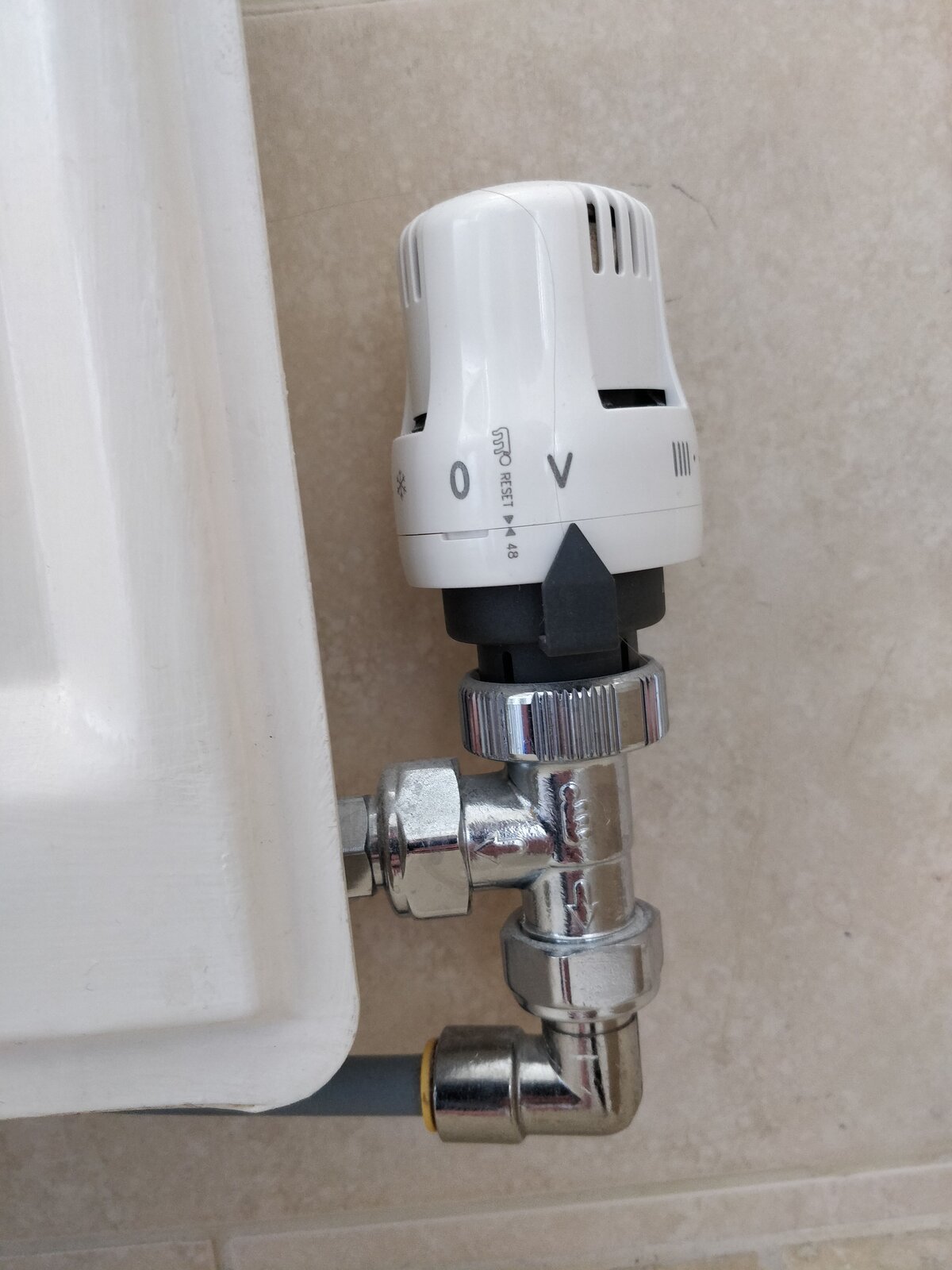

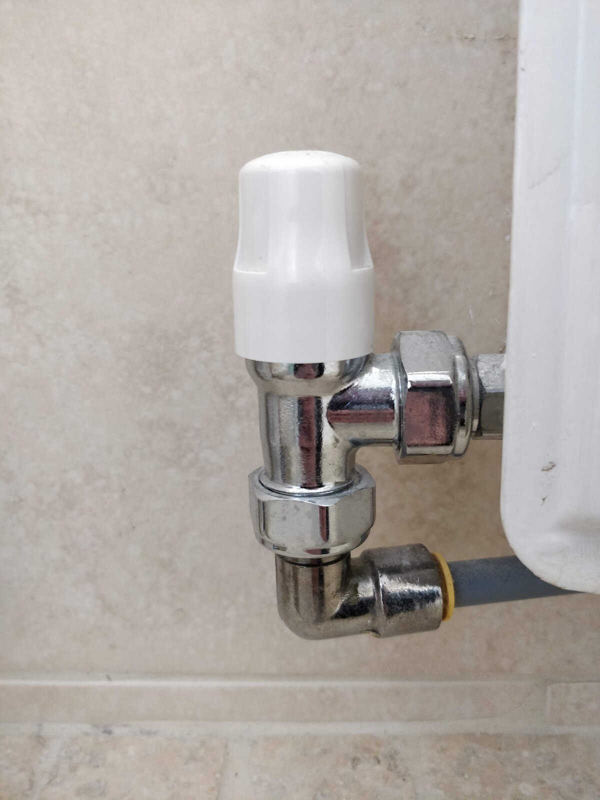

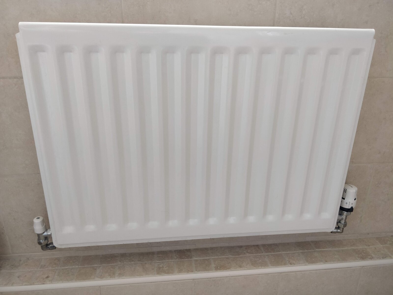

We might have got to the bottom of the problem, is your problem Rad a designer vertical Rad by any chance ? post a pic of it and the valves, it is definately nothing to do with the boiler mate , or your boiler for that matter

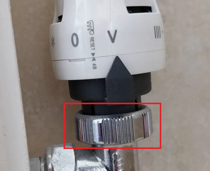

Unscrew the red highlighted part which will allow the top white section to be removed.
Underneath should be a small pin sticking up, which can be pressed in and will spring back.
If the pin is jammed in and won't move the valve is permanently closed. Hitting it with a small hammer may loosen it. If not, new valve required.

Thanks @flameport, those pins under the thermostatic valves are the bane of our lives!... we have to check them all every year. However, in this case it's definitely not the issue.
Would be great to get it sorted, then look at replacing the Boilermate further down the line.
