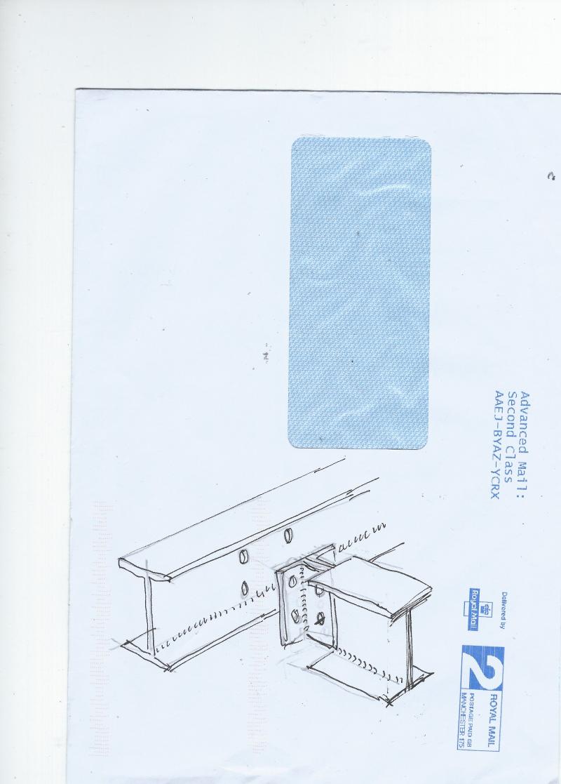

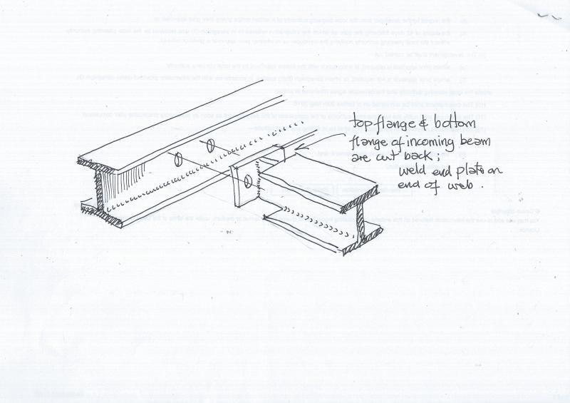

Bolting/Joining RSJ Flush
For shallower beams (6" - 7" deep top-to-bottom) that is the only practicable way of getting them flush.
For an 8"+ deep beam, you can use two pieces of angle bolted to each side of the incoming web, and then to the main beam. But this means more cutting and drilling.
see back-of-envelope sketch,
Thanks excellent drawing
