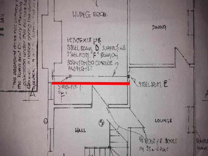

Here are the SE original drawings. The beam 'D' did not originally rest on window but because of mis-measuring I presume on his part it falls there.
I will get him to do stress check for the timber and if necessary replace. Any other input would be much appreciated.
http://media.diynot.com/98000_97277_91844_60090115_thumb.jpg http://media.diynot.com/98000_97277_91845_76553417_thumb.jpg
Just to clarify, RSJ new position is here in red. Builder thinks it will be fine and I can see his point but he is happy to change the timber for concrete lintel if i'm worried overly about it..
Two questions :
1) Why has the beam moved south to the new position
2) What happened to the prop post "F" that the original beam location was carrying
Even in its intended location the detail of how the beam ends being supported on their "pads" should be shown, since the drawings tend to suggest it may be sitting on narrower pads (wall thickness) than the text states (300x150x100)
