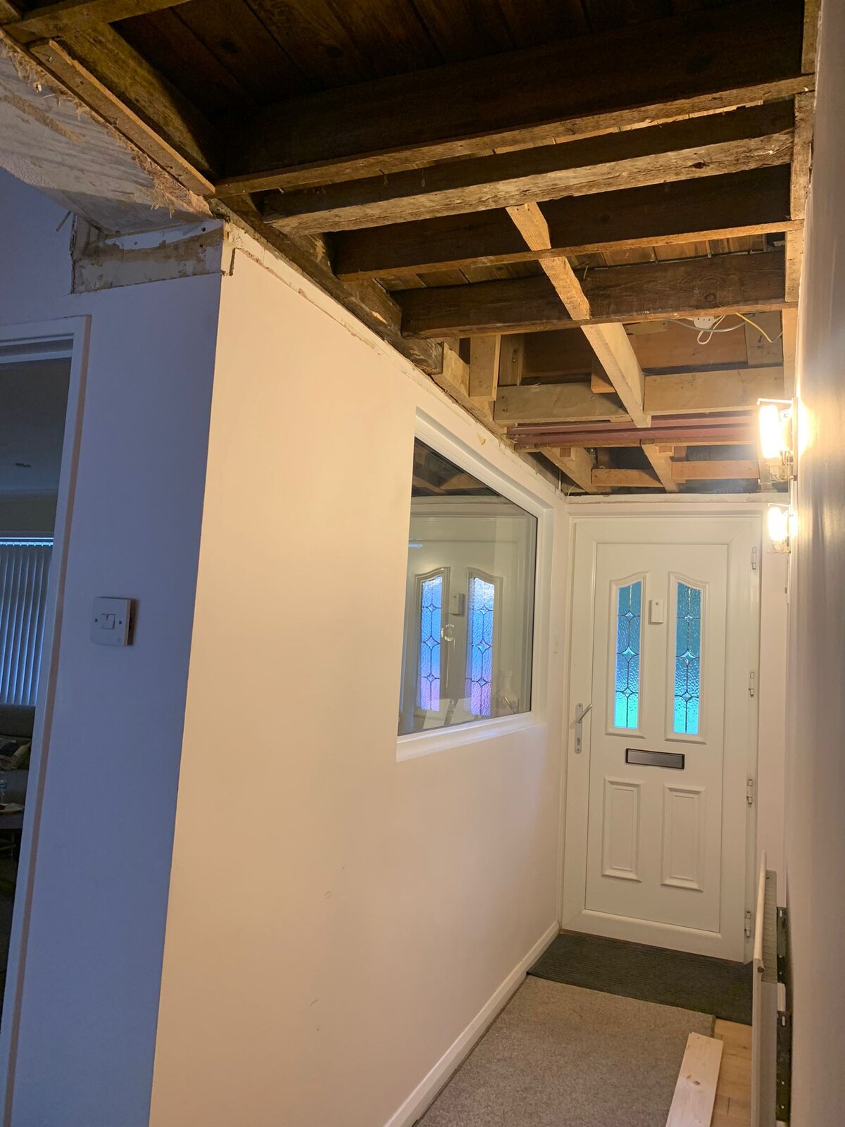

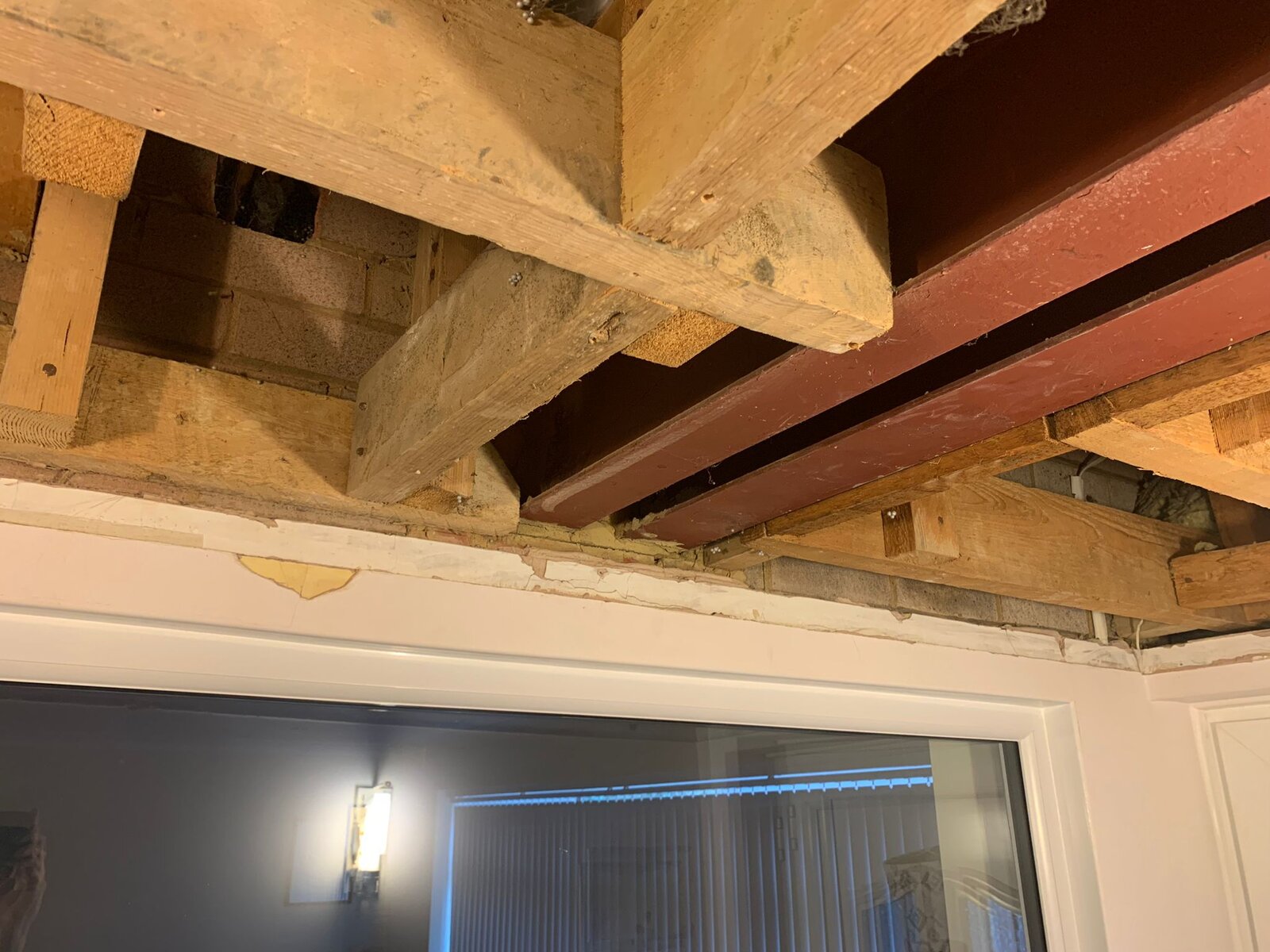

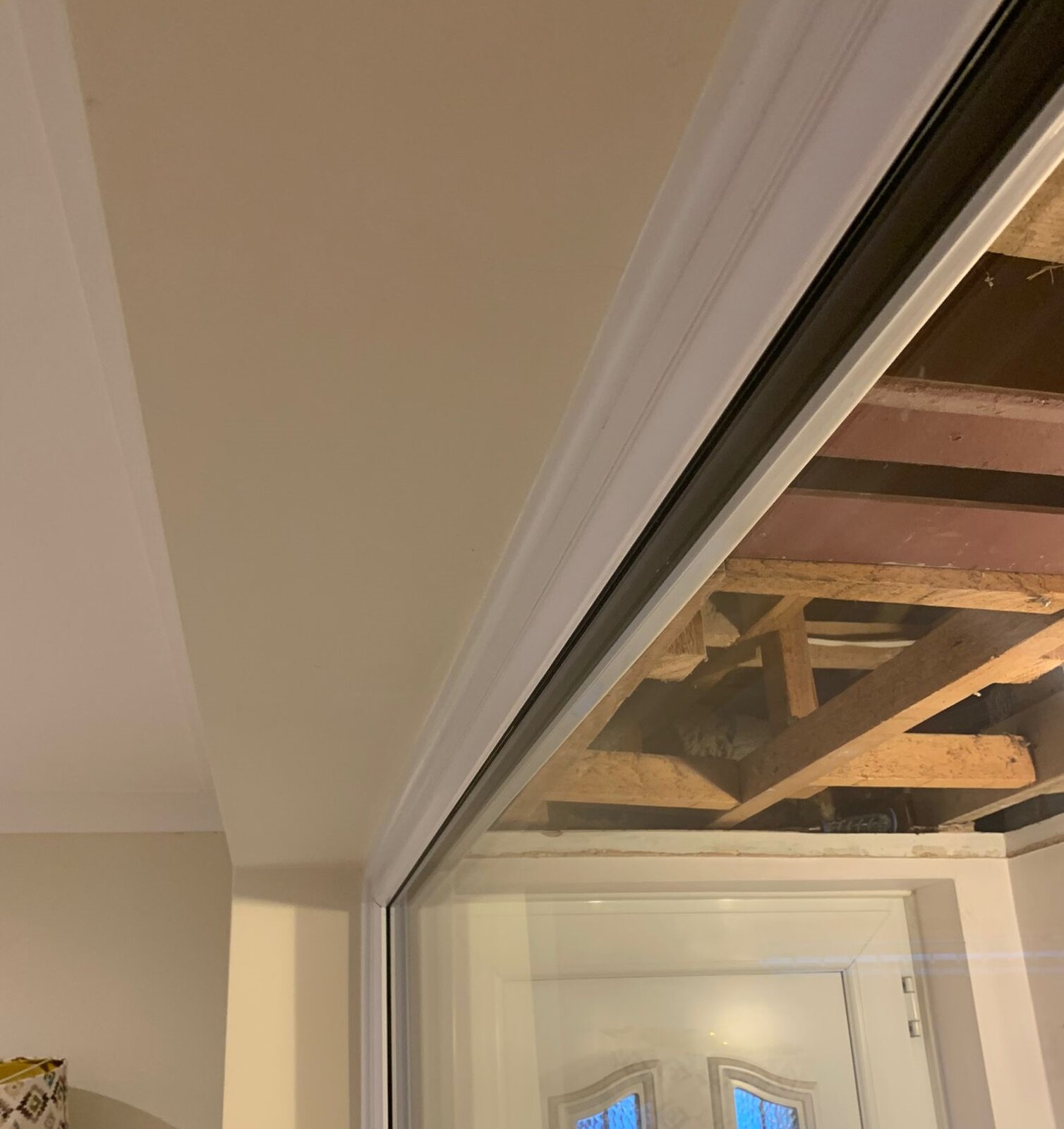

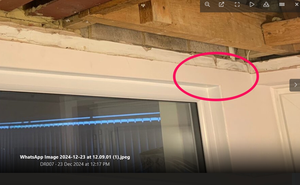

Had to strip down cieling and noticed that the RSJ crossing over from the garage wall into the house rests over an internal window!
Above the window all I could see is bricks, I'm guessing there is a lintel of some sort but even so would this be sufficent to support the weight of the floor above?
The UPVC frame has a very slight bend roughly just left of the RSJ. I really do hope I'm worrying about nothing.

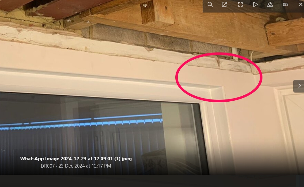

Do the beams not carry on going and span onto the wall on the LHS of the room in the first pic? You could do some further investigation in the circled area to see if there's a lintel or something.

The house was extended above the garage in the 80s.
The two beams running size by side (one for each leaf) stop above the window and do not extend any further.
I know this from having previously had the floorboards up in the adjacent upstairs room.
This used to be an external wall, and so is double skin with a breeze block inner leaf/brick outer leaf.

- Minor sag roughly in the centre of the UPVC frame (unnoticeable to others).

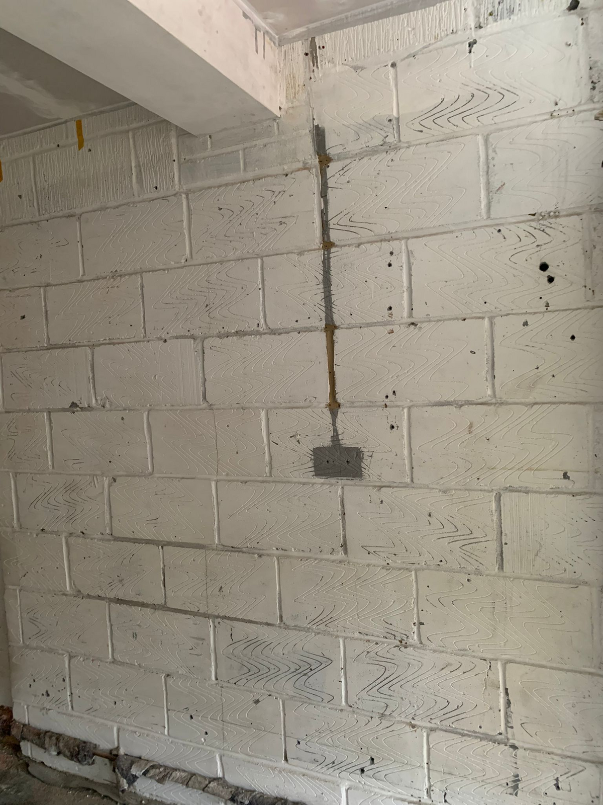

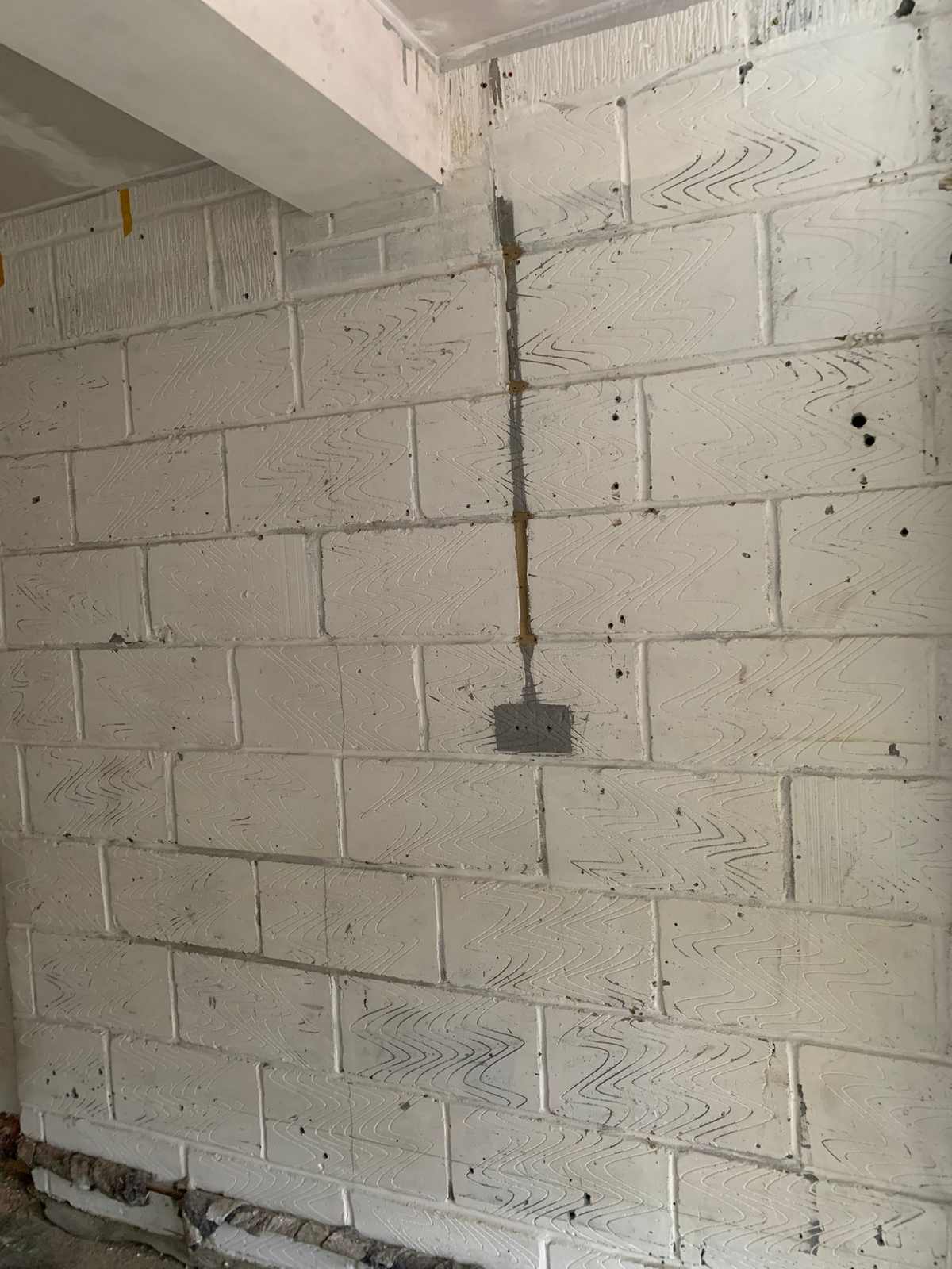

- The wall opposite the window is single skin breeze block and has 1mm vertical cracks top to bottom directly under the RSJ.
The beam extends past this wall to the garage external wall which is double skin. There are no cracks on the external garage wall.

Do the beams sit on the right hand wall from the first photo? I suspect they are cantilevered out and over to the internal window. This is far from ideal but the fix could be a post or bricking up some or all of the internal window.
This may be one for a structural engineer to come and advise. Unfortunately this is one of those 'once you know you can't unknow it'.

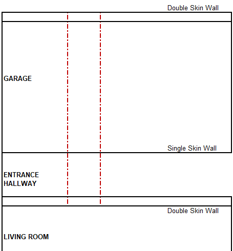

Yes, the beam sits on 3 walls.
External garage wall, internal garage wall/hallway wall (single skin with vertical cracks) and ends at the double skin wall over the window.
Thanks for the perspective on cantilever. The original extension ofcourse didn't have this issue but now that its been introduced, If I want to keep the window I could support the beam from inside the garage which would also cause minimum distruption.

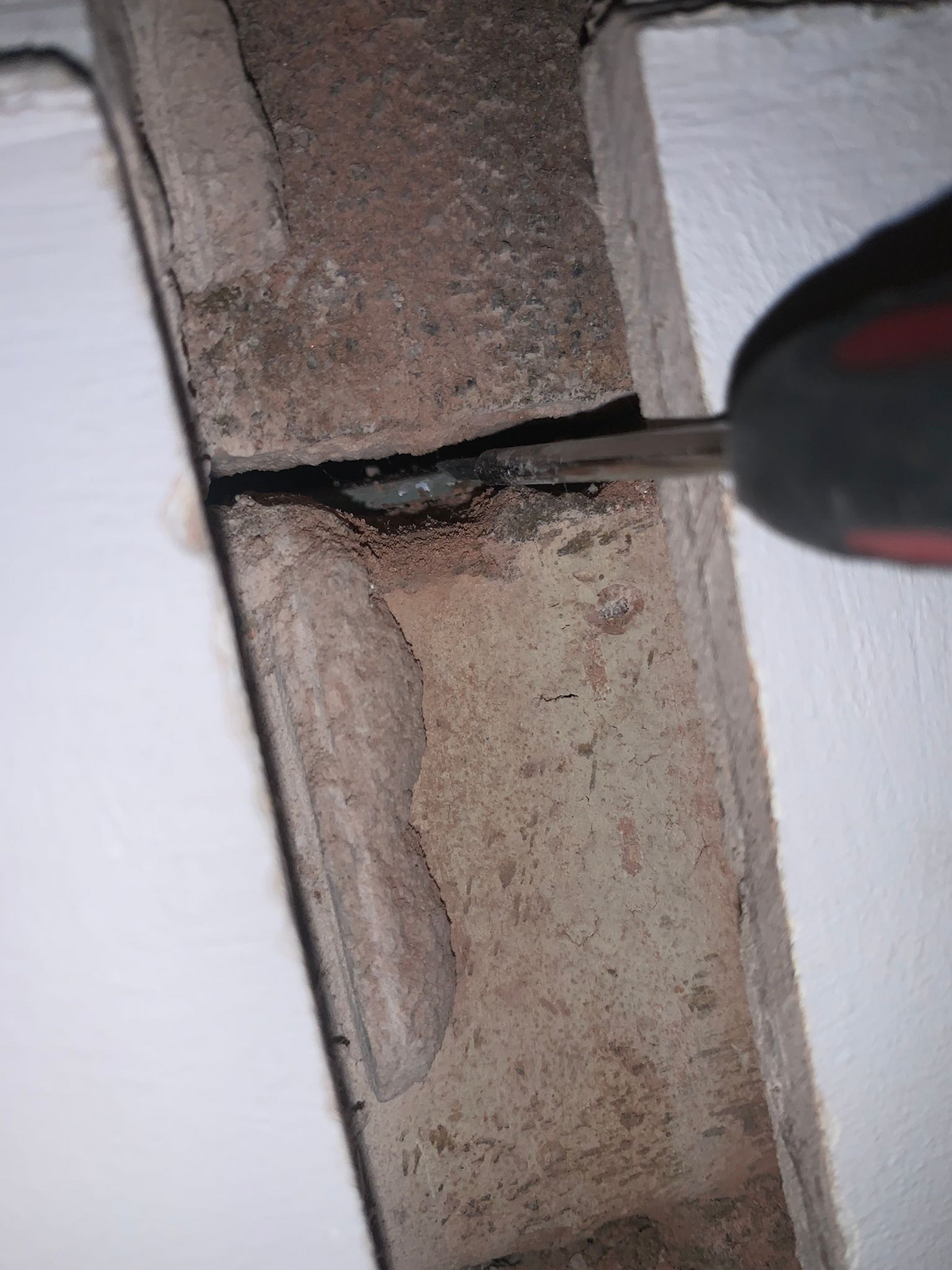

So I've done a bit more digging, chased up to the face of the brick and found what I believe is the lintel.
Its a 2mm thick, the pointing around was terrible and I think thats as far as i'm comfortable investigating before a pro steps in.
Would this suggest its a catnic lintel and not suitable to carry the point load of the beams or is there not enough in the photo to go by?
