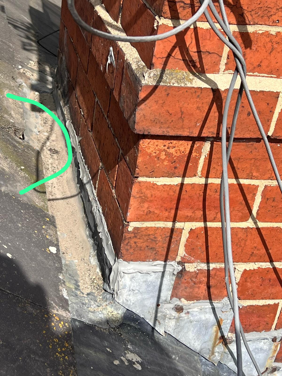

My sons terrace house has a chimney mid roof pitch. It has a bonding gutter between his and the neighbours house which runs from the ridge, abutting the chimney back. The chimney has a back gutter fitted but the bonding gutter continues below this. Am I missing something or is this a ridiculous design - assuming it's been like it some time as the house is victorian. Either way, water leaking into the converted loft during the recent rains. Any advice welcome? The picture shows the bonding gutter in relation to the back gutter.

Deleting them may offer you the most reliable way out of this problem

I've always felt that a horizontal gutter behind a chimney stack is a poor detail. If I was keeping the stack I'd do a small pitch with valley either side, ballache as it is.

My OP suggested it was a ridiculous design!! A fix/solution might be a ballache, but stack removal and retile ain't a days job for anyone. Thanks for your input
