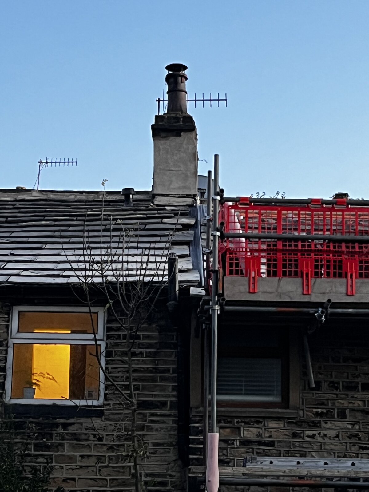

Ok an update with pics: the bonding gutter is getting put in and on our (left) side there seems to be great big holes, whilst on theirs the stones are flush to the gutter.
Granted the roof was a bit undulating before, all the stone coverage was still fine and there weren’t any gaps at all.
Any thoughts ? I feel like we should be asking them to return things to how they were - but I heard angle grinders today. I have a feeling they’ve taken the stones crossing the party wall and cut them to fit the neighbours.
Do I have rights to make them reposition the gutters on their side?

OP,
Is this happening on your front & rear roof planes?
Any sagging could have been easily remedied once the stones were off.
There's no need for any Bonding gutters - as above, it would have been a simple matter to pick up the gauge and tile through.
If you go in your loft you can check the top of your party wall has not been disturbed?
Your call but you have every right to make the roofers make it as it was - to reinstate.
Have you given the roofers or neighbour's any kind of permissions for anything?

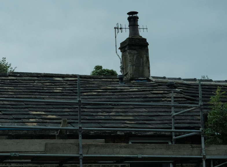

Hi @ree thanks for the info. It’s both front and back, and both ends of their part of the terrace roof - effectively slicing up a stone roof of three houses. Original roof section looked like this (a bit wobbly but it’s very old, this pic from when we had our roof done - theirs is on the right of the scaffold):
No major signs of disturbance on the party wall, then again we’ve only just had our roof done a month ago :( I think the felt may have been taken up and replaced.

Your old pic shows a hump at the party wall but thats quite common - it could have been taken care of first when the flags were off the roof on your new roof - & then when the roofers took the neighbour's flags off.
