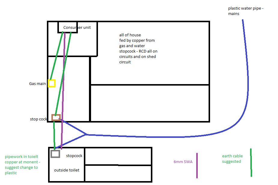

I am having a full re-wire.
I have all copper pipework inside the house.
I understand I need an earth connection to the water and gas mains. All of my circuits will have RCD so I udnerstand the copper pipes don't need to be earthed.
I also have an outside shed which as 3 rooms - one of which is a toilet. I want to get lights and sockets to the shed.
The main SWA cable from the house to the shed enters the toielt and so the electrician has said we will need to earth it.
He is talking about extending the (yet to be fitted) earth wire fro mthe house ot the toilet. Whilst this is possible (as my patio has not gone down yet) - it will cause additional work like digging the outside floor up again and so on.
Now in the toilet the copper pipe comes out of the floor and feeds the toielt cistern and an 'outside tap' (which is inside the toilet).
If I was to cut the copper pipe at ground level and replace it with plastic would this remove the need for earthing? There woudl be next to no chance of anyone being able to touch copper in the toielt them as it would be in a very inaccessaible location in the corner than no one would ever need to get near.
The shed is fed by the blue water pipe and then coverts to copper somewhere underground - so there is no direct copper link back to the main house.

How far is the shed from the house? What size of SWA are you using?
Is the pipe going into the shed copper or plastic? If it's plastic you don't need to bond.
Maybe the attached pic helps
BLUE mains water pipe goes to the garden where it splits to toielt and house stopcock
Both stopcocks are brass and then have copper pipe
My house currently has no plastic pipe and the shed has no plastic pipework
The SWA is 6mm
The pci does not show all the standard 15mm and 22mm copper pipework.
BLUE mains water pipe goes to the garden where it splits to toielt and house stopcock ... Both stopcocks are brass and then have copper pipe ... My house currently has no plastic pipe and the shed has no plastic pipework
If no metal pipe enters either house or shed from outside (i.e. underground), then there is no need for any bonding - indeed, there would be nothing to bond. Metal pipework wholly within the house, or wholly within the shed, does not need main bonding (but may possibly need 'supplementary bonding' within a bathroom).

Well my water is blue pipe and my gas is yellow plastic pipe - both of these were put in fairly recently - last 20 years I think
Is supplementary bonding required because pipes used to be metal?
I will raise it with my electrician as he may have assuemd its all metal.
I stand to be corrected here but
In most cases blue pipe coming into a property will be the water service and will be PVC, so no bonding necessary.
For gas, the pipe is yellow, but I believe that the pipe is always metal but with a yellow plastic serve on the outside. So bonding is always necessary. Can anyone confirm my belief?
I stand to be corrected here but ... In most cases blue pipe coming into a property will be the water service and will be PVC, so no bonding necessary. For gas, the pipe is yellow, but I believe that the pipe is always metal but with a yellow plastic serve on the outside. So bonding is always necessary. Can anyone confirm my belief?
Yes, I think so. My understanding is that it is not permitted for any gas pipework (including the incoming service) within a domestic property (possibly/probably wider than that) to be plastic - so, as you say, if it appears to be yellow plastic, there will (should!!) be metal underneath the covering.
Kind Regards, John
No. Supplementary bonding is no longer ever required anywhere other than in bathrooms, and if the bathroom circuits are RCD-protected, supplementary bonding will not usually be required even there.
