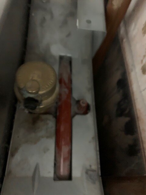

my bosch 28si has started making a rattling noise and it's driving the wife nuts i have found out where the noise is coming from its from the top of the boiler at the back, there is what looks like a copper pipe with some kind of brass valve attached to it and that part feels loose and it's vibrating off metal surround ,if i wedge something between the two parts it stops.
i know it's not ideal wedging something in there but it was just to check if that would stop the noise, i could call out british gas as i have a repair contract with them but i have had problems with them before ,they will say that noises are not covered and tell me there are no longer parts made for my boiler etc
any ideas please.

That is an automatic air vent, if wedging something in there stops the noise , you wont damage anything
