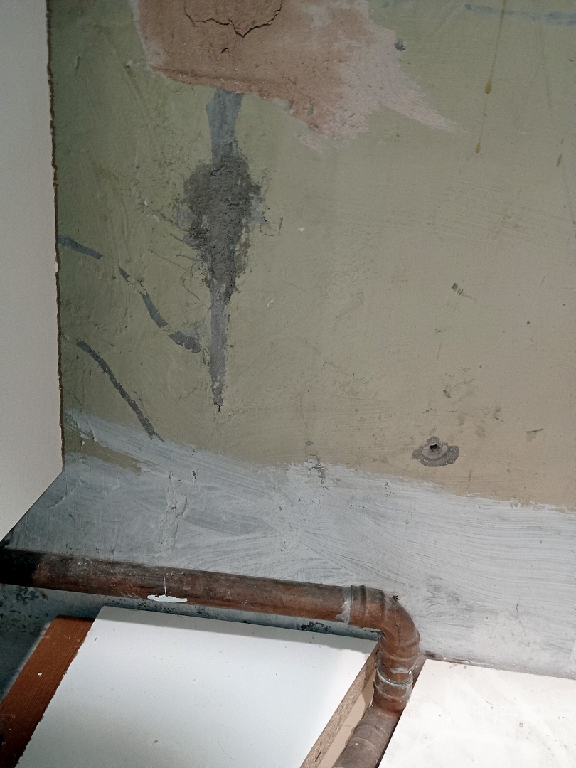

So I pretty much stripped a lot of it down. Some of the clips were tricky and you tube videos not as helpful as usual. So I took the top off, first, then the side. The plastic inlet and waste tube cannister was coming off quite well which looked blocked as did the float switch along the bottom. Had a lot of trouble getting the tubes off but managed to. Then there was an electrical connecter in a different position to the one in the video. I just couldn't get it off and then it got quite wet so I gave up basically! Got it picked up by the bin men (well actually, the rag and bone men who come round before!) rather too hastily. Because it appears that was about the only model that can fit in the space. This is because there is a gas pipe 7cm from the back wall and 9cm above the floor. (don't ask!) which the Bosch recess went over. Now I can't find any of the cheapos with recesses that are either high enough or deep enough to clear it! One will be high enough but not deep enough and others the opposite. So maybe I'll have to get the gas pipes moved back a bit. That would require a gas safe gas fitter and I wonder how much that would cost? {Pic attached). It's not so much the cost of the Bosch mre the principle that I don't want Wifi in a bloody dishwasher.
