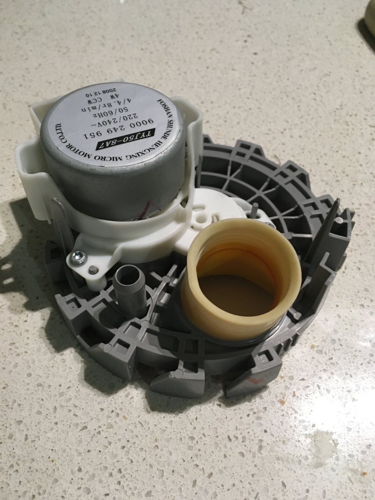

Hi, I have Bosch with the same issue where the water is only going to the upper spray arm. I have removed what I believe is the instantaneous water heater (part 0450 in parts diagram http://www.bosch-home.com/us/store/getAllImagesPDF?vibki=SMU68M05AU/01 ). There is a part 0441 which the diagram states is the 'Water Switch Motor'. Is this the 'Alternating Flow Mechanism' mentioned above that I should be replacing? Any help would be appreciated.
From the diagram it would seem your model is different to that described above, but these diagrams are not always very clear.
Post a photo of part 0441 to confirm, though the description would imply that is the correct part.
Have you done any other checks, starter motor, circulation pump, turbine, clean pipes etc..
Thanks for your reply. The dishwasher works perfectly in washing the dishes in the top tray. I have removed the bottom spray arm and thoroughly cleaned it out, and pulled out the filters at the bottom also. I'm not sure how to do the other checks you mentioned but given it works perfectly in the top tray are these required?
I haven't yet pulled out the water switch motor and will unlikely get a chance to do so for a few days. I'll post a picture once I've done it.
OK in that case I would have to agree that the fault lies with the switch motor.
Hi Yardie, I've fitted the part now and is working good as new. I ended up buying the Alternating Water distributor. Potentially I only needed the motor but I wasn't sure whether the fault was in the motor or the mechanism and this part covered both. I took me a couple of hours to do but could now do it in 30 minutes once you know what panel to take off and how to get to it.
Thanks for your help.
No problem, glad to be of some help!
Could you post a photo of the part for future reference, it will help others in future I'm sure.
A picture of the part is attached. The motor sits on top and is held in by three screws and can be purchased separately if this is the issue. Similarly you can also just purchase the mechanism. The two combined cost me $A110 delivered which included a new hose clamp that needs to be replaced.
