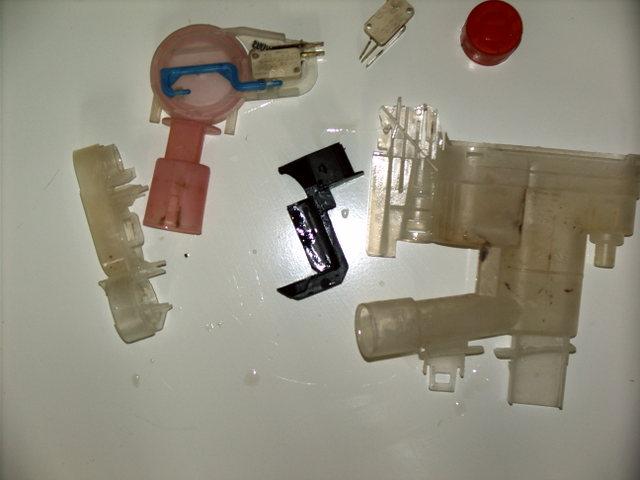

remove left side panel and you will see what i mean. matrix is the clear plastic on the side
I have both sides off, The matrix (I assume to be the big plastic tank thing with all the channels in it that the water fills up) has a compartment at the bottom in the middle with min/max lines on it - this is full of what looks like very fine orange sand. Is this the water softener, or is this the blockage do you think ?

try this the orange stuff should not be there its crud ,it needs to be clean
That's great, thanks - all I need to do now is figure out a way of getting to those parts, and getting them out to clean them !!
rocks, I'm making progress with it, it's not much like the one in your pics, but they have helped a lot thanks.
Theres a float in the matrix in one of the lower chambers that pushes a peice of blue plastic up to the vicinity of the bottom of the salt hatch, any idea what that is for ?
