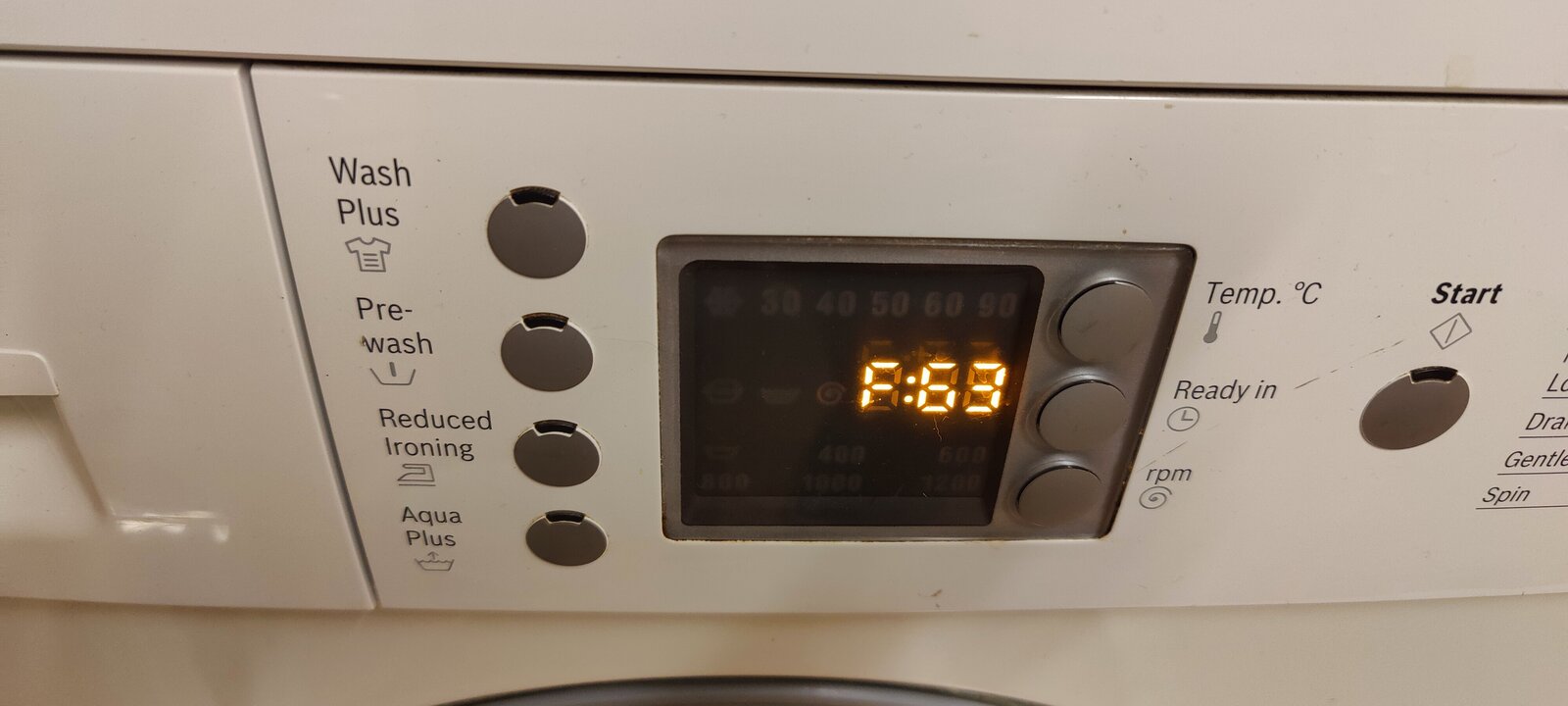

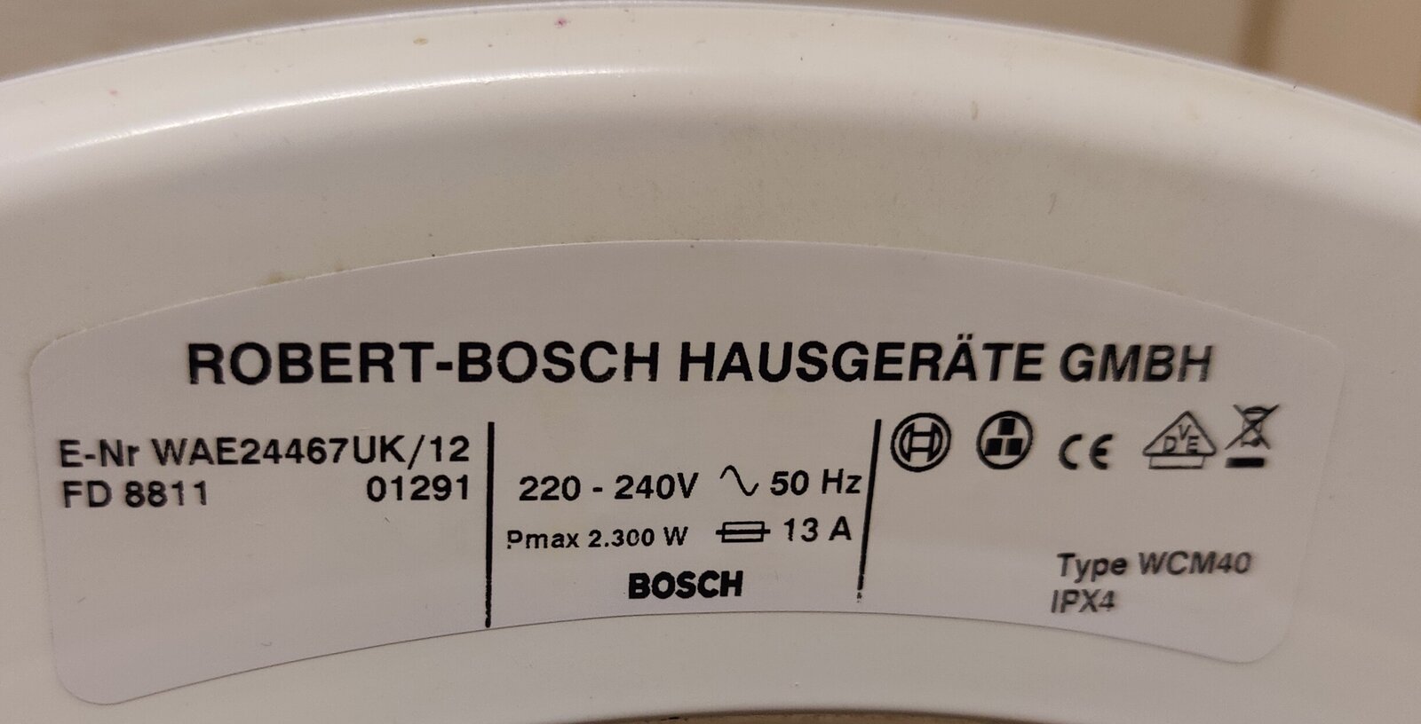

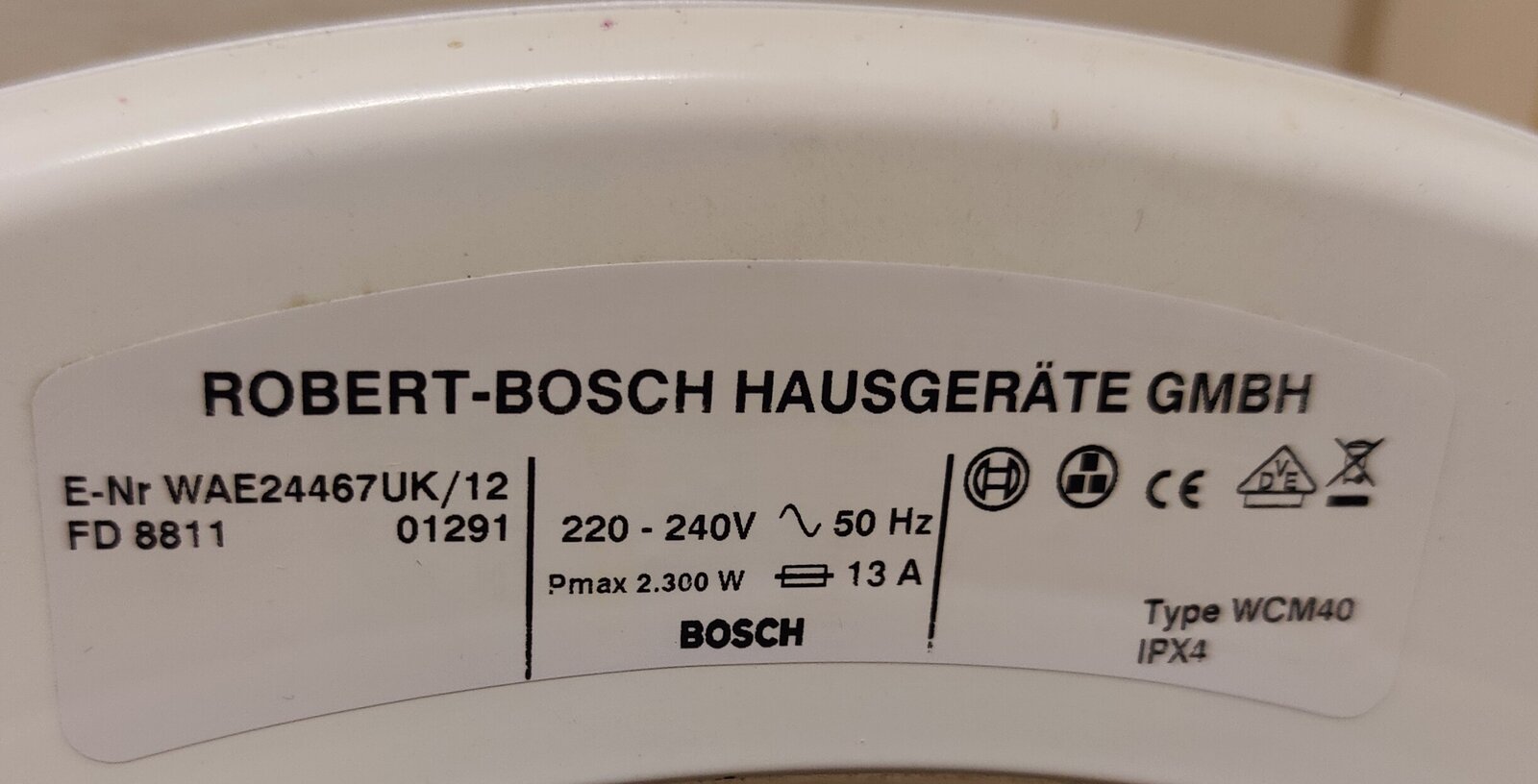

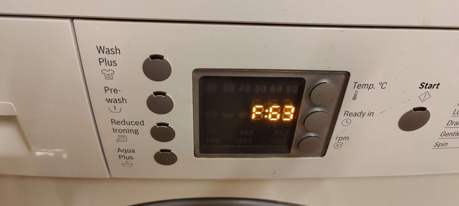

Hi All, had my washing machine for some time- served me well. So trying to pay it back and get it back to life.
I was washing a normal load this morning and then it stopped with F21 error and unlocked the door. Clothes have not been through the spin cycle - so still soaked.
I tried the reset procedure - turning the selector from OFF to 6 o'clock, then pressing and holding the "RPM" button, but nothing changed.
I opened the filter in the bottom left and drained some water - more than usual when cleaning the filter. when I powered it on - now it shows a flashing F63 error. Tried the above reset procedure, but still no luck.
How can I troubleshoot this?
What do these errors mean? What is normally the cause other than age?
