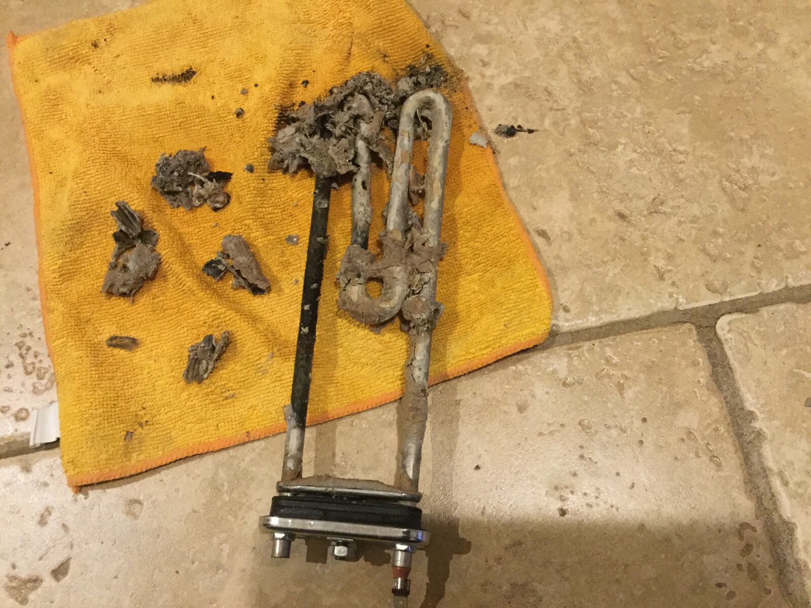

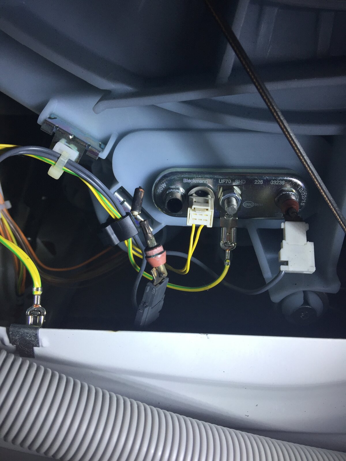

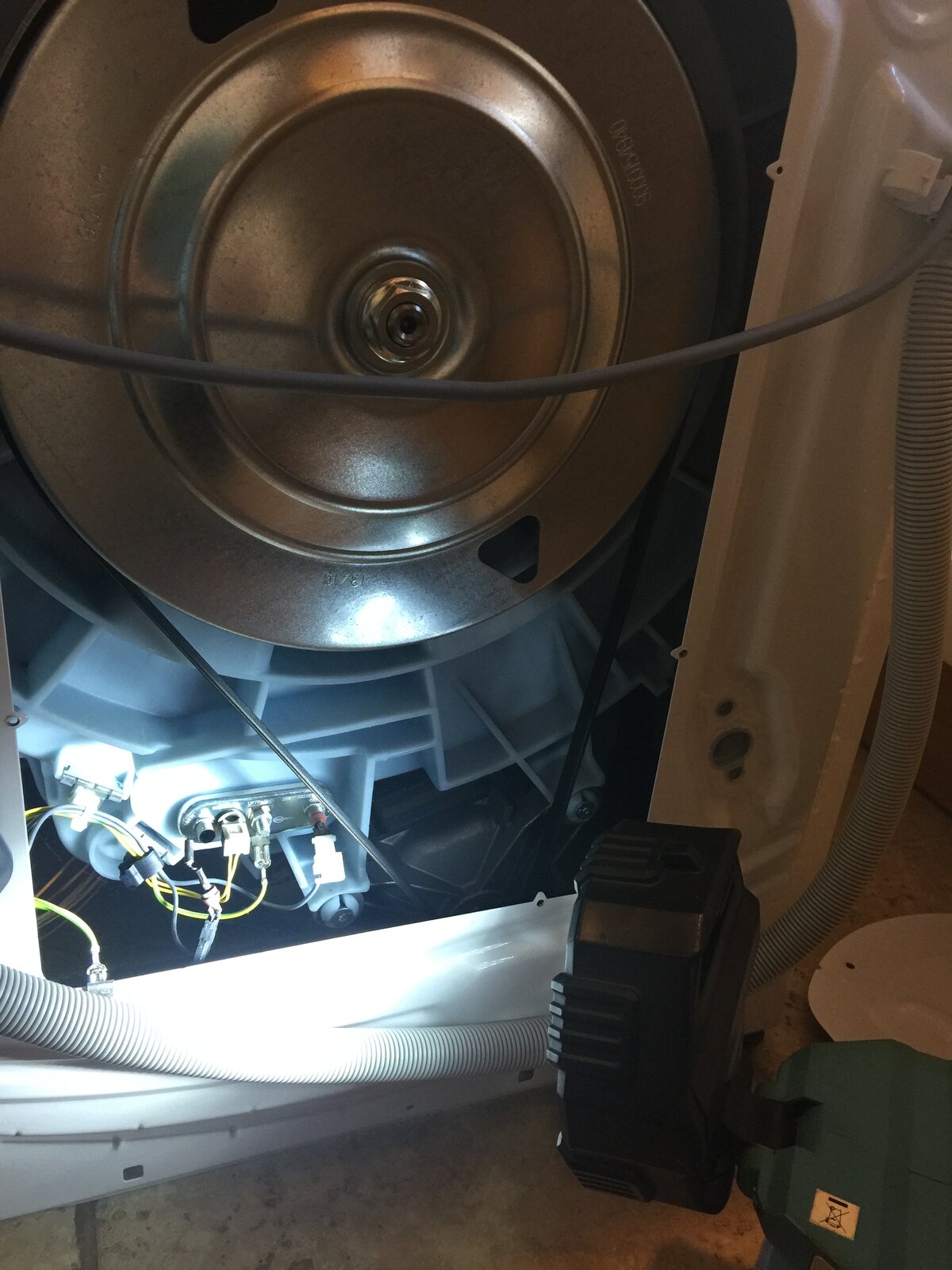

Anyway, as it was pulled out and ready to be ditched, I thought I'd just take the back off - just out of curiosity and was interested to see the following - best described in photos - and I wondered if anyone knows what it is and whether its worth thinking about getting it repaired rather than buy new. Obviously I know a call out will cost me minimum £60, plus parts, and any other labour - so could be £100 - £200, but even so.
So, theres this thing on the left which appears to have blown out - which was presumably the 'crash' I heard. Intrigues me why the electrics didn't blow and more to the point, that the machine kept working.

That is the end of the element.
You could replace the element if everything else is fine.

Oh! That’s really interesting, thank you both. So it probably didn’t heat up - didn’t notice as the load that was in when it started smoking had only just gone in anyway.

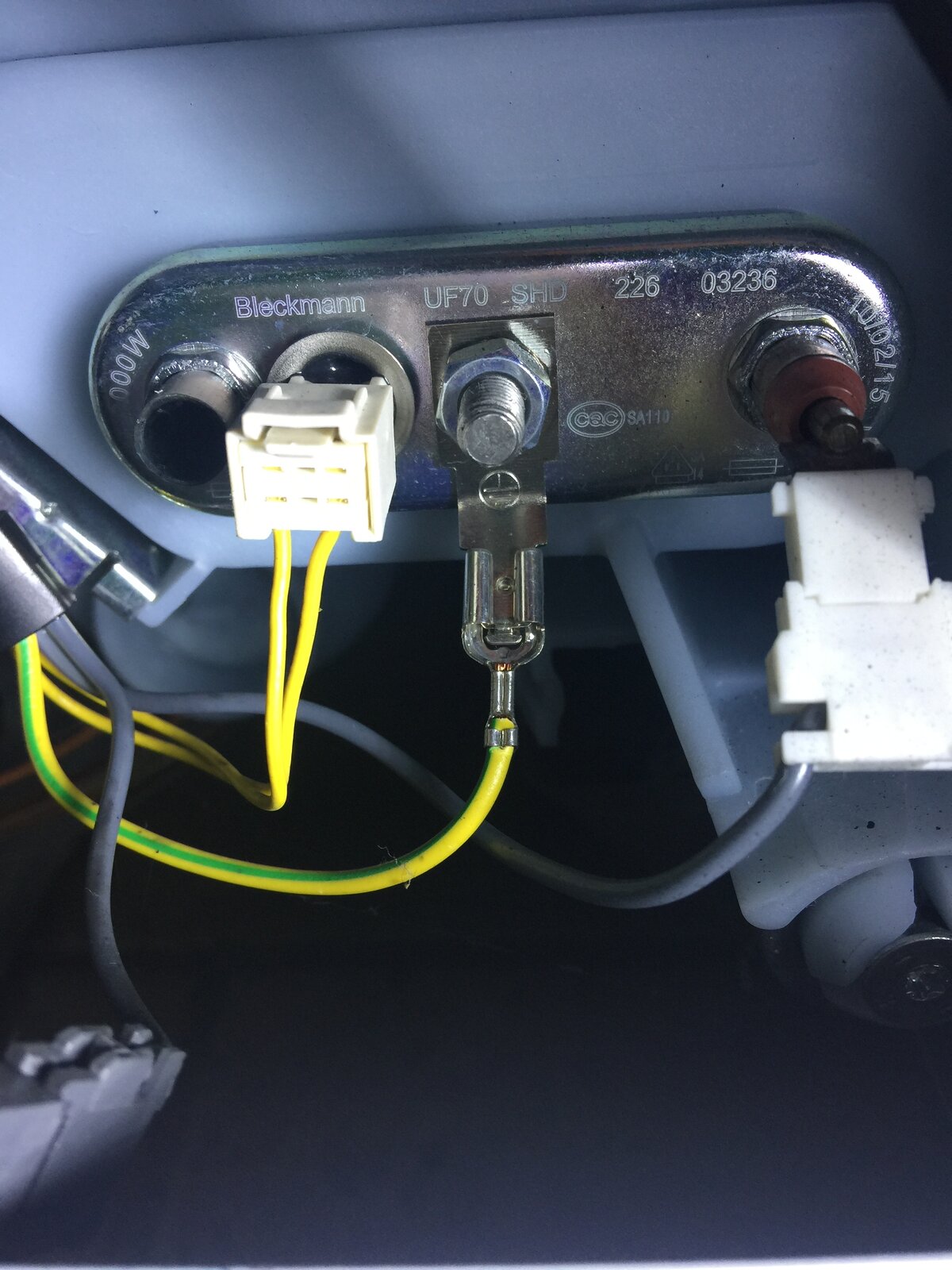

I was a bit concerned that the thing that that ‘solenoid’ (?) pushes into would be damaged internally too - I can’t get all that lose wire bit to go back in the hole - seems too much of it to go in. ( wasn’t intending that as the solution obviously, just seeing if that’s where it went). Inside that ‘female’ it’s all black and gungy and stinks - i poked about with a cocktail stick.
I’ll go and undo that nut.

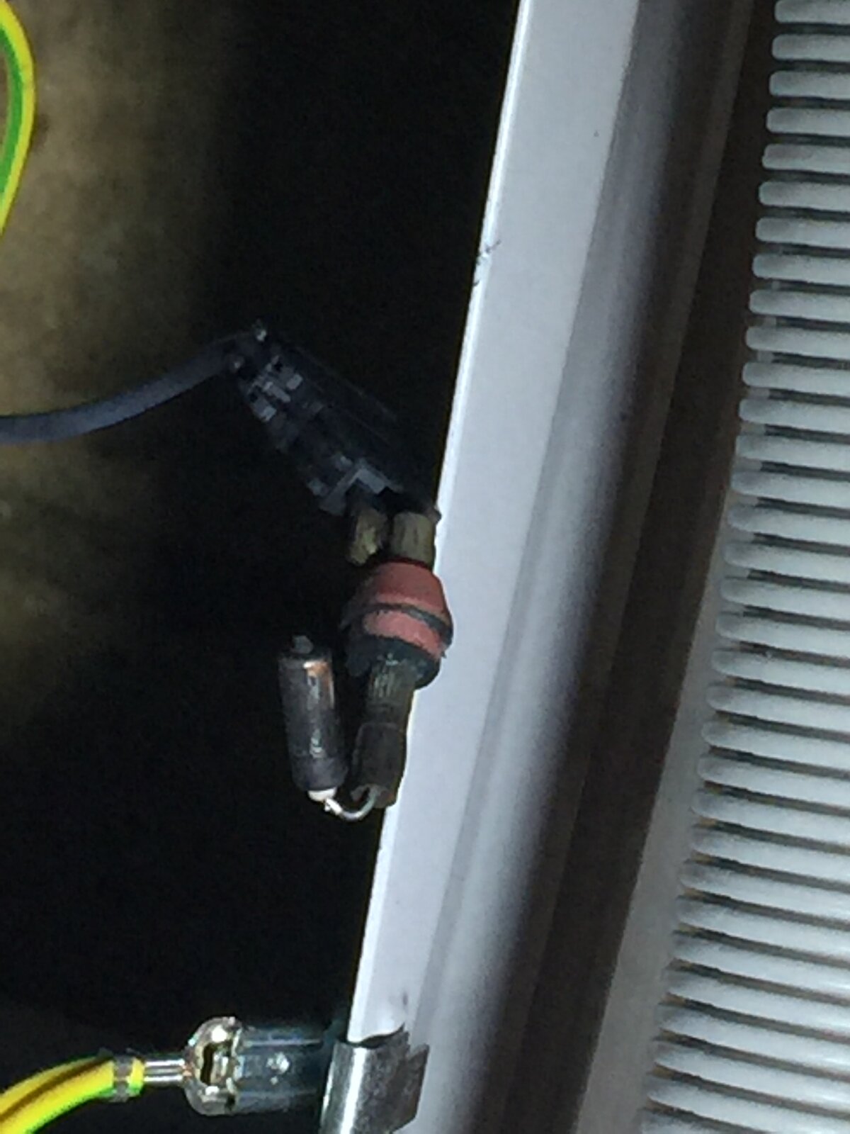

Wow Harry, that’s amazing. Yes, that’s exactly it. I’d just been fiddling around with it and only just now seen your post - and the video too. Fabulous. When I pulled off the 2nd from left connector a whole lot of water came out which has disappeared into the bowels of the machine so I hope I haven’t shorted out anything else.

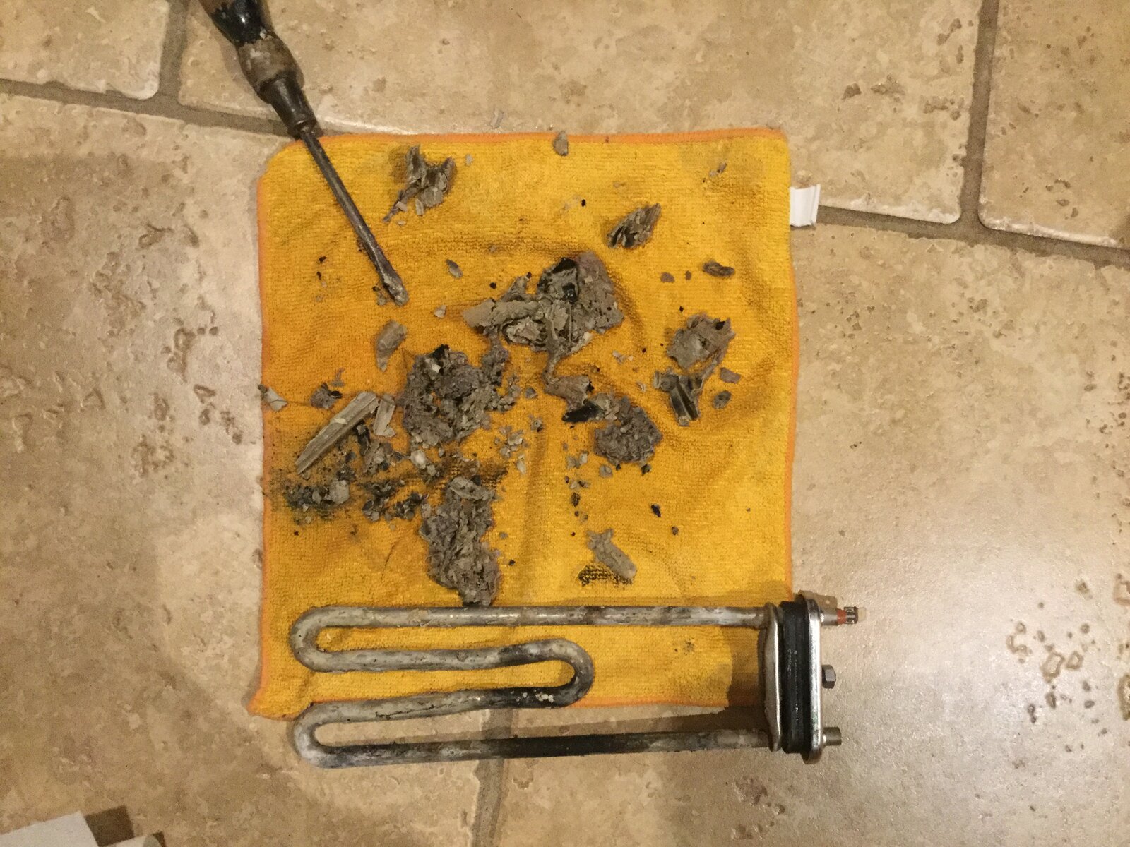

The bang was the element exploding. They are a copper or maybe alloy tube, with the element running down the centre, insulated from the outer tube. Outer tube becomes damaged, or they suffer wear and tear, water gets in and they explode. Because the tube/element is permanently below the water level, once the explode, water will be able to escape.
By the time your replacement element is delivered, the machine should be perfectly dry. Hopefully, your element exploding has not caused any further damage to the machine. Do check with the seller, that the element is the correct model of element for your model of machine.

I always use eSpares. They’re great at confirming parts. You’re video was ofcourse essential and invaluable - thankyou. ( albeit mine is in the back).

Can I ask a silly question - that hole in the end of the element, where water came out - is that how it works - that’s the water that goes in and gets heated up and then moves off into the washing machine? If so, ofcourse, there’s water there anyway then isn’t there so I won’t have done any harm. Ofcourse all my little connectors are soaking but as you say, they’ll be dry by the time the element arrives. Obviously, the side of the element that’s black is the side that blew.

No, there is not supposed to be any water inside the element at all, it is supposed to be sealed against water by the tubuler jacket. When water gets in, that's when they explode. It is supposed to work exactly like the element in your electric kettle - it sits at the bottom, heating all the water above it.

When putting the new element in, have a good look into the hole first to see if there's any clips etc. When I did mine, there was a metal open spring clip similar to a pipe clamp for copper plumbing, and this engaged with the end of the element so its not floating around loose in there. Easy to miss that when just sliding a new unit in, and I imagine it would melt plastic if it touched somewhere.
