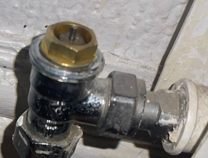

I thought this was going to be a really simple project, replace my existing TRV heads for a smart home TRV one - looks simple enough, unscrew and then screw on the new, they even supply mutlple adaptors to match various TRVs.
The radiators predate me - So not sure how old these TRVs are.
My first mistake (thinking it was simple)!
I removed the head of the TRV (which is a boss TRV) see pic - which after looking at the thread, seems to be a 26mm ?? Again, after looking seems non standard from the 30mm that seems typical (of course, when has a fitting ever been standard!) :)

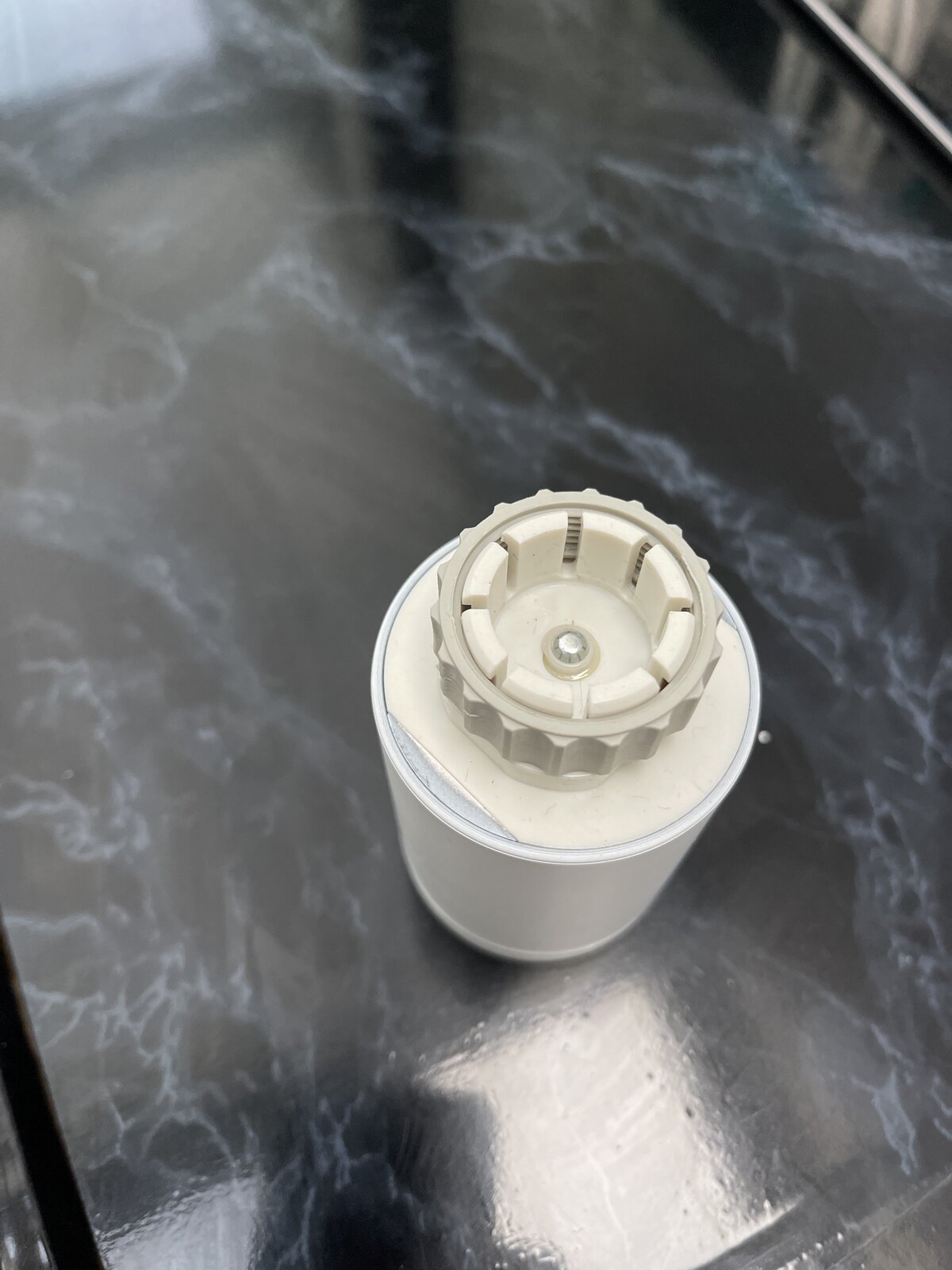

None of the adaptor work or fit (see pics of box) included with the Smart TRV
Anyone have any ideas (short of replacing the whole valves with new).

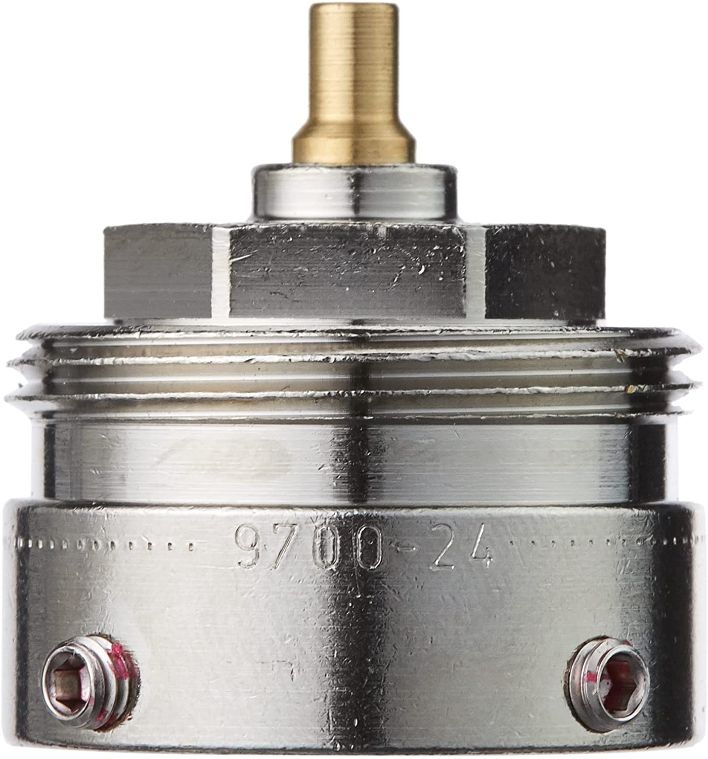

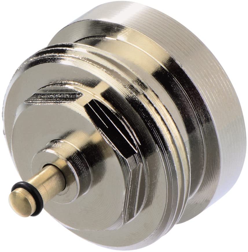

I've seen things like this on Amazon see pic - not sure if it works
Which seems like they would work... they just fit over the existing thread??

Found a solution - Just in case anyone ever searches this link for a fix ... This works fine, not the cheapest option but saves having to change the valves yourself
Got this from Amazon, just screws over the top
  • Allows the installation of electronic Ventilantrieben with M30 x 1.5 mm Thread to Heizungsventilen with M28 x 1.5 mm Thread
  • Assemble simply twist-no special tools required
