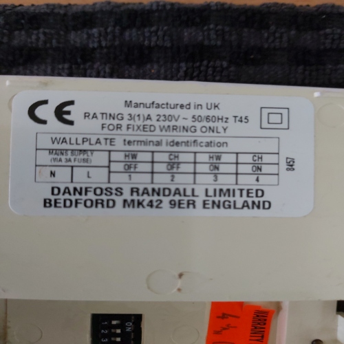

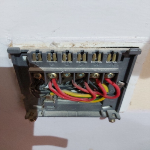

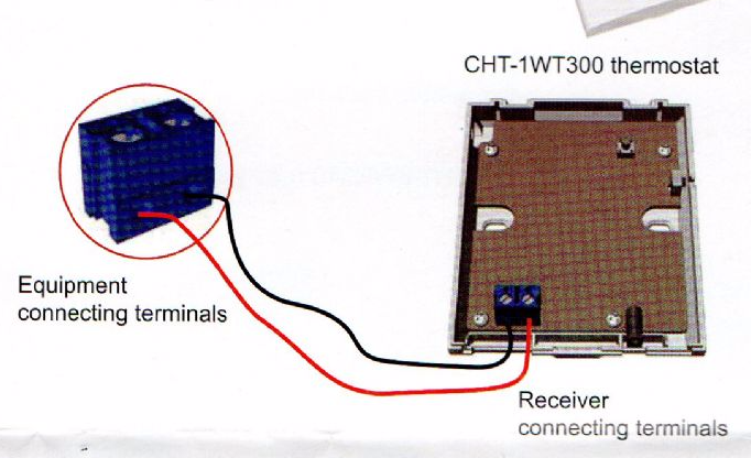

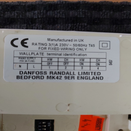

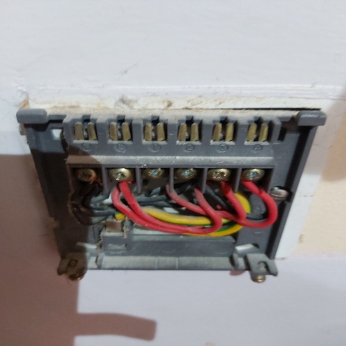

Hi
We got a Camray 5 Oil Boiler with a timer and I like to replace it with a remote room thermostat. I know the boiler needs to be on water and heating at the same time, so I just link my heating wire and hot water wire together, they are no 3 and 4 then I have left on the time on number 2 live and on number 1 neutral, as I only got an in at one end I assume for my heating on and hot water on of my receiver of the wireless thermostat and what do I put on the other one live or neutral (Which do not believe, but how can the timer work in the absence of a return feed wire)? first 2 pictures are of the old-timer

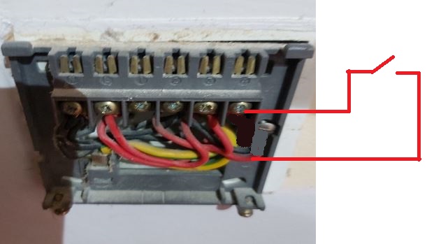

still need to sort the wiring so and i could put a manual switch in
A face on view of the backplate would help.
You could, but it would be easier to wire a room thermostat to the programmer as it is now and have a more flexible system, than reconfigure the programmer and add a manual switch and a thermostat.

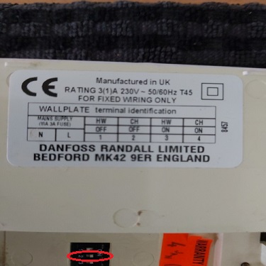

The switch No.2 just visible at the bottom of your photo highlighted here....
....appears to be set to 'gravity' mode, which means that the hot water will automatically come 'on' whenever the heating is selected to be 'on'
However, a room thermostat could be connected to it, that will just control the central heating. This is done by disconnecting the red wire from terminal 4 of the programmer (CH ON) and connecting it to a room thermostat, then the other thermostat wire goes back to the now vacant terminal 4.
Many thermostats are battery powered, so only need the two wires shown to connect them, others require a mains supply, and if so, that can connect to the programmer's N & L terminals.
Because of the limitations of your plumbing [Gravity circulation of hot water and only pumped central heating] it means that the hot water has to be 'on' before you can have heating. It is better therefore for all of the time control to be done by the Danfoss programmer where the 'gravity' mode will ensure that when the heating is set to come 'on', then the hot water automatically come 'on' too.
This means that ideally you should install a standard thermostat (only temperature control) and not a programmable thermostat (time and temperature control). Whilst you could install a programmable thermostat, it can be a pain as you will always have to manually make sure that when you want to have the heating on, the hot water is set to be 'on' at the same time.
