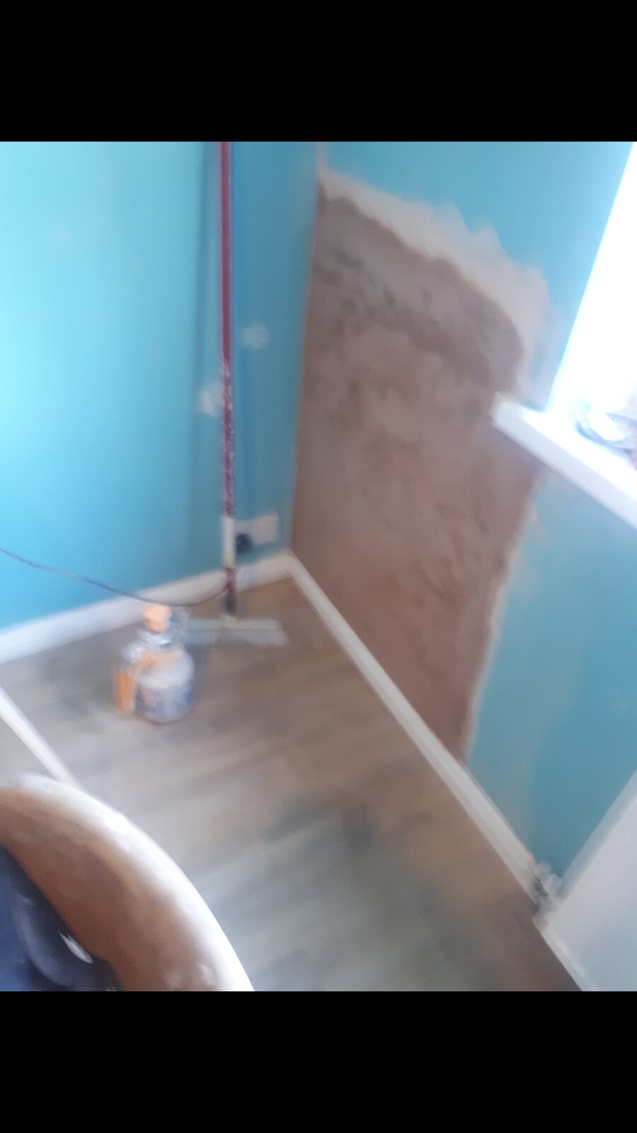

Let it firm up then cut it back slightly with the long edge of your trowel it dont have to be much heres something to look at this is a patch i done in my own house in about August i had a baxi heater taken out and central heating fitted so patched the hole you can see at the top where its dried out that is where the taper is and the dark is where the taper starts that is what you are aiming for
