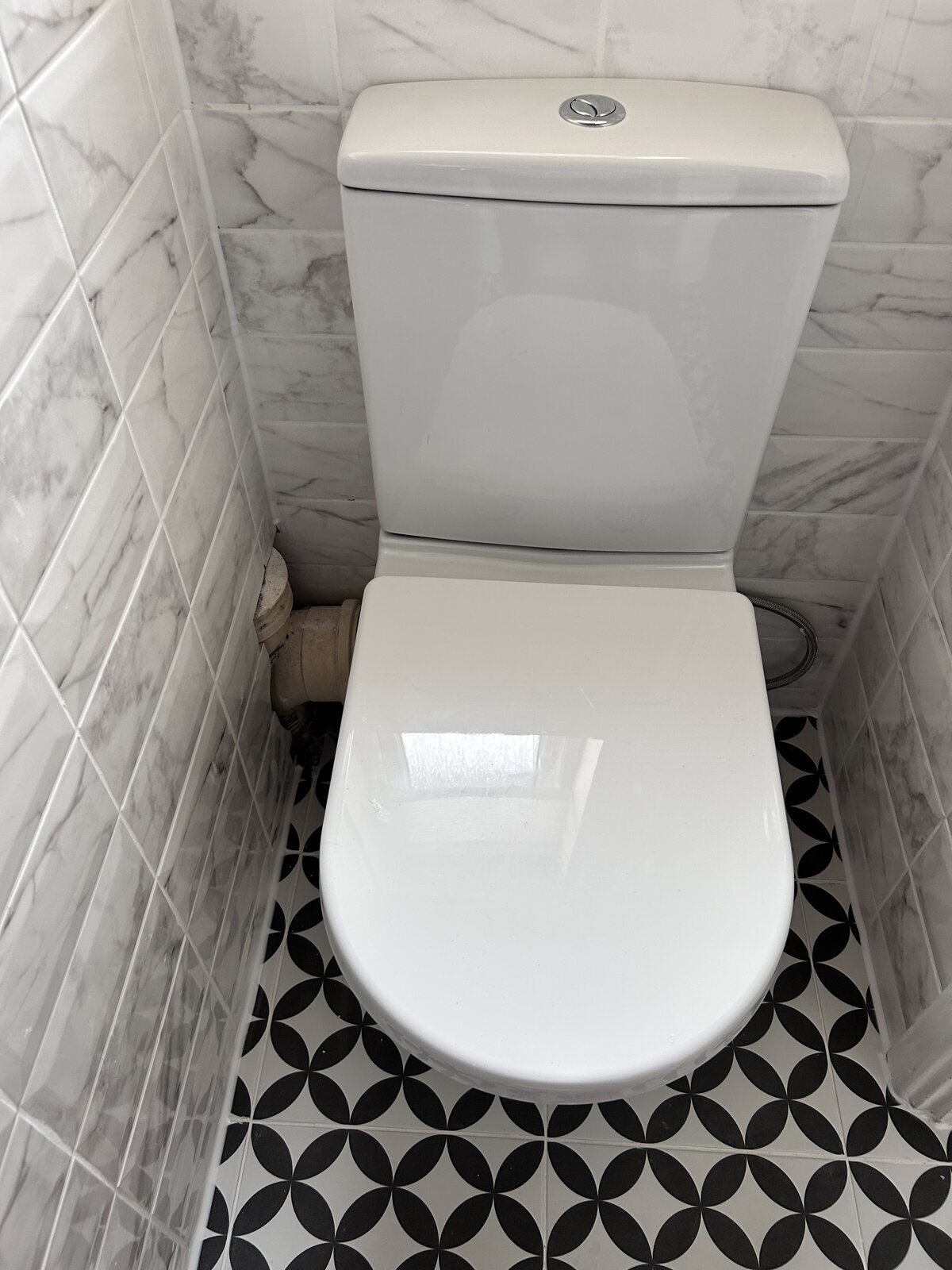

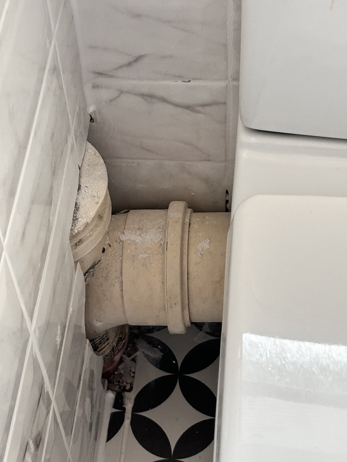

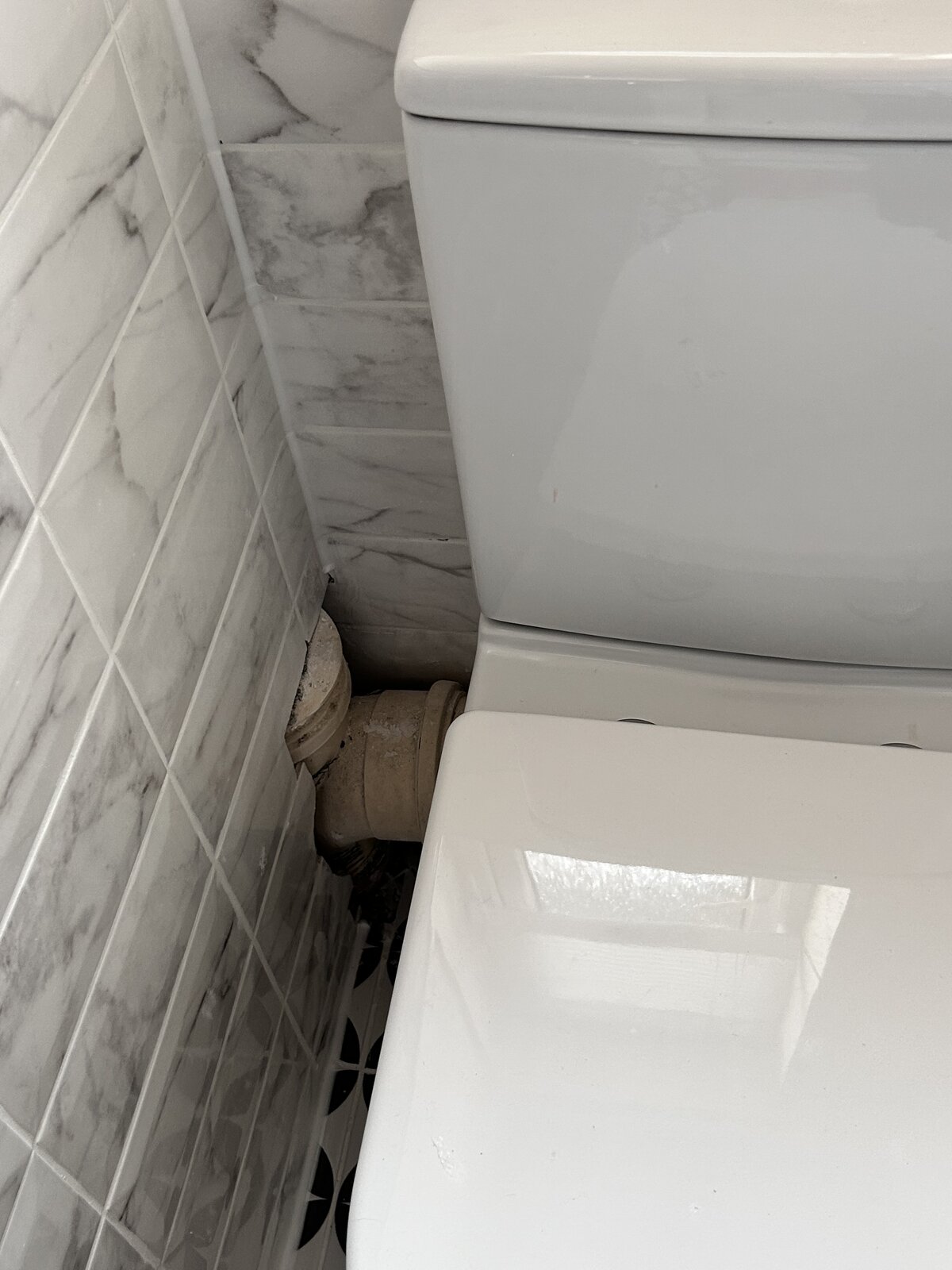

Is there an easy way to hide the pipe at the side of the toilet please? We are not the best at DIY

Quick easy option is Uvpc soffit / facia board in white .
Or is you have spare tiles box in with cement board and tile.
