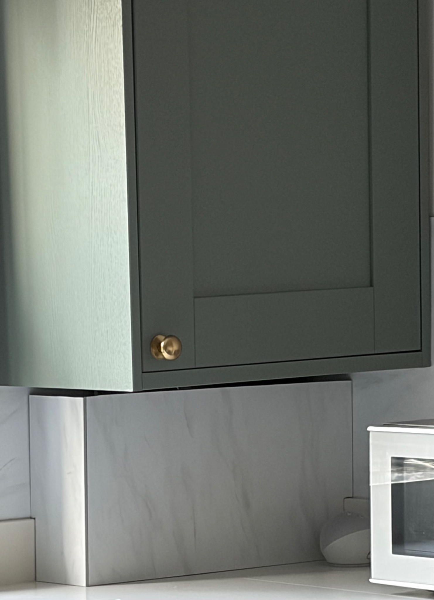

My builder has boxed in the pipes under the combi-boiler but left a big gap above the boxing. Is this really necessary?
No reason, but perhaps there wasn’t enough material?
Could have been a touch neater, but any builder /carpenter/kitchen fitter who understands the need to leave ready and unobstructed access under the boiler to valves, filling loop, condensate trap and for other service and repair procedures is a jewel.
The worst thing a visually perfect sealed/screwed/mastic'd and tiled-in box that needs to be smashed out whenever the boiler needs attention!
Should've gone up to the cabinet and left a few mm gap to easily remove it if needed.
I've always used magnets to hold the box in place.
