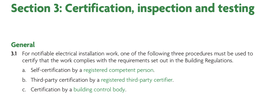

i.e a homeowner that did a basic domestic electrians course maybe 25 years ago but then went on to do a computer systems engineering degree at uni and followed that route instead who does his home electrics but still gets it checked and certified by an electrican and everything signed off by building control...

please read the section 3, you will find that these are the ONLY ways to achieve notification of the works that you envisage:
The section goes into the steps. I can't be @rsed to give you chapter and verse. There is no option for you to do the work and have some passing electrician to later "sign it off". Both the certification and notification process includes the condition that they are done by the electrician who did the work. If they do otherwise then its FRAUD.
I have to say that LABC really do not want you to take option C. They have more than enough to do without messing around with a tiny project like yours. You would need to raise a building notice (more than a couple of hundred quid) BEFORE WORK STARTS. They will want to inspect the works at many stages to confirm that the work that YOU do complies with BS7671 (got a copy?). And of course, you'll need to carry out all of the first and second fix tests (got a full set of calibrated test gear that covers all of the required tests? - I thought not.) Or LABC will engane the services of one of their sparks. Again, more££££
For Option B. In the unlikely event that you can find a willing 3rd party certifier, you still have to get him/her started with overseeing your work. You need to engage them again BEFORE WORK STARTS. Thats also added £££
The way ahead is option A. As already said. Get your competent and registered electrician on board now.
For those who wish to comply with the law, in terms of bureaucracy and cost-effectiveness, that is probably the appropriate advice.
However, in terms of realities, you seem to be assuming that someone who has paid their subscription to a trade body, ,undergone some pretty dubious 'assessments' and purchased the right books and insurance is necessarily a "competent and registered" person. Is that what you believe?
Thanks, yes that does sound a bit ridiculous that overqualified people can't do work in their own kitchen but someone who is potentially a bit useless but has done the right course can do. I guess for every x number of people that aren't qualified that do work themselves but are quite capable there will be y number that aren't really capable and also need to have a "caution hot" label on a cup of coffee to stop them burning themselves, i.e. many rules are there to cater for the lowest common denominator in our society to stop them harming themselves and others rather than because they really need to be applied to rest of us. I do actually have most of the test equipment although it's not calibrated and I already have an electrician that's happy to check my work and sign it off (he's a friend, used to be my housemate after uni) and has done so previously when I converted my garage into a habitable room some years ago. I've glanced at theiet website but only for specific things rather than religiously. So what's the situation when the electrician has an apprentice who does the work and then the electrician checks it? I had some work done about 3 years ago and the apprentice did most of it, isn't that fraud too if the electrician didn't actually do it himself? What's the difference between that and getting your own work checked by and with some guidance from an electrician friend? I think probably option B is actually fine for me as I understand it but I might look into option A to cert my own work, although I've no idea what becoming a "competent person" in this sense entails these days. Normally it just seems to mean paying a lot of money for a watered down course with a multiple choice exam at the end. Thanks for the info, it's been educational :)
As has been said and implied, what matters in the context we're discussing is that one is a member of one of the "Competent Persons Schemes" run by the trade bodies. As I said, their main interest seems to be that you pay their annual subscription, but they will undertake some (possibly fairly 'trivial') 'assessment' (and/or rely on {again possibly dubious} #qualifications) and may well require you to have copies of current versions of various documents/books and insurance, and maybe (I'm not sure) perhaps even appropriate calibrated test equipment.

That is not exactly the case and was not even before the alterations in England.
Anyone can do electrical work; it is just that for some work the local authority must be 'notified'.
