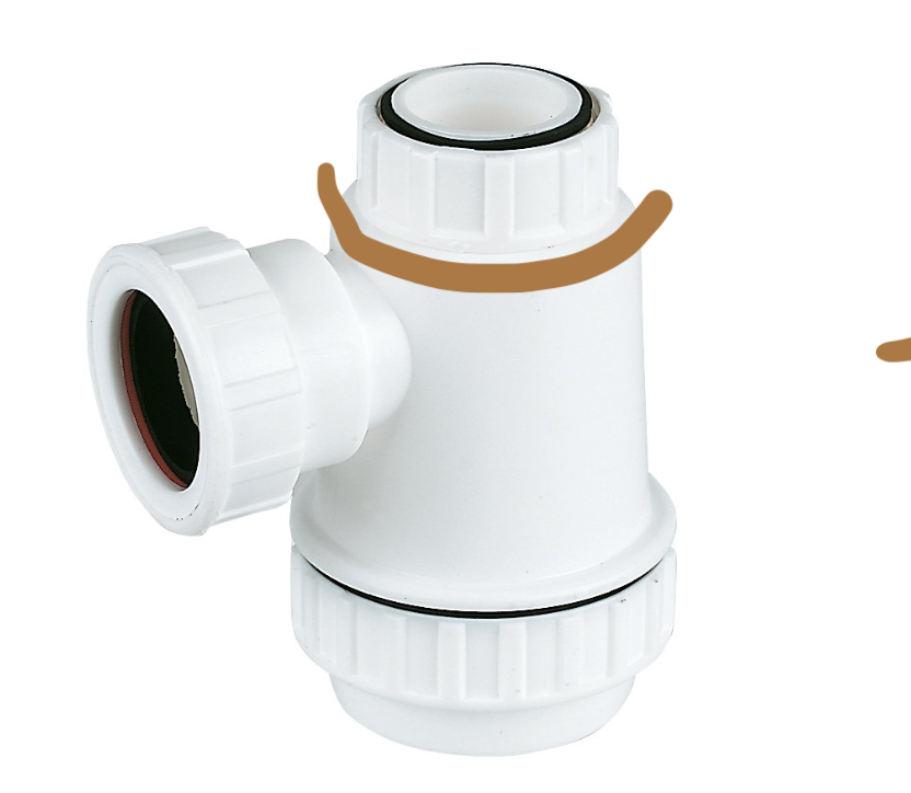

But the bugger still leaks (tiny bit). At my wits end with it, any ideas.
The leak is from the area marked on the pic in brown. By that I mean it's coming through the collar that screws upward onto the waste.
Thanks.
CG
Cheap trap? Some are known to leak... Try a McAlpine, better quality. Also check it's not coming from above, how have you sealed the waste into the basin?
Waste to basin is siliconed. Not from there- I have spent ages lying down and wiping dry and checking where the leak is. No leak on the threads of the waste. It is a Floplast cheapie from Screwfix.
I often wind ptfe tape around the rubber seals 2-3 times when the waste is problematic. Wont help the seal to the basin of course
