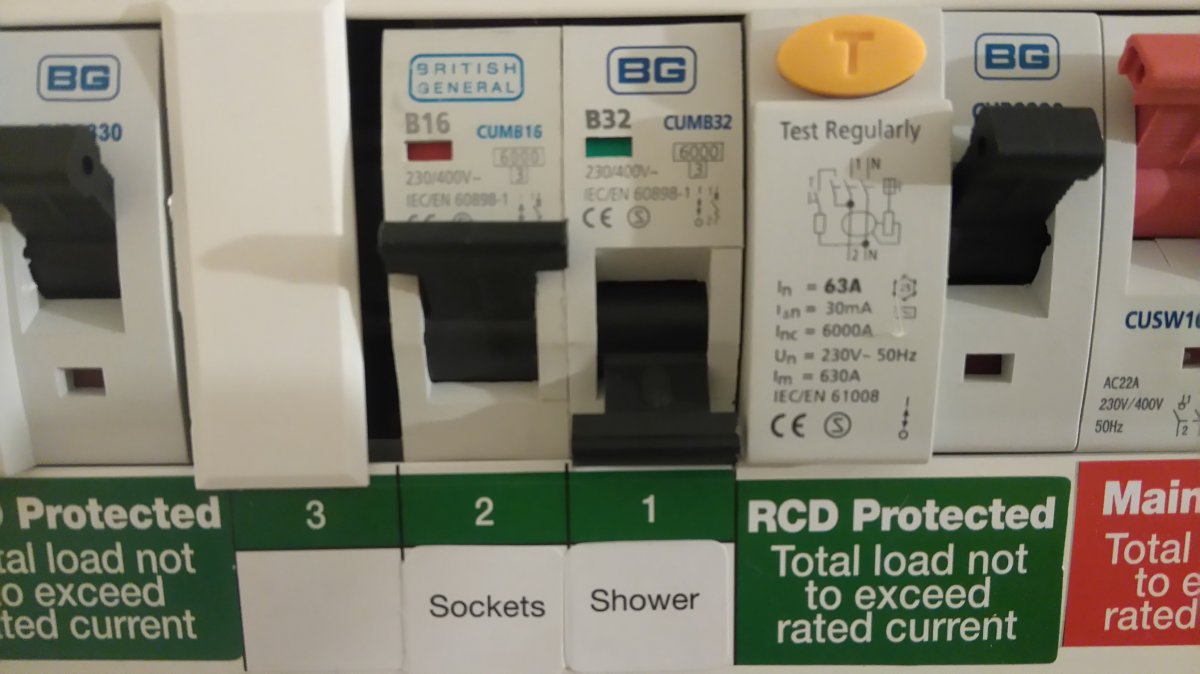

Hi all,
This appears to be a forum for people who have a clue what they are talking about, unfortunately i dont :-)
I just moved into a studio and after a few days found that the socket fuse keeps tripping, i have read many posts and have tried the suggestions, i have done the following:
  • Disconnected all plugs and plugged them in one at a time, in the end it was not the same item tripping the fuse, it turns out that it happens whenever i use something that i would consider heavy use e.g. kettle, or small portable heater (fan)
The electrician has been out and told me i am using too much and overheating the system, it trips many times when i use only three items (2 fitted wall heaters and one 3kw fan heater)
Is this right?
He has suggested i can manage it or new wires will need to be run through the wall.
This seems odd to me but then i dont have a clue.
Help?
Karl

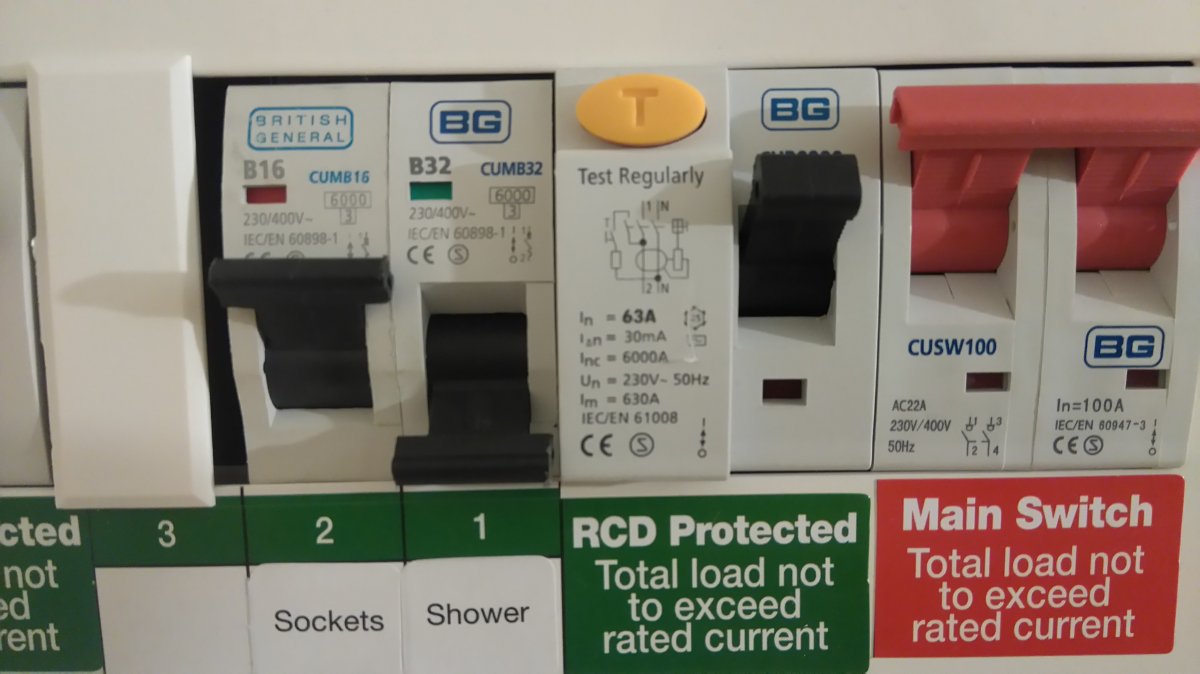

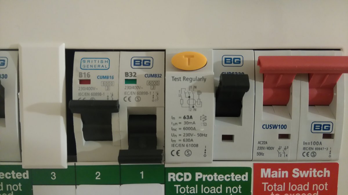

Hi, I have some photos of my fuse box, he did say i was overloading the system but does that mean i have a low grade system? i mean if i cant switch on the kettle, portable heater and 2 small wall heaters do i need to improve the system some how?
In my last place i never had this problem and used to have all manner of things working at the same time, especially when i was doing DIY.
Just noticed the photo has the wrong switch in the down position, the problem is actually the socket switch.

Well your sockets are on a 16A breaker which works out to (give or take a smidge) 3.7kW
Kettle = 3kW
Heater = 3kW
Small Heater = 1.5kW
Total Load = 9kW
So yes, you're pulling 2.5 times what the circuit is designed to supply. There must be a reason it's been wired like that.
