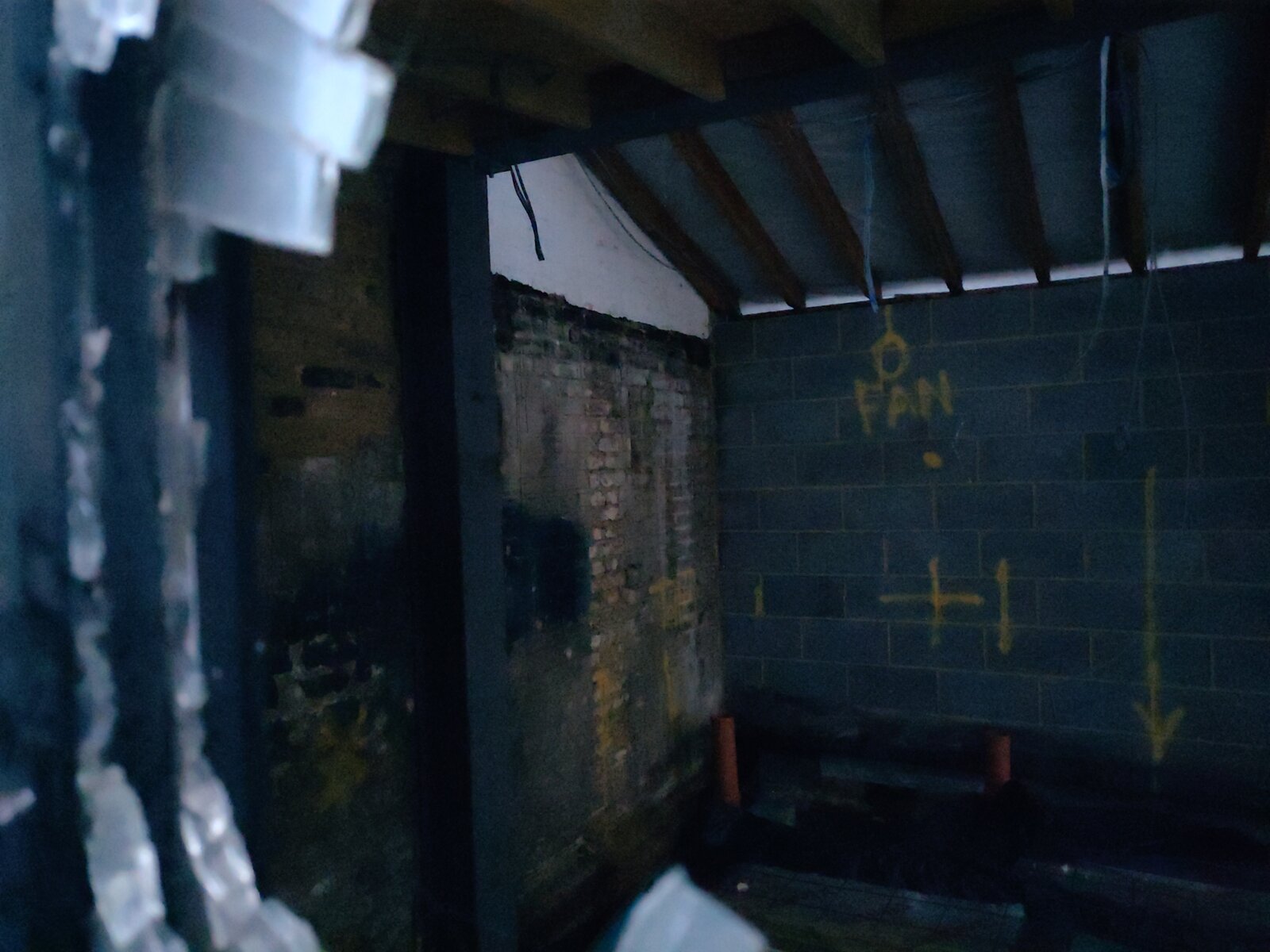

The side of our house is a brick wall. It is also the back wall of the neighbour's garage. We quite recently moved in, there may have been some party wall agreement in place but nobody can find it.
The wall, visually at least, isn't in great condition. The neighbour now wants to put thermal insulation on this wall as he wants to develop his garage somewhat and turn it into a studio.
One of the issues at play is that we have some damp evident on the inside of our side wall. Not sure if the garage has anything to do with it.
What is the best course of action for us here? Should we argue that the back of the garage be left alone to aid breathability? Or should some sort of water proofing paint be added before the thermal insulation?

post some pics.
It's a little dim, but the thumbnail below is of our side wall looking inside the garage from pavement. The white rendered bit, and the bit below is our side wall. It looks in a bad way but the garage owner has cleaned it up a bit since the photo. I think what he plans to do now, having spoken with him yesterday, is that he will have some sort of thermal insulation (3cm?) then another wall which will be the back of his garage.
He is also adding a gutter to the garage roof and flashing.
It actually sounds OK to me, but I was quite shocked to see the state of that wall. Previously there were a lot of building materials in there leaning against the wall and I don't think the roof was in great condition which would have possibly let in rain.
