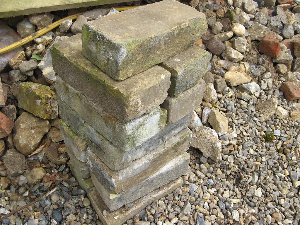

One last thing, someone else has recommended that I wet the bricks before laying if they are reclaimed. Mine are reclaimed, but they are quite solid and heavy. Are they the type that need to be wet down?
Here's a pic:
Cheers

You can dampen the bricks, but not soak them
Depends on the brick type, "red rubbers" from S. Hampshire soak up water at an alarming rate. I used to flood the reclaimed bricks with a hose, then start using the top ones after 5 minutes.
Frank
We were using some bricks today, and we ended up dipping each brick in a bucket of water and then laying it straight away. Even then we only had about 15 seconds to adjust it. It was a right pain on some of the corners. :mad:
