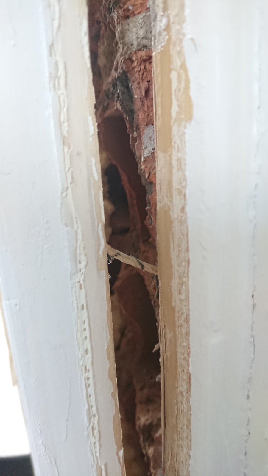

Help, have barely started and have a problem already!
The walls are in fact hollow terracotta block. The blocks have been cut so that behind the door carcass are the hollow centre of the blocks. Nothing to tie into! The carcass is fixed with foam and a couple of frame fixings into mortar.
What do you suggest? I could omit the ties, or I could leave the carcass in place, trim it back 15mm on each side using a track saw and chisel, and tie into it.
Noseall, what do you suggest please? How best to tie in to hollow terracotta?
