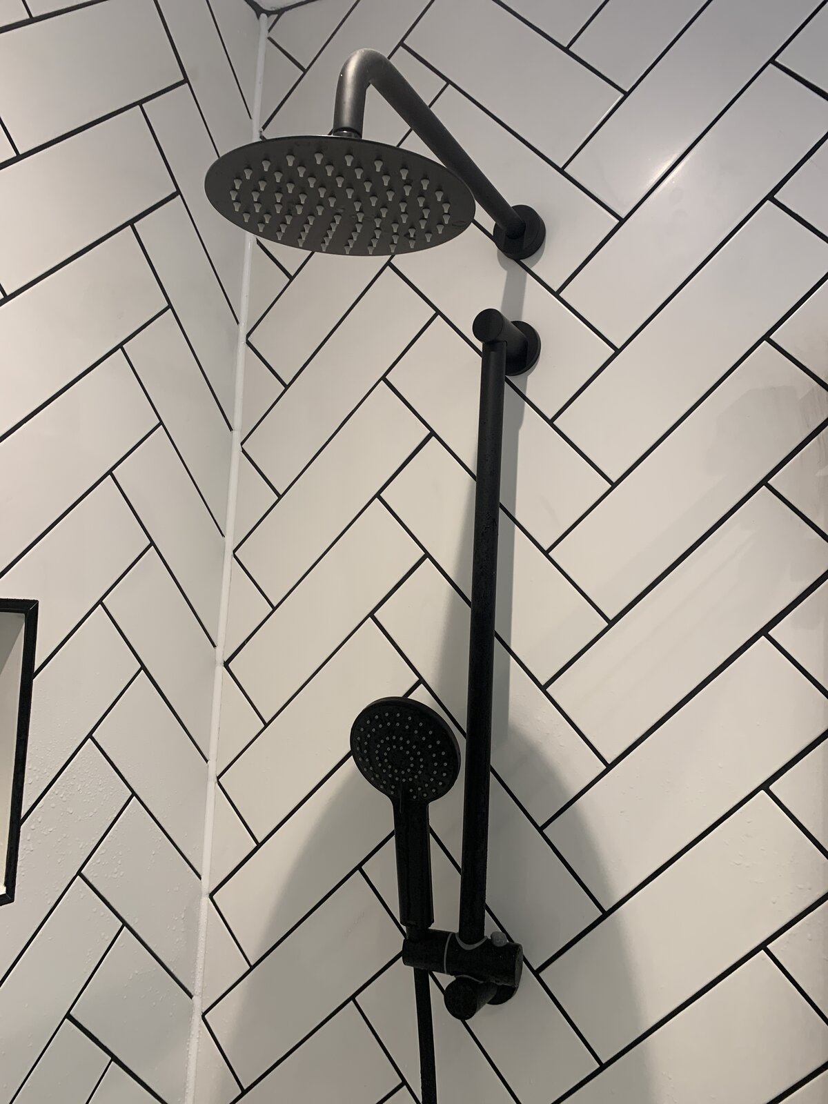

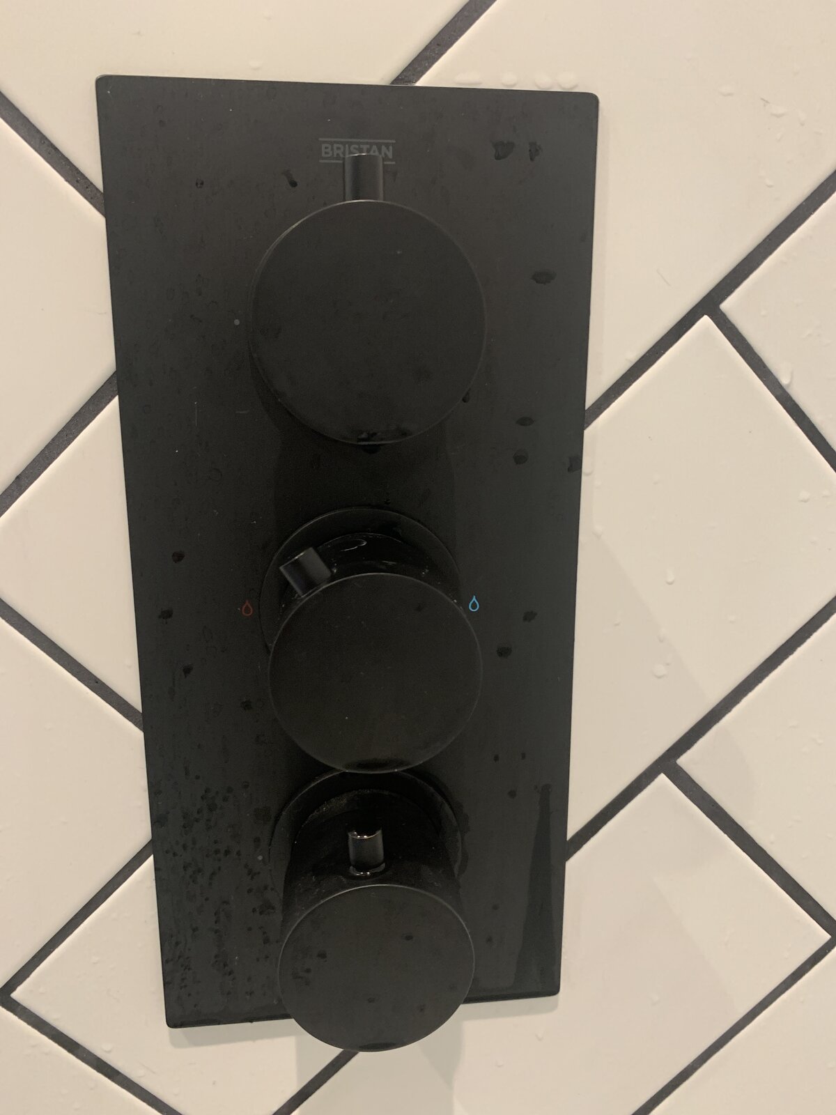

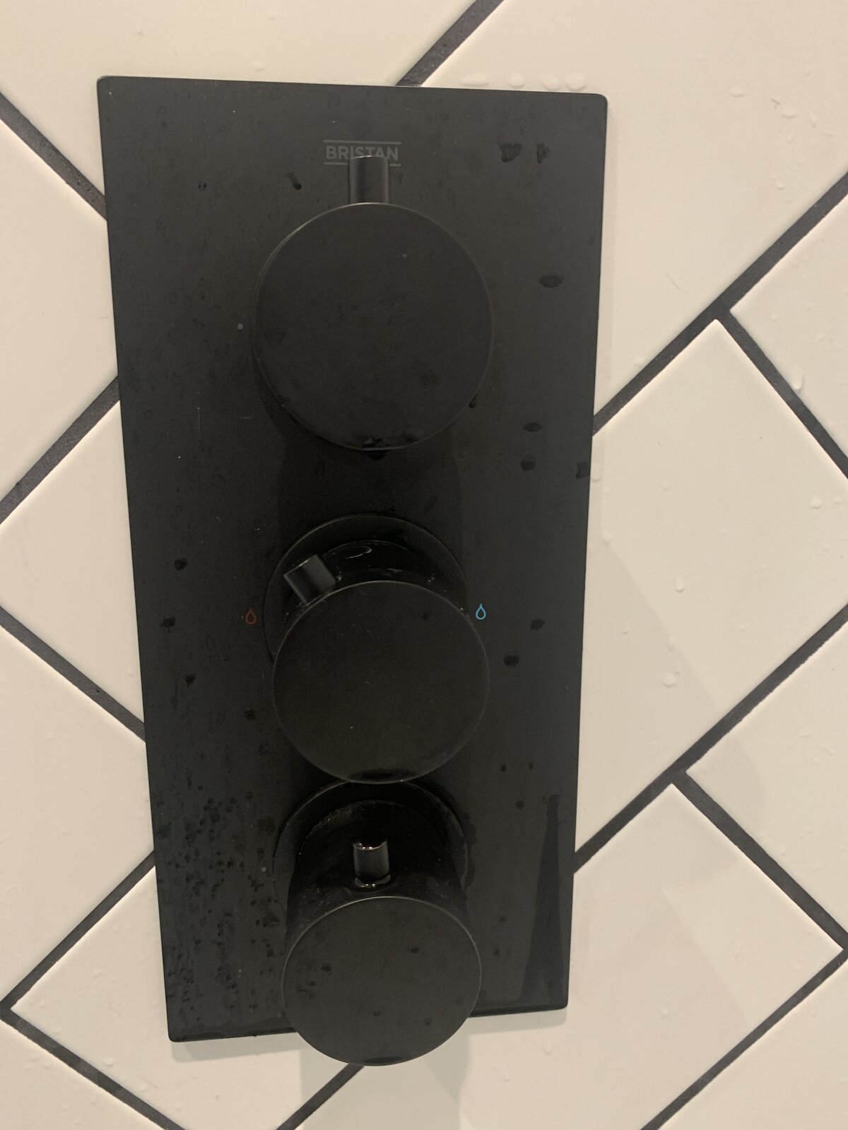

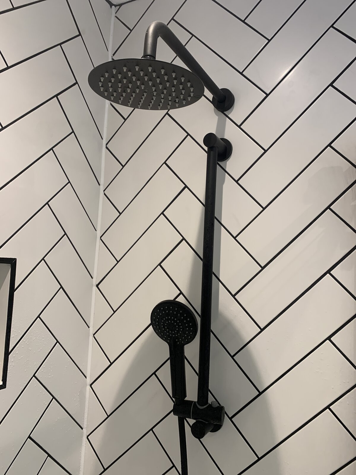

Hi
I’ve had a Bristan shower installed with recessed control unit with 3 knobs. I thought that the top one would switch between the two shower heads I have; the middle would be heat (which it is); and the bottom would be flow rate. The way it’s been plumbed in the top knob switches between the heads but also turns them on and the bottom control does nothing. I checked with Bristan if this was right and they said yes. Seems very odd though as the top control is really stiff and the bottom control doesn’t do anything.
Can anyone confirm a) if it’s been correctly installed; and b) if it has been correctly installed whether there’s any way to change it so top one controls which head and bottom controls flow?

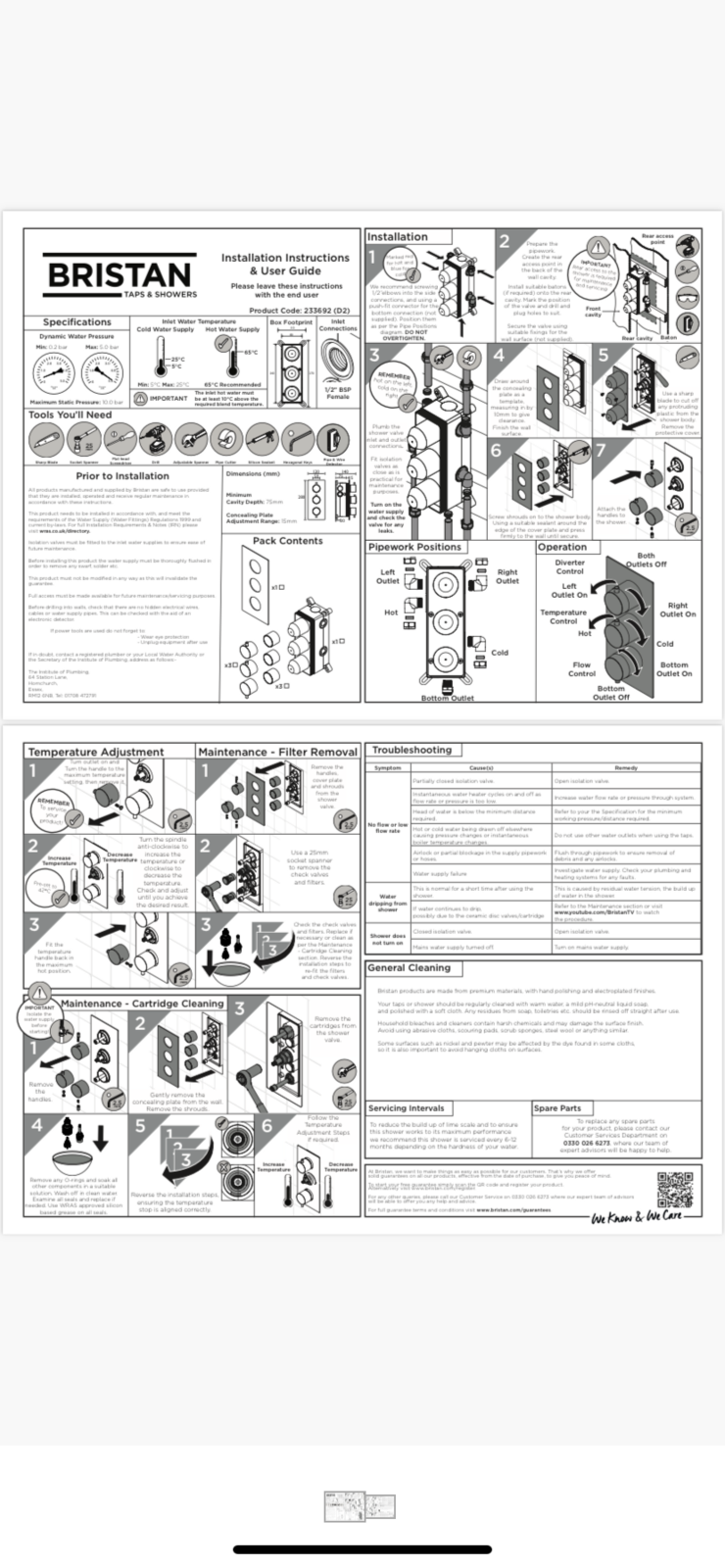

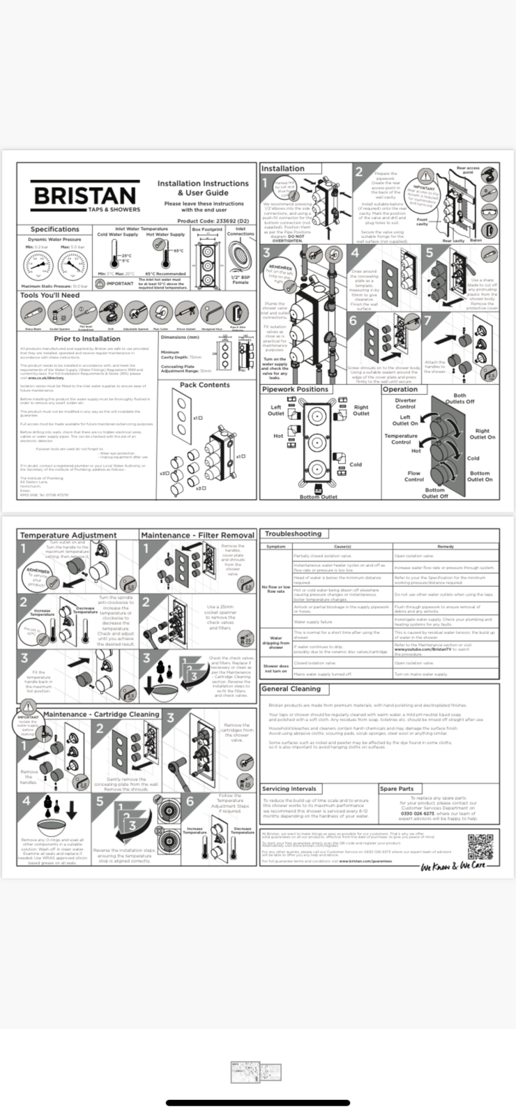

That control has three outlets, left, right and bottom. According to the book of words the top is the flwo & diverter (left top outlet/right top outlet outlet on/off). The bottom outlet is controlled by the bottom control so if that outlet isn't connected then the bottom control won't do anything, which seems to be the the case in your install. There must be a configuration for that shower where it can also be used with another outlet, say for body jets.
Usually used for twin outlet shower and bath filler.

Nope, it doesn't work like that internally. The bottom knob can only control the bottom outlet, it can't be changed to make it turn the whole unit on and off. It's doing what it's meant to do.
