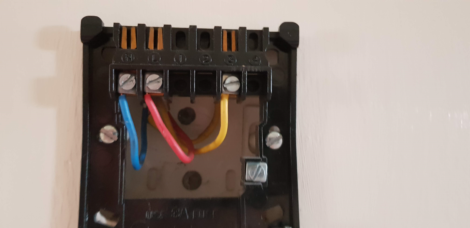

This is the wiring for the RS1, there is also an earth wire arrached to the back of the box.
Blue is neutral(N), red is live(L), yellow is attached to at terminal (3)

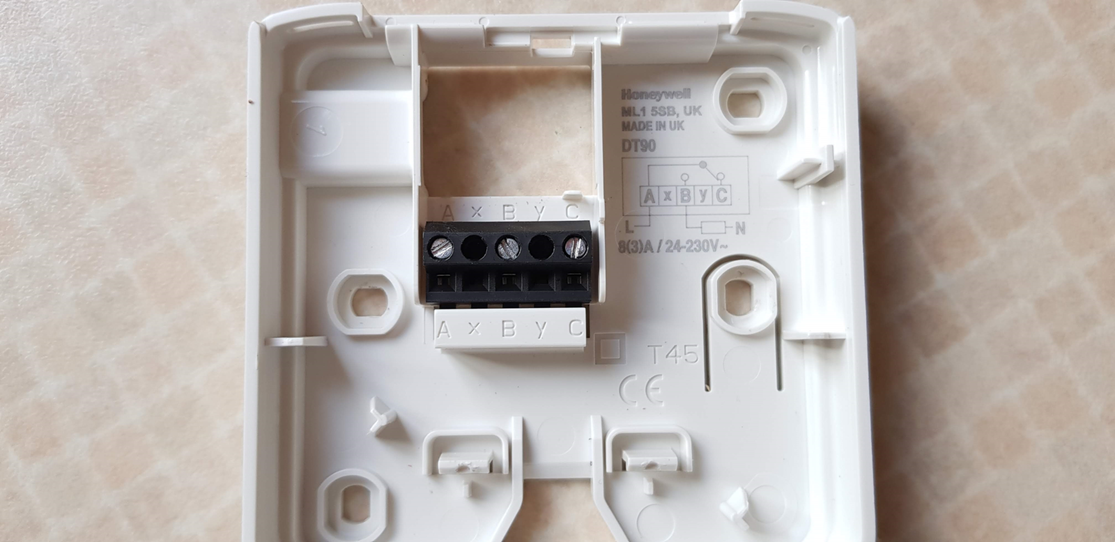

This is the Honeywll DT90E wiring terminal. It 3 connectors with screws A, B and C
I have tried wiring the DT90E as follows Red wire to terminal A (L), Blue wire to terminal B (N) and yellow wire to terminal C. The i turned the power on it tripped and blew the fuse at the socket which served the central heating programmer.

Existing thermostat Red wire = Live = Honeywell A
Existing thermostat Yellow wire = Switched Live = Honeywell B
Existing thermostat Blue wire = Neutral = Not required by Honeywell insulate / isolate it and tuck it safely our of the way. (I would put it in a separate new screw connector)
The Honeywell is double insulated so no earth connection is required to the thermostat. If the back of the box you refer to is a metal box behind the thermostat leave the earth wire connected to it.
Don't connect anything to Honeywell C.
