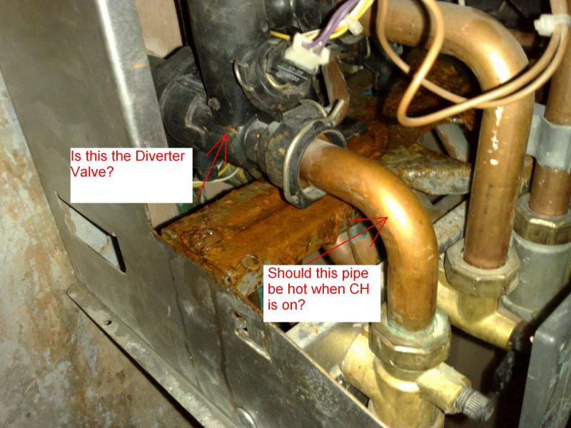

Hi,
I am really hoping someone can help me out here as I cant get any Central Heating and its just started snowing, eek!
I have a Britony Combi Chaffoteaux & Maury (I think its an 80 or 100). The Hot Water works fine but the Central Heating doesnt work. Its been like this for a few weeks now although the other night both hot water and heating started working but only for that one night. Now its gone back to Hot water working but CH not working and its starting to get a bit nippy.
I have been reading some other posts and seen that it could be the Diverter Valve but as I know very little about boilers im not sure.
I have attached an image with a couple of questions on which may help.
Any advice would be great, Thanks!
I think thats the 3way valve in the photo? Am I right? Can that be the cause does anyone know?
Thanks,

WHAT pressure does your gauge read.
Do you know what side the flow switch is on? If not I can check the manual and ill try disconnecting that wire when I get home from work, cheers.
Im constantly topping up the boiler to make sure its at 1.5bar because I also have a leak :rolleyes: It never goes above 2.5 once ive topped it up.

What happens when you try to run the heating, do yo get any response?
HTH Sam
When I try to run the heating the boiler fires up for a about 5/6 seconds and there is a hissing sound (not sure if thats normal) then the flame goes out.
It does this everytime I turn the heating on and I dont get any heat to the radiators at all. Although the other day the heating worked for the first time in weeks but only for a day..
So Ive disconnected the DHW flowstat wire and the central heating works! My only worry now is that the gauge keeps creeping up towards 3bar but ive not LET it get past 3 yet.
This may sound like a dumb question but does this mean I need to buy a new DHW flowstat?
Although there is one aspect which does not fit the situation, it seems you have a stuck DHW flow switch.
In most cases you can turn off the water inlet and take out and clean the flow switch bits. If that does not clear the problem you can replace the reed switch and that should sort it.
Tony
So Ive replaced the Flow Switch and the CH is working now. It cut out a few times but seems to be ok now.
I have noticed that the gauge keeps creeping up to 3bar is that normal? what should the pressure be when the heating is on maximum?
