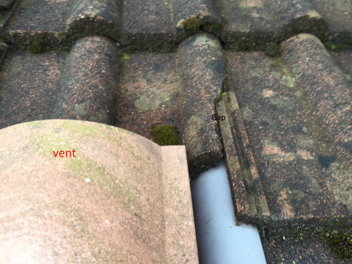

dear all
I have found that a tile near the vent on my (partly protruded) ground floor roof has broken a corner. A picture is attached. As you can see this broken tile is a bit higher up than its adjacent tile and I wonder if the water running through the gap between the interlocking will be covered by the blue tile underneath (rather than going onto the underlay felt). I don't know why the tile next to the vent is different from others: light blue-ish and looks like plastic. Is it usually longer than normal tiles so that the overlap (headlap) can cover the gap? Many thanks for any reply.

Newby2, good evening.
That "Blue" tile looks suspiciously like a plastic pipe?? Is there another Image you can post?
Ken.
