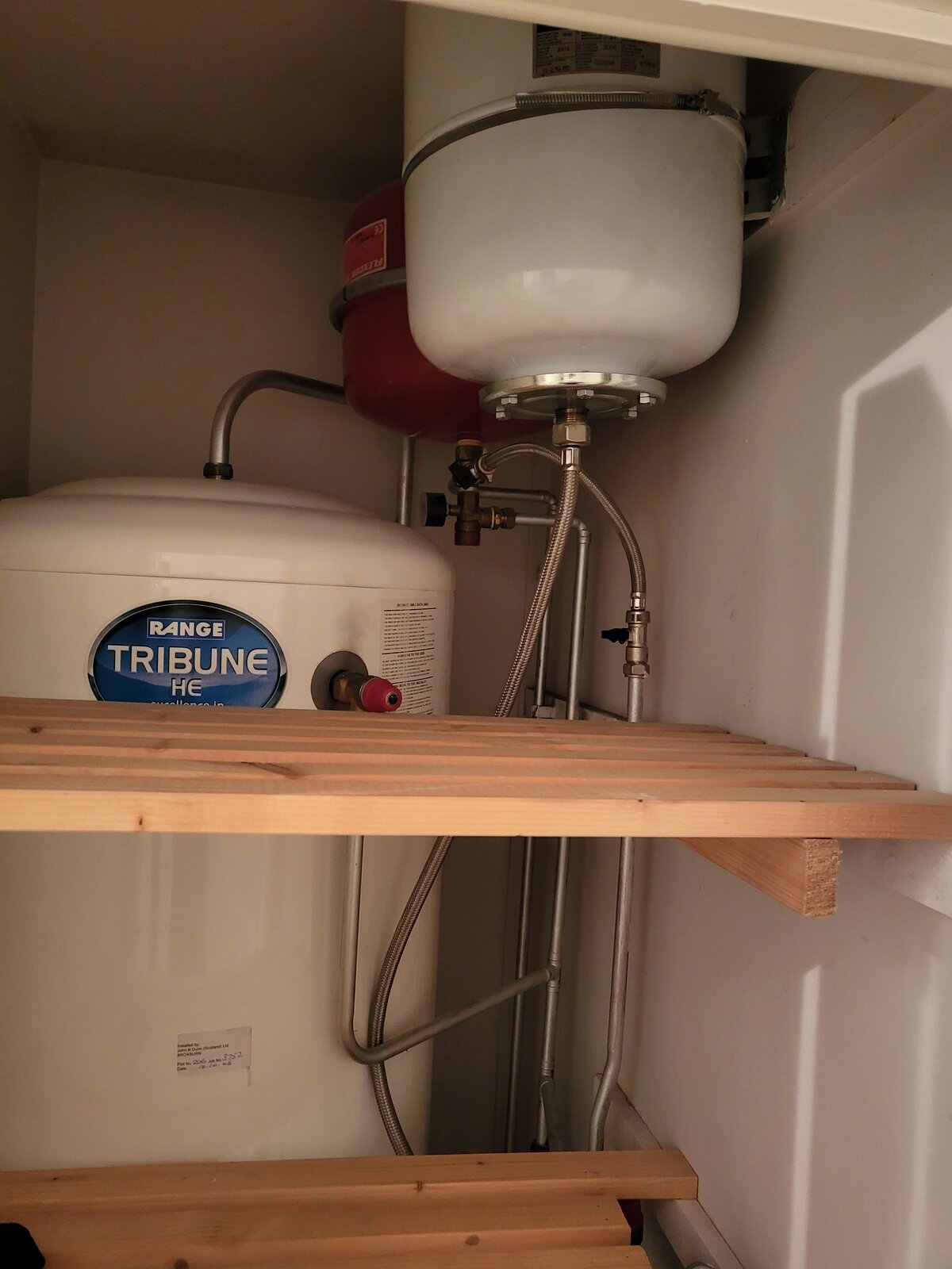

This is it. The small white tank was replaced last year for a grey one by the gas engineer (I had a clunking noise on and off).

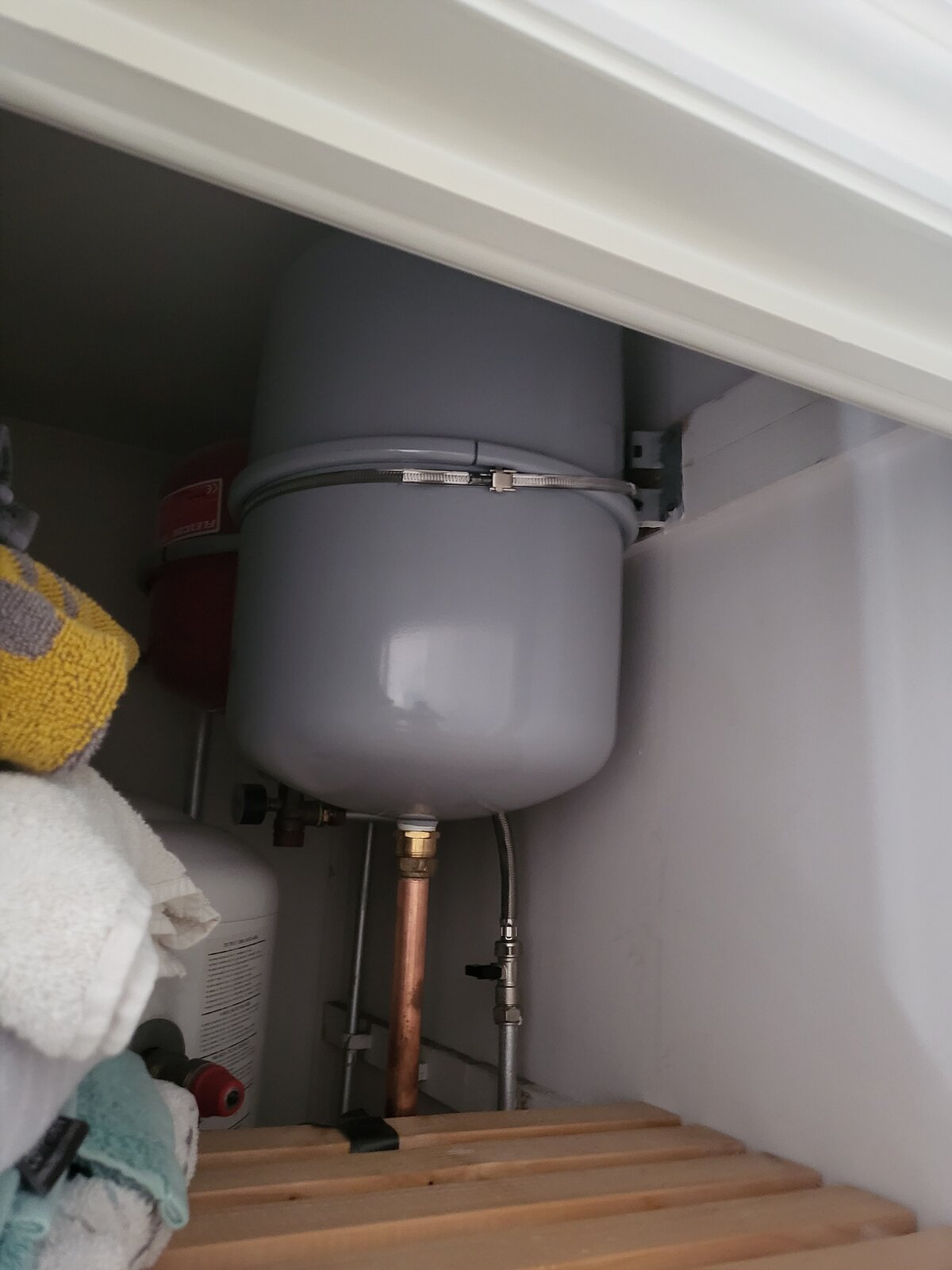

Grey one. It's been in for 6 months. No issues til brown water 6 weeks ago. Thanks

I presume your cold mains is clean? The Tribune HE is S/S so it shouldn't be that. I would want to check the make and model of that EV. If it's not white or blue then I want to check that the EV is designed for potable water, if not it could be rusting. Does the HW have a metallic taste?
They do make grey potable water EV's of course but I'd still want to confirm. Easy to check for a qualified engineer, depressurise and disconnect the EV and have a looksee.

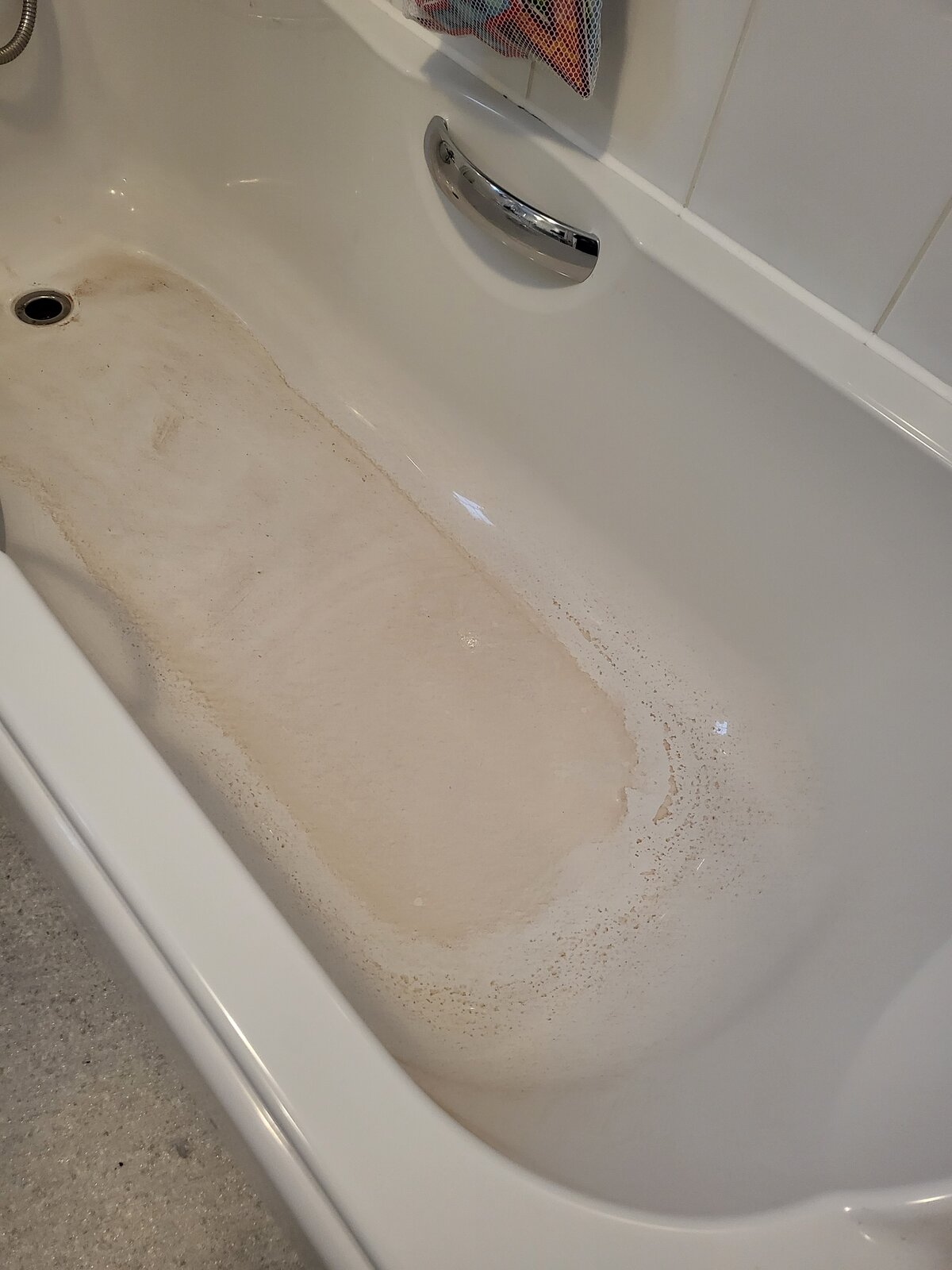

The water leaves a red dust which smells like iron.
