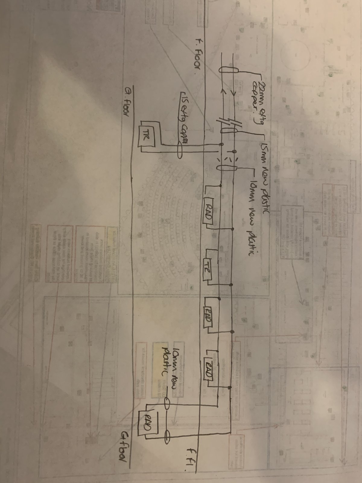

However we still have the ongoing issues with the heating to the extension. From having further checks I think the pipework is undersized and would appreciate any feedback from you guys.
I have 22 copper existing upstairs and from that they have connected the new pipework in plastic. They have come off the 22 in 15mm with a branch to downstairs feeding an existing TR. it then has another tee to a single rad immediately adjacent to the main (rad red hot) it then goes into the extension in 10mm plastic feeding a bathroom TR, two bedroom with a rad in already and right in the end is a feed to a rad in below dining room. The bedrooms rads and dining room only get warm, not hot and that’s after a good 1.5 hours.

Hard to tell from your description but it sounds as if you have 5 rads running from 1 bit of plastic 15mm. Which is pushing their luck bigstyle. First one- try turning all the rads on the new leg off except the furthest one (or balance it as per above). Get a thermometer (non-contact IR job) so you have some numbers to back up your claims. Worth totalling the heat output of the rads on that 15mm leg -15mm copper can handle between 6 and 9kw (at acceptable flow rate), not sure about numbers for plastic.

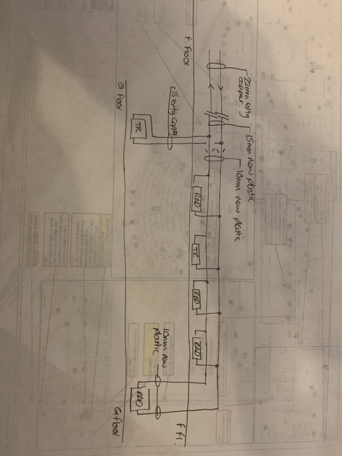

thanks for the reply. That attached will hopefully show this mess a bit clearer for all. The ones that aren’t working as they should are mainly the last two rad on the first floor and the end one that drops to the ground floor (that one isn’t as bad)

Looking at that, you have x5 rads in 10mm plastic? :eek::eek::eek::eek: I’m surprised any get warm if that’s the case. As per @oldbutnotdead, that’s more than pushing luck. Should be 22mm flow and return, with branches off them imo.
