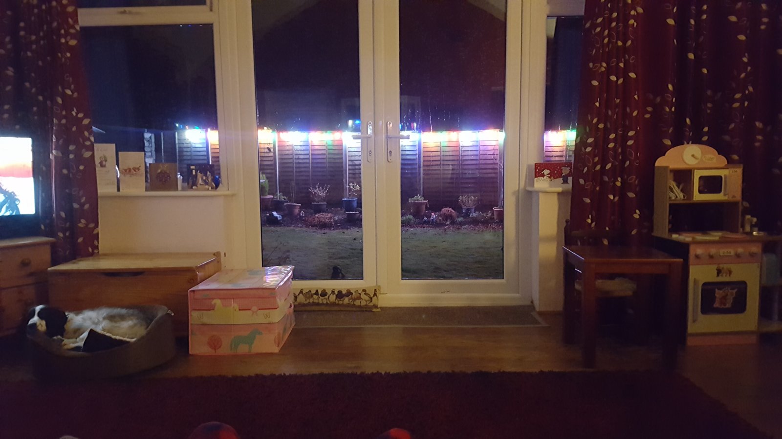

Anyway, I've installed some festoon lighting using a festoon harness and LED bulbs from TLC. Both are IP44 rated.
It all looks very nice and SWMBO likes them - especially the fact that they look like "real, old fashioned light bulbs"

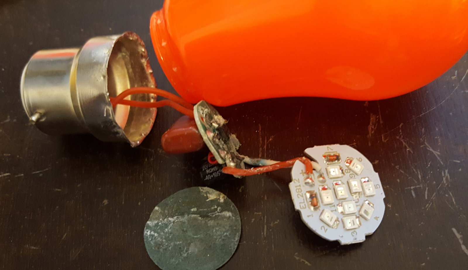

On investigating, I found that a "failed" lamp I removed actually worked - briefly before the RCD tripped (it was in an earthed metal holder when I tested it). It showed low IR between pins and cap - the reason for which was obvious when I opened it up :
Everything was wet, particularly the disk of insulating sheet which was between the LED module and electronics PCB - plus there was a small amount of water in the bottom of the bulb case. After drying out, works fine.

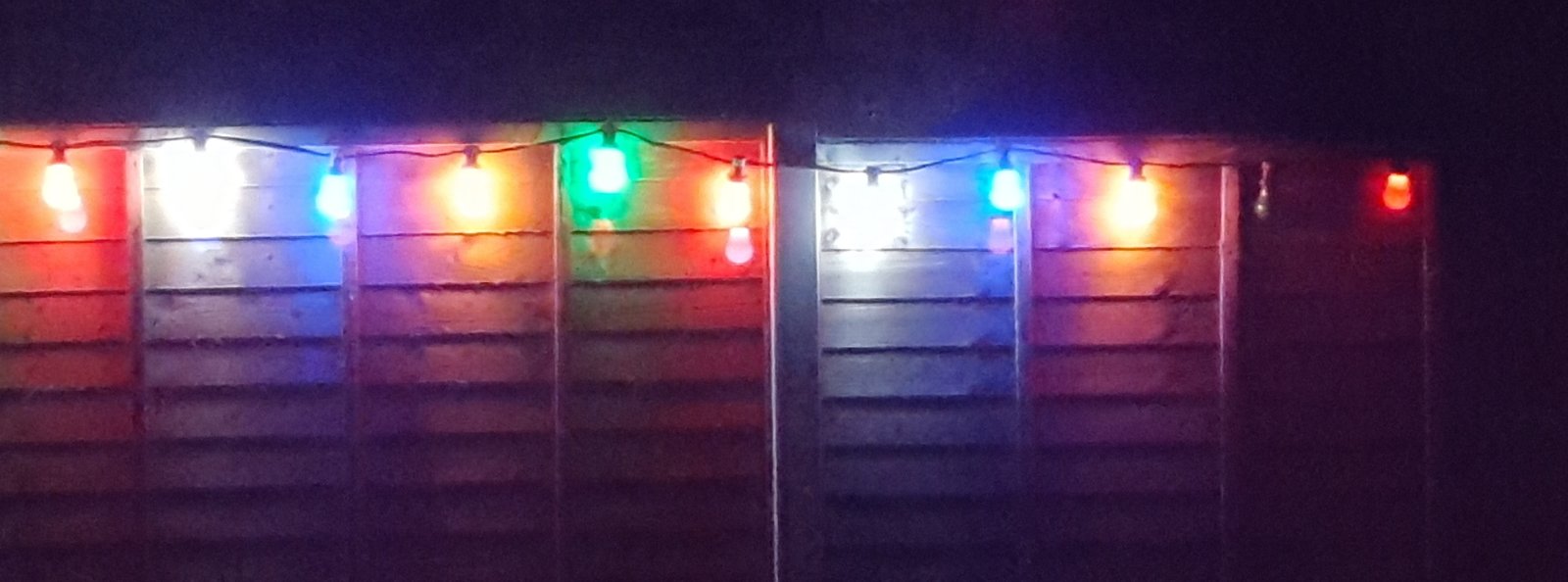

When the next ones failed, I noticed that it wasn't always a total failure, the red one at the right here is still glowing dimly :

I'm thinking that I've hit a gap between the IP ratings and practical usage. The lamps may well pass the IPx4 test which only requires splashing for 5 or 10 minutes. But in real use, they will breath due to changes in temperature and environmental pressure - and as there's no seal whatsoever between cap and "bulb", are bound to draw in moisture even if there's no rain. I did note that when I unplugged the bulbs, a tiny amount of water had been drawn up into the space inside the harness socket seal where it seals on the the neck of the bulb casing.
At the moment I'm thinking that I'll have to dry them out and try sealing the bulbs properly. I've had some "old fashioned" 25W incandescent bulbs out in all weathers for years - and having a sealed bulb they've not had this problem. But at 300W for 12 bulbs, or 1.3kW if I'd added the 40 bulb set with them, not something I want on for too long :whistle:

Interestingly, as I sit writing this, I notice that the end red lamp that was dim is now at normal brightness - but the next red along (5 bulbs to the left) is now dim :rolleyes:

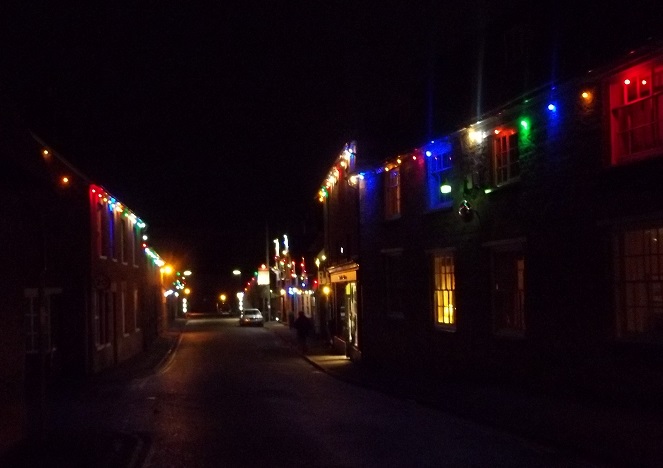

The village has over a thousand golf ball lights at Christmas
and this year the conversion from incandescant to LED has begun. Time will tell how many of the LED lamps fail due to moisture ingress.
Yes, the rubber sleeve should keep most of the water out. But when I've removed some of the bulbs ive found water trapped inside. The keynthing is that if the lamp is wet when air is drawn in then water will be drawn up into the seal.
As already mentioned, a 25W bulb will heatvthing up enough to drive out water. That's not going to happen with a 2W LED.
I've had some failed bulbs on a radiator for a few days - the IR between cap and terminals is now OK but I think there's still moisture to be driven out from the "cardboard" insulator.
