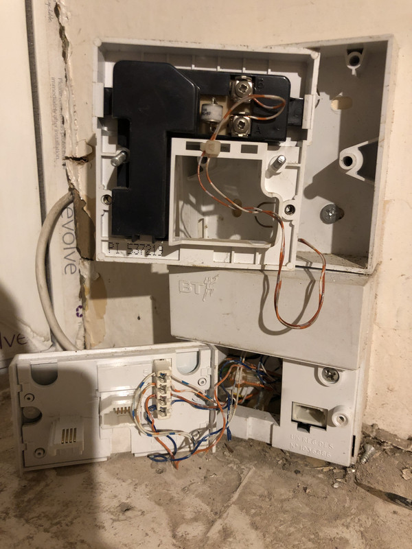

Hope someone can help. I’ve got an intermittent issue with our BT Home Hub posing internet connection a few time’s each day. Could well be the modem itself but thought I’d check wiring first.
Is this the correct wiring for an extension socket? Note the orange/white and white/orange wires are NOT connected...
Many thanks!
It's not been done with the correct tool and the wires have been untwisted, so it's not great(from a 'knowing what they were doing' point of view). But it should still work.
PS - I hope that is your master socket and you are just showing how the outgoing wires connect, rather than that is actually the extension socket?
That is the extension socket I’m showing you so these wires are incoming from the master. Why, what’s up with it?!
Hmmm... just done some Googling, I wonder if this is indeed a Master socket on a second phone line given your comments above.
I’ve always assumed it’s an extension as the cable goes off upstairs to another Master socket and then out and up to the roof. Perhaps there are two lines and this isn’t an extension of the Master upstairs.
Will whip the front off again and take a look.
Someone has fitted another master as an extension socket, then. This is incorrect, a master has extra components on the PCB. There should only be one in the house, where the line enters.
ALL other sockets in the house need to be a slave socket (AKA secondary socket), which has no extra components soldered on at all.
Do Andy's test first at your actual master socket first and see what the outcome is after a few days. This will prove if your internal wiring is causing the problem. If it is, buy a slave socket and a krone tool and change it over.

Right, property is a former split commercial and resi so could have two lines.
If I trace the wire back from the socket pictured above I find this:
The bottom box has two cables going in, one from what I assumed is a slave in my original post and the other cable going outside.
I’m confused as to what’s going on here and which sockets are masters / slaves.
Any ideas from these photos chaps?
...I should add, the top box had the faceplate in place but I pulled it out to expose the inside. The faceplate had no wires connected to it.
At the moment, it looks like the bottom one is your master and the top one was probably another line with a different phone number.
Can you open up the bottom box and try and show us what's in there? Especially if you can see a black cable which has different colours to what we've seen so far. (i.e orange, white, green and black. None of which are striped, just plain colours.)
