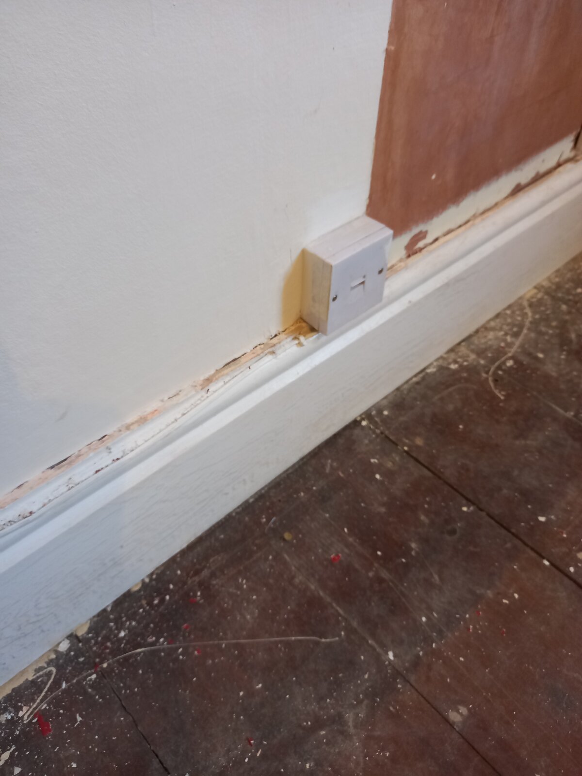

What appears to be the first BT socket, is mounted in the front, downstairs room on the internal wall between the Lounge and Hallway. I'm assuming that this is the Master socket and I can therefore remove everything after this? Is it a problem if I in fact remove this one as well? And just leave all of the cable hanging before they even enter the house?

Maybe sockets have a removable face plate which all the wires plug in. Remove all the wires and leave the master for now.
Virgin used to use Nintendo security screws to access some boxes. I carried a set for years to gain access to paper behind.
Master sockets look like this but can vary.
You can see the removable face plate. Just disconnect wires from that.
Old BT socket wasn't like the link. More like your photo.
To answer yeah.
Remove master face plates.
Pull out house wires.
Leave the original line from road connected.
To test. Use a contactless wand
Re the first picture - have you traced the cables each way? I don’t think that’s the master

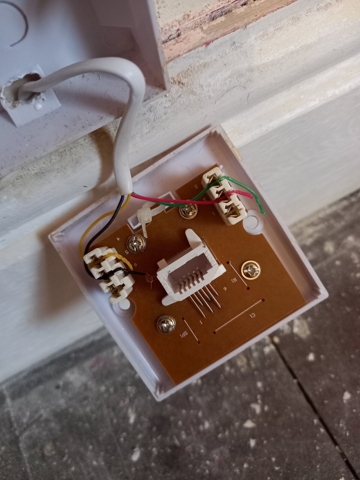

If the faceplate isn't 2 piece (where the extension cables are wired into the front, lower half of the faceplate) unscrew the front part, if there is a Yellow capacitor in there that is the master socket, no yellow capacitor is an extension socket.
No sign of a capacitor so I assume, an extension one. No idea where the master is then.

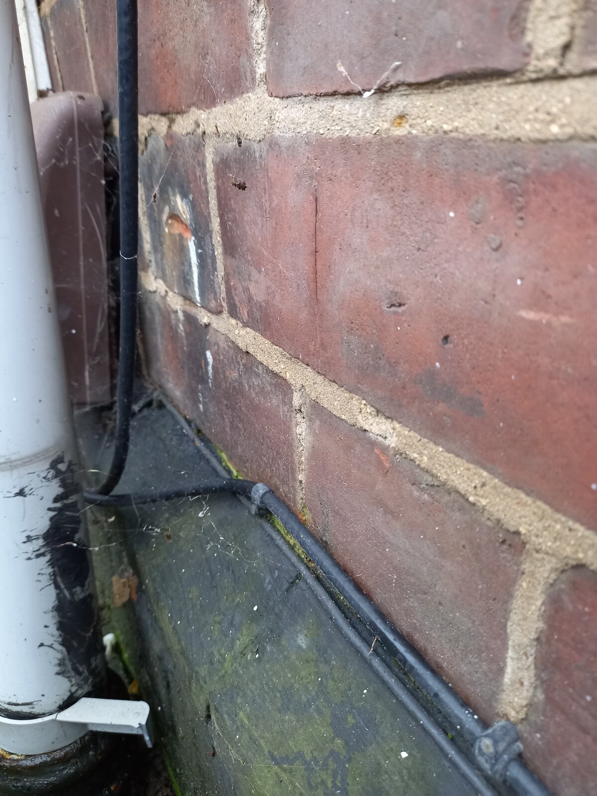

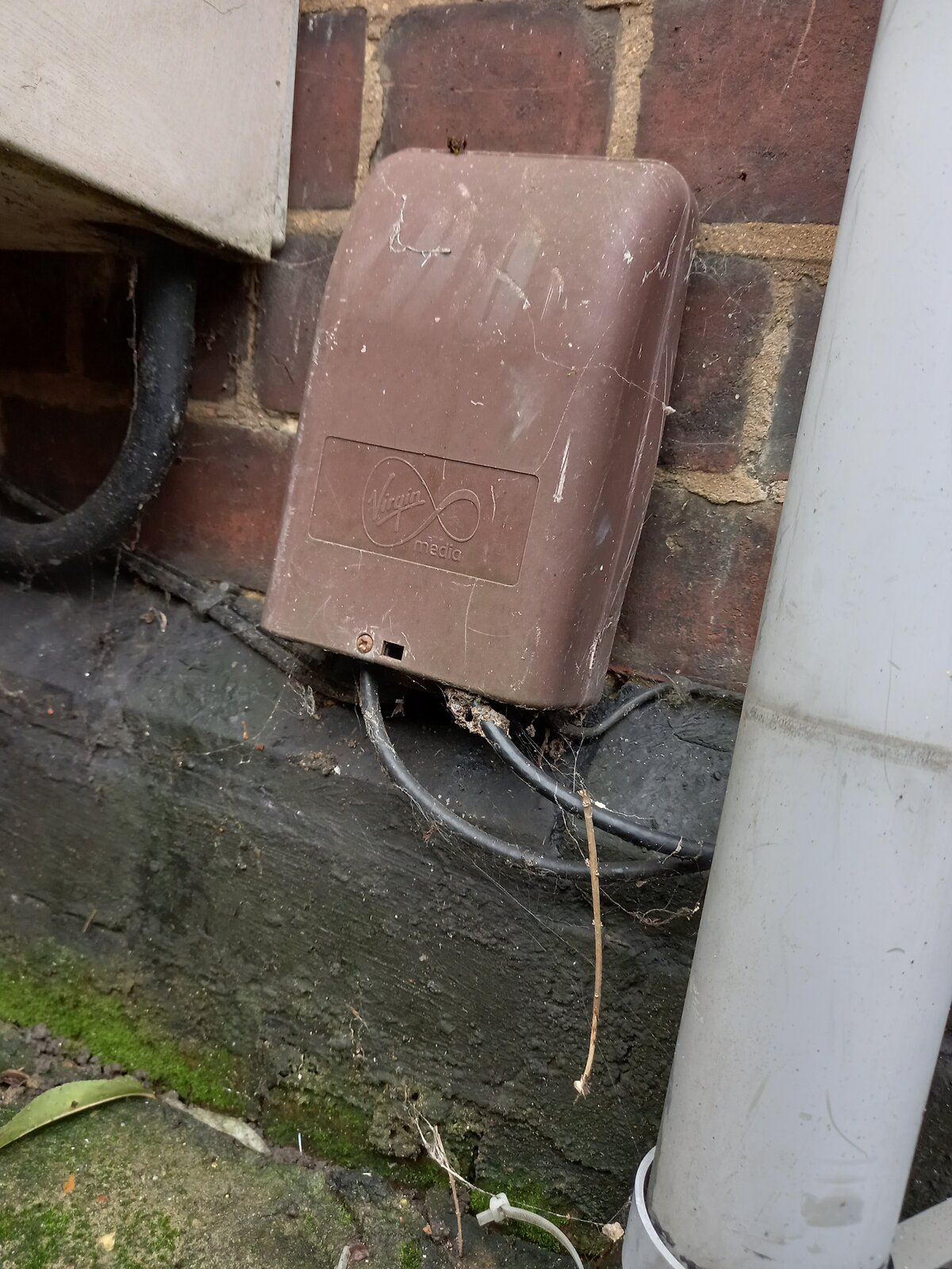

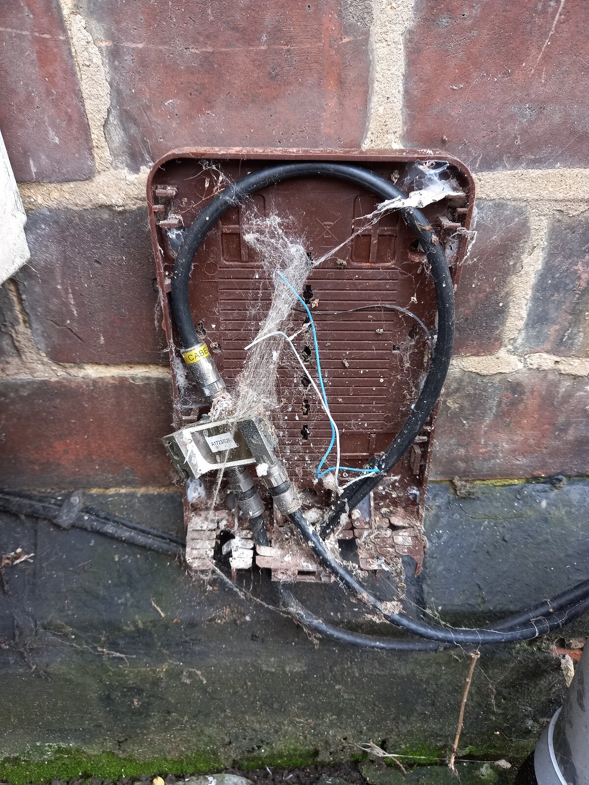

What are the various wide and thinner cables coming from the Virgin box?

The VM box will have the telephone line and it looks like you have two coax cables running from it. On the other side, you have the shotgun cable (supply) running into it.
Undo the little screw on the VM box and slide the cover up.
Technically, it remains their property. However if it were my home, I would remove each of the cables to the left of the brown box. The telephone line side is only about 50 volts .

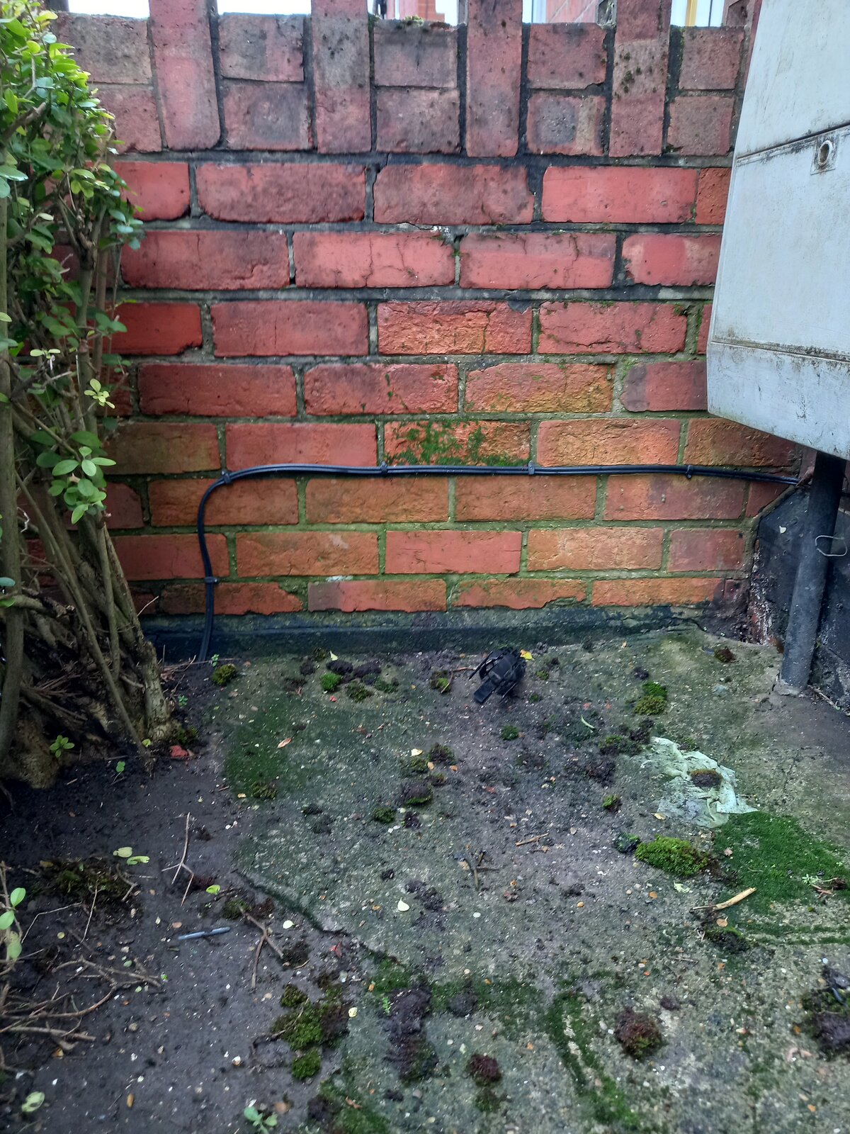

Do you mean the cables to the right? The one's going into the property. The ones to the left are the supply cables. I assume that the ends of these should remain within the box. The telephone one (the thin wires), I have already snipped and discarded the cable. I've been around the house and removed all of the white boxes and white coaxial cables. It looks a lot better now.
I didn't ever find the master BT box. At the moment their supply cable, the thin black one with the thin wires coming from roof level, is just left hanging. What should I do with this? Can I stick a scotch-block on the end and then bury in the wall?

Just pull the whole lot out as if you ever require service they will reinstall it all new free of charge as they want your business. They are all old line jack u it’s old hat now get rid of it all including the virgin back to brown box outside.
