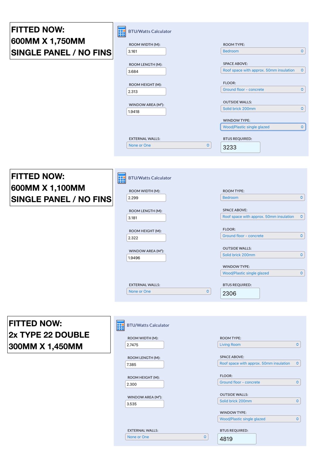

I started to size up my radiators and it leads me to wonder if my previous rads were generously oversized.
For example, in the lounge I had two type 22 double rads that are each 300mm x 1,450mm.
I’m guessing their combined output would be well in excess of the 4,819 BTU I’m getting from the estimating tools.

Would you agree that two type 22 double panel rads at 300mm x 1,450mm would seem generous for the ‘living room’. The estimator tools suggest 4,800BTU whereas the fitted rads must be near double that ?
Best D
Taking the standard Delta T50 fig and working with Kudox radiators in theory you have around 10000BTU output, perhaps they were sized on a T30 Delta which would give you 5000BTU?
