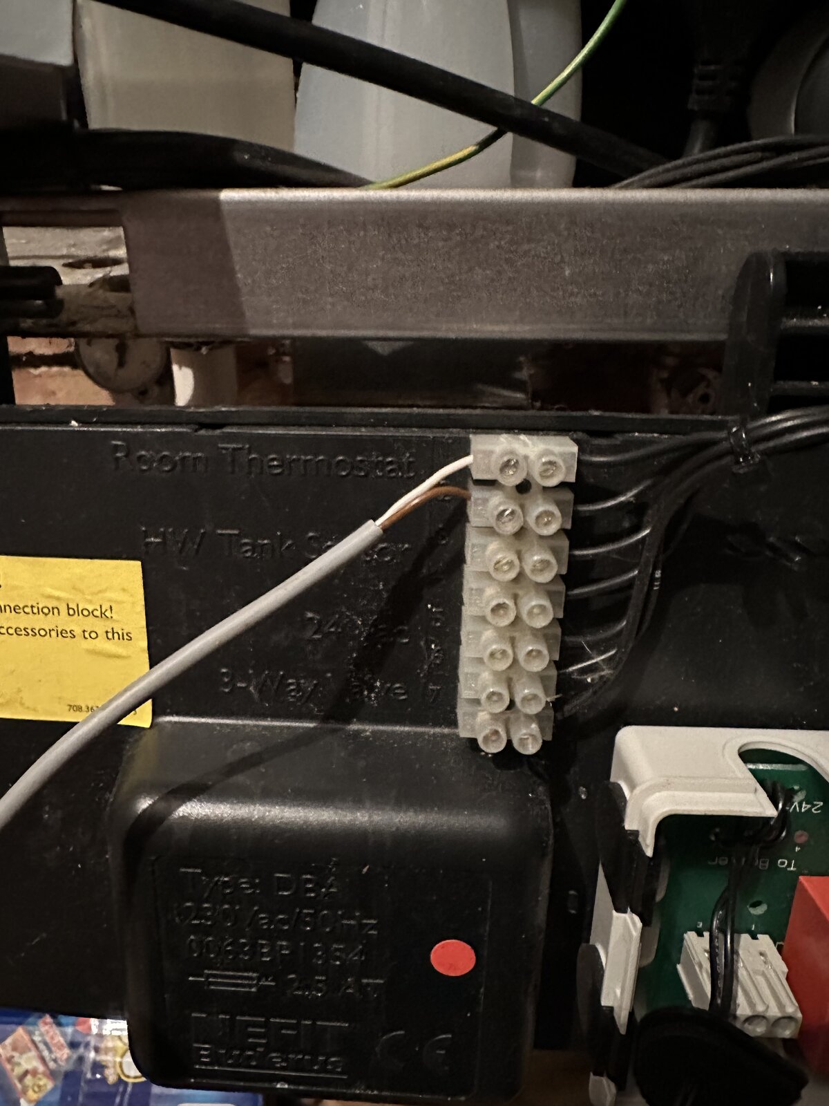

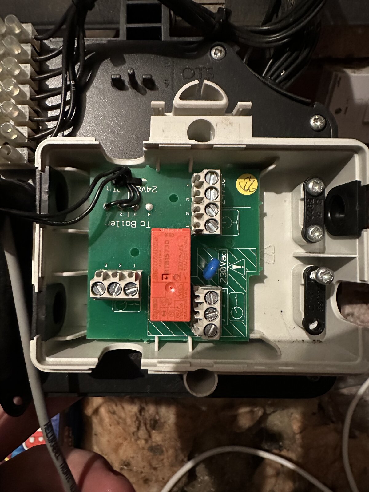

I’m trying to connect a hive single channel wireless thermostat. I’m having a few issues on trying to get it to work with my boiler and how to wire it etc. any help would be great.
The white and brown is the current 24v thermostat, are you saying when I connect the hive it needs to be in 1 and 3 on the boiler or 1 and 3 in the hive receiver
Can you post a picture of how you connected it?
Was the existing stat working correctly, before you attempted the change?
And what model was your existing stat?
The existing stat was working fine before hand, I have however reconnected it since and it no longer works. I’m thinking it could be the main control PCB that would need replacing? I’m 100% sure I’ve connected it correctly, I’ve also changed polarity of the connections to double check
