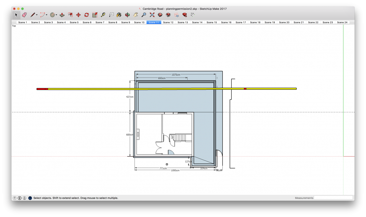

Hi,
We're just about to get started on our extension and are trying to minimise costs by doing simple things and some plans ourselves. I did planning permission myself (approved), some builders are wanting quotes based on build over agreement with Anglian water for the sewer before we start, which needs technical drawings. Can some validate these for me!
* Depth to invert - 160cm
* Rough clearance between back wall for extension & sewer - About 56 cm
* We'll get the depth of foundations correct for building control, but just wanted to get the build over agreement sorted first, at a guess of 130cm, I'd prefer not to do foundations down to 160cm.
* We can't dig test as of yet, as the back garden is all concrete and I'll be getting rid of it in a couple of weeks
* Proper plans for building control will be done as part of the build (includes steels etc), I just want to get this build over agreement in place quickly for more accurate builder quotes
Request - Is the last image good enough?! Is a lintel ok? Do I need to go down to 160cm?
Thanks very much,
Dan

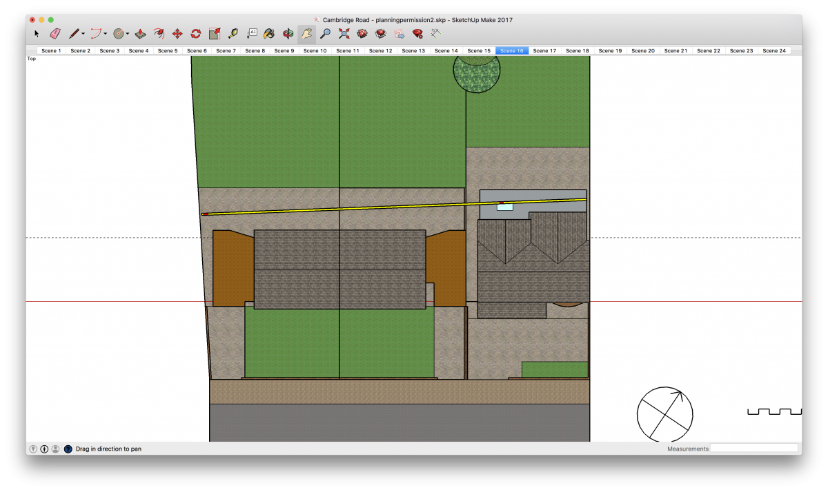

Note: The image above shows a slightly exaggerated angle of the public sewer and the original plan. Yellow = sewer. Red = manhole. No manhole on my property.

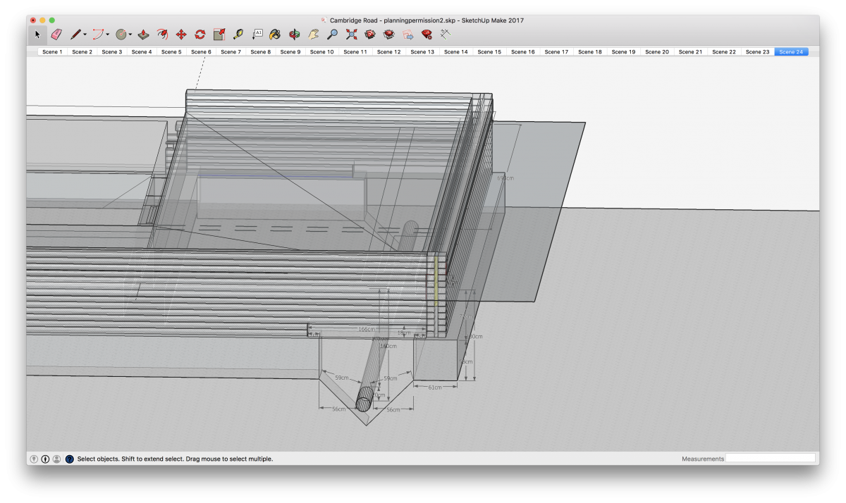

Note: White = original house. Blue lines = planned extension

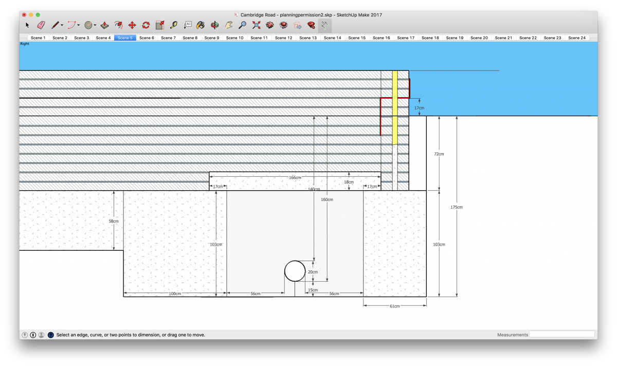

Update: 175cm deep foundation option:
Note: Are you allowed to have a 'step' in the depth of foundations?

I haven't checked Anglian but my local water company insist on foundation being taken 150mm below drain invert within 1 metre of drain.
Yes, I was hoping to avoid it, for completeness, I've just added a second section. Is it ok to be just within 60cm of a sewer with a parallel wall?
I'm not sure why you show no foundation over the drain. Usually you only need to bridge the drain with about 300mm clearance (and not so wide). I tried to look at Anglian's guidance and couldn't find it do they have any? If not try a different company, Wessex Water have some details.
You can step the foundation, I cannot remember the figures look in Building Regs Approved Doc A.
Are you showing us these images because they are what you are actually going to submit to the water company? Or have you not yet drawn up the drawings yet?
My local water company also insist on the 150mm beneath the drain. They also expect a CCTV survey or complete exposure of the pipe to confirm its condition prior to the approval being issued.
There’s no point guessing the depth, the depth could easily have significant cost implications and may affect the foundation design.
And Building Control will expect a Full Plans Application where a Build Over is anticipated.
Are you meaning setting the lintel at a lower depth and concreting over the top / start course of bricks lower? I could only find these types of examples with lintel usage:

there is a link on that page which will take you to the guidance notes. In a nutshell either set the lintels deeper in the foundation as shown or simply shutter around the drain and put some reinforcement in the foundation over the drain it all amounts to the same thing.
By the way the three examples on the links you posted all appear to be wrong. The internet can be a very dangerous place.

Thanks Wessex - I've looked at this and a few other guidance notes from other providers. I get the shuttering around the drain, that's good, thanks. I don't see how you interpret setting the lintels deeper from the Section C-C diagram and how this is any different from the last image that I added (175cm deep). As far as I can read it, the Section C-C doesn't contain any foundations above the sewer, only the lintel at an indeterminable height above. Unless I'm completely misunderstanding. But yes, I think I get your point, minimise the pea gravel 'gap' between the lintel and the sewer, but I haven't read anything on any guidance notes indicating that this should be the case. Hopefully that makes sense.
