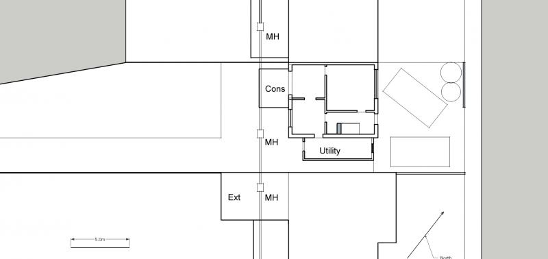

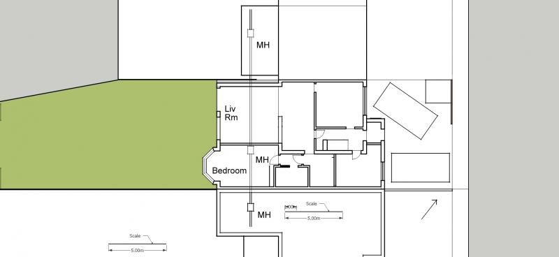

Hi. I am getting a little freaked out. I have planning permission for a large extension to the side and rear of my semi-detached house. I did the plans myself on sketchup so we've not had an architect involved. There is a sewer running through the back garden with a manhole cover over an inspection chamber. My plans put this manhole cover in my new bedroom (see photos).

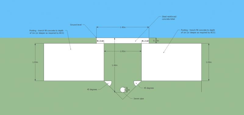

My builder assured me before building that we could lintel over the sewer and install a double-sealed cover in the bedroom - not perfect but not a real problem. The sewer and manhole covers have been built over in a similar fashion on both sides of us.

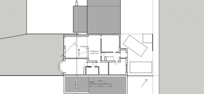

Anyway, my builder called building control, who told him to contact Thames Water. They said on the phone we will need to divert the sewer but I have no idea how that might work, since it is built over on both adjoining properties already. Their information says 'where feasible Manholes should be removed and piped through. Manholes should be constructed outside your extension'. If they allow me to cover and pipe-through do they also require a replacement manhole? If so there is nowhere to put it as the extension covers the entire run within my property boundary.

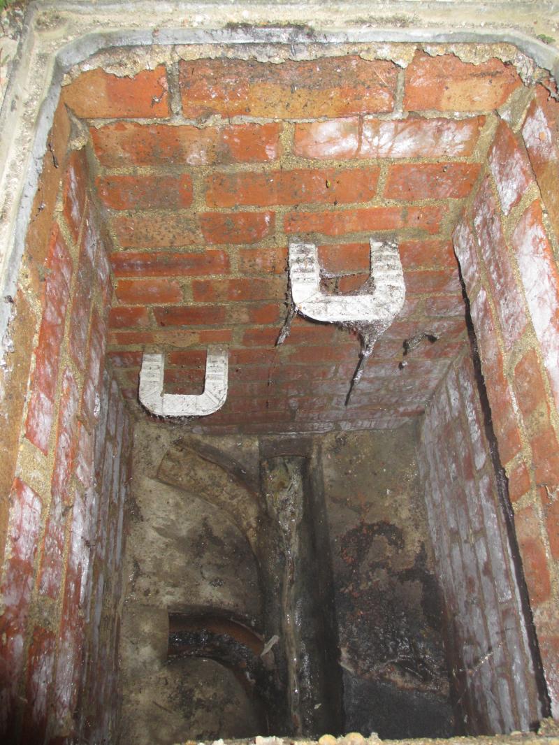

Just in case it is important there is a photo of the inspection chamber. The pipe runs 1.40m beneath the manhole and is about 15cm in diameter.
