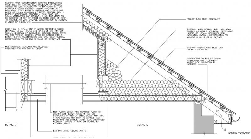

The builder has asked if an additional steel is needed in the new loft floor to take the weight of pitched side roof into the gable walls. This is not currently shown on the plans and my builder is stating that this is a usual element of a conversion and is there to stop all the weight of the house being passed to the new steel we have to add in the open plan lounge ceiling.
Although I do not have my plans handy, this is an image I've taken from another post that explains the steel he is reffering to.

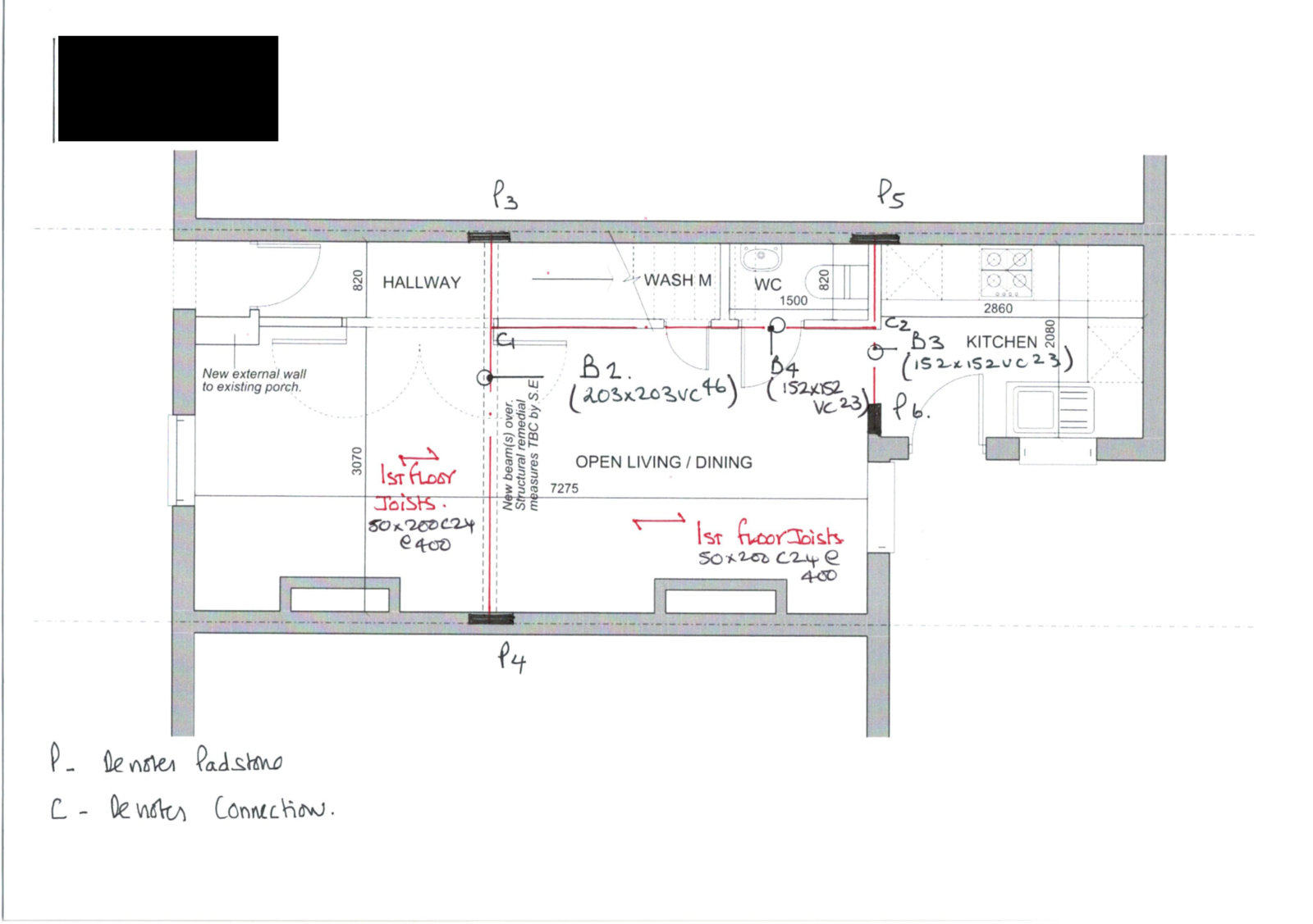

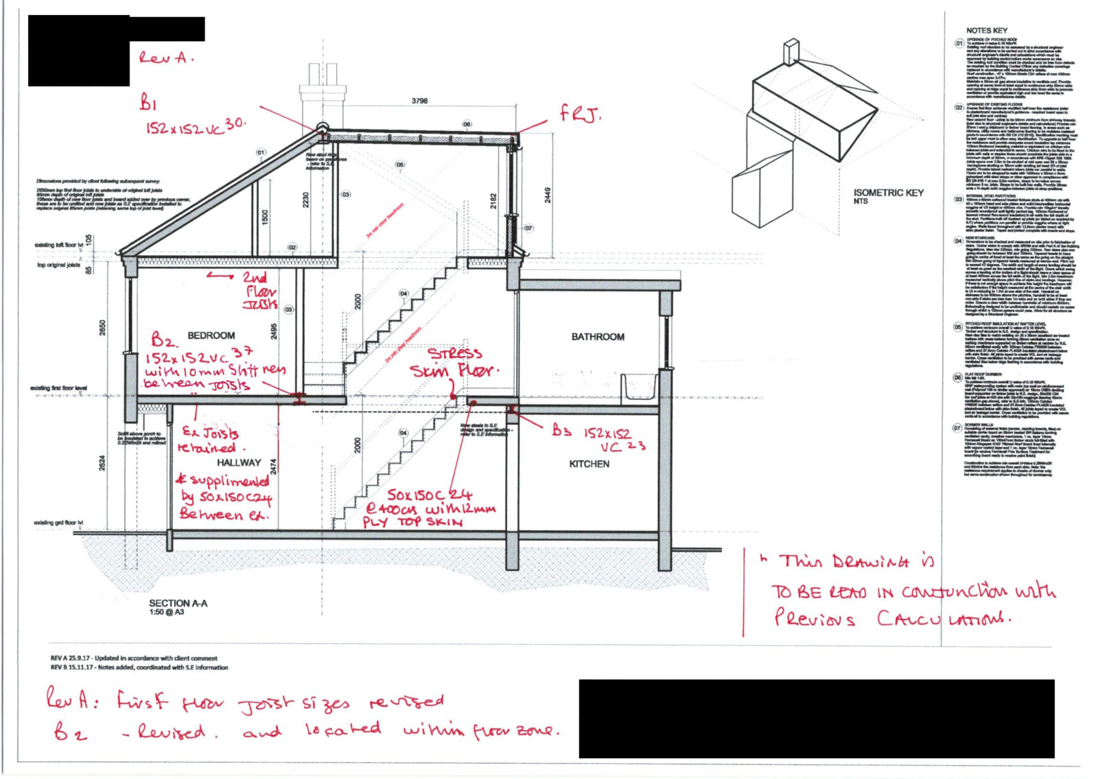

I have attached the original drawings AND the revision - which reduced the size of the lower steel (to a 152x152vc) and joists (to 152x50) so as to fit in the ceiling void and not impact the original window frames. The smaller steel had 'webs' added and the smaller joists were strengthened via a 12mm ply stress skin.
My builder is questioning two things:
1 - The need for beam 4 - he feels this seems over the top OR, if needed, what the reasoning is. Again he's happy to take the lead from the engineer but would like to know why.
2 - The lack of a steel in/on the loft floor joists to take the weight of the remaining pitched roof and stop it transferring its weight through to the now smaller steel in the lounge ceiling. He is concerned that all the weight of the house is bearing onto that one steel.
