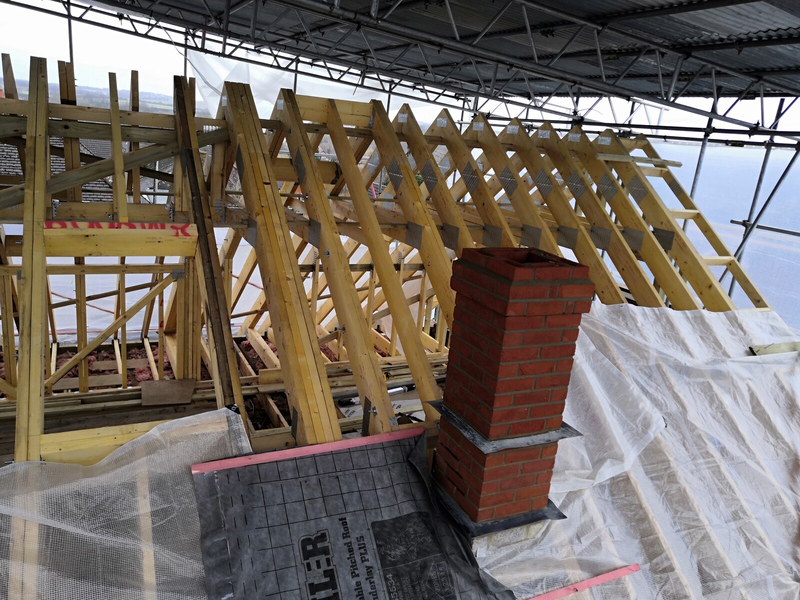

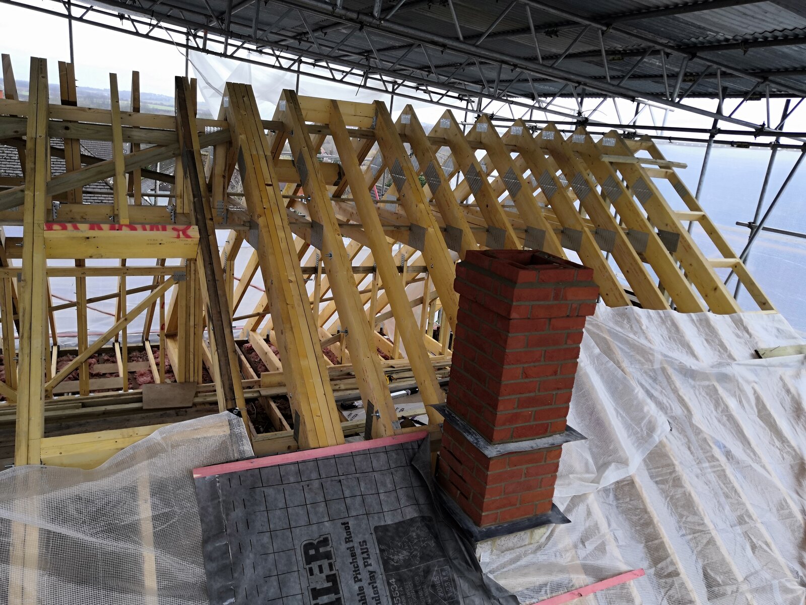

We did a hip to gable conversion in February 22. The truss designer do all the calculations and design for you based on your planning consultants drawings. The only thing we needed the SE calcs for was the lintel loadings over our existing windows and a new steel for a bifold doorway into proposed extension.
We did a 10mtr by 10mtr roof on attic trusses at 400mm centres, though Pasquals including the full design all the metalwork, gable ladders was about 15k.
Cost me £700 for the hiab long reach crane.
Full tin hat scaffold was 5k, to strip roof and redo roof battens, tyvek, and retile.
Materials about 1.5k say 1.5k labour.
Leadwork was £750.
Chimney rebuild was £750 labour materials were free of last new build.
To have gables build up in concrete blocks and intertal studwork and celotex about 2.5k concrete lintels all round £500
Steels £400.
New windows for gables £600. Velux windows x 4 £1200.
Labour for my dad and builder to build the truss sections. £4500
Smitch over 35k. We did reuse our tiles.
Obviously needed roof vents, dry ridge kits and tile and halves.

Thanks for sharing that detailed breakdown on your conversion. That seems like a really good price overall for the work you had done. Ours is a slightly smaller area and possibly more straightforward as standard pitched-roof semi bungalow. We have been quoted around 7-8k for trusses. Gives me hope we can get it done on budget even with tin hat scaffolding. One builder we've spoken to reckons it could be a couple of weeks while the roof is not weatherproof so we might not get away without it and could slow down the work without.
