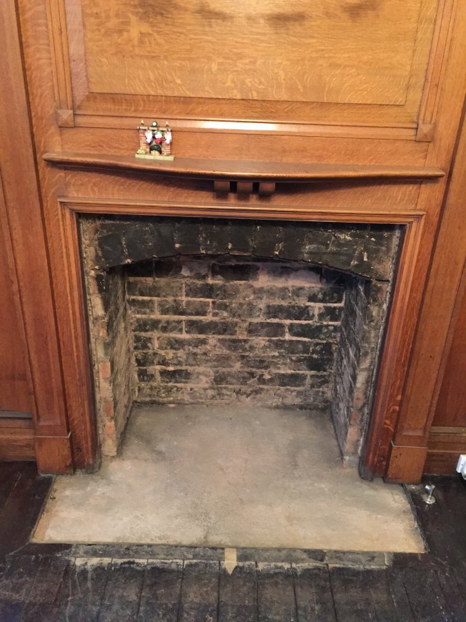

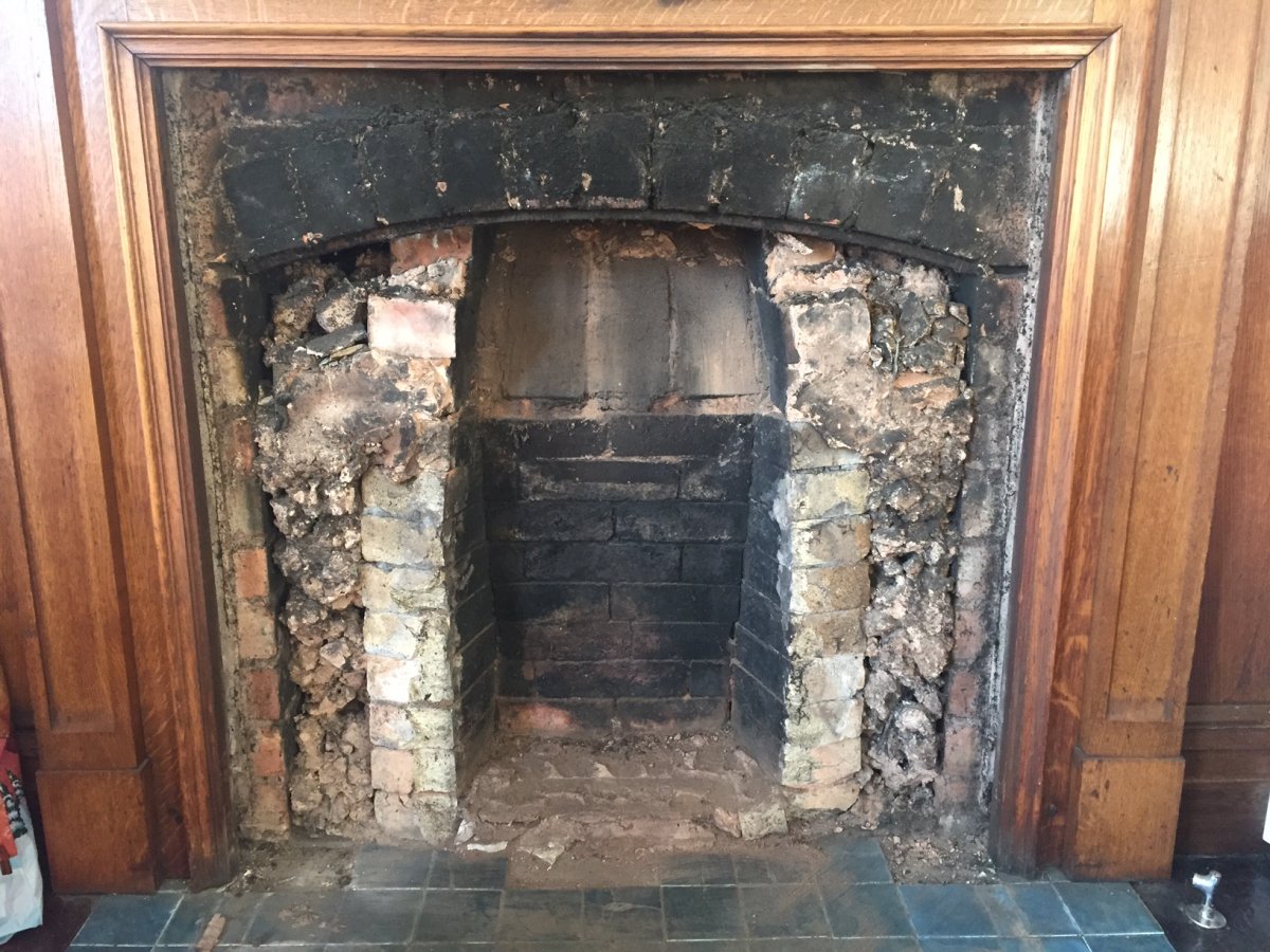

Just removed the old fireplace as the first step of trying to install a log burner. Pleasantly surprised that the builder's opening is ample size. The arched bricks, which I'm sure are now self supporting, have a curved steel bar beneath them which I'm wondering if it offers extra support. Anyhow, it looks to me like there is a fireplace built within this opening. My initial thoughts are to just knock it out, but looking up the chimney it seems that an internal chimney extends up about 3'-4' which sits on the fireplace bricks. Is it simply this and can I remove the lot?
Top photo shows fireplace within the builder's opening, bottom photo has the front of the chimney at the top and the back of the chimney at the bottom with the sides curved up within the builders opening. You can see the start of this curve from the first picture

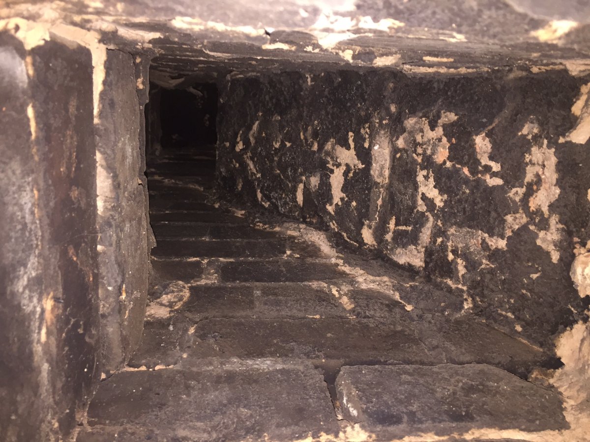

Just to add, the chimney stack is external and goes straight up for at least 3m before it gathers in for the fire in the room above. Am I correct in thinking that the narrowing of the chimney by the fire place is not gather and merely a throat that can be removed?
As I see it you will get bricks coming away on the L. side of your flue photo, where they have been built up. The R. side is part of the original build ( I vinndicate my assumption by the presence of parging on the R.) So start removing bricks from the L. side @ the front;)
OP,
You will have no problems removing all the infill inside the original builders opening - remove both sides back to the arch supporting bricks.
The fireback brickwork in your pic can also be removed.
Leave the metal bar alone unless its rusted.
After doing the above send pics of the throating - how you arrange the "entrance to the flue" will depend on what kind of appliance you install.
However, you must work to the Mfr's min. opening dimensions for the appliance you want to install?
The flue in the pic is separate from the fireplace and flue in the bedroom above.
FWIW: remove the restrictor elbow and gas supply back to source if you no longer need them.

Thanks both for your input. I've shown these pics to numerous people now and the consensus seems to be just remove the "stuff" inside the opening being careful for bricks not to drop on my head!
The metal bar also supporting the arch is in very good order. Just minimal surface rust.

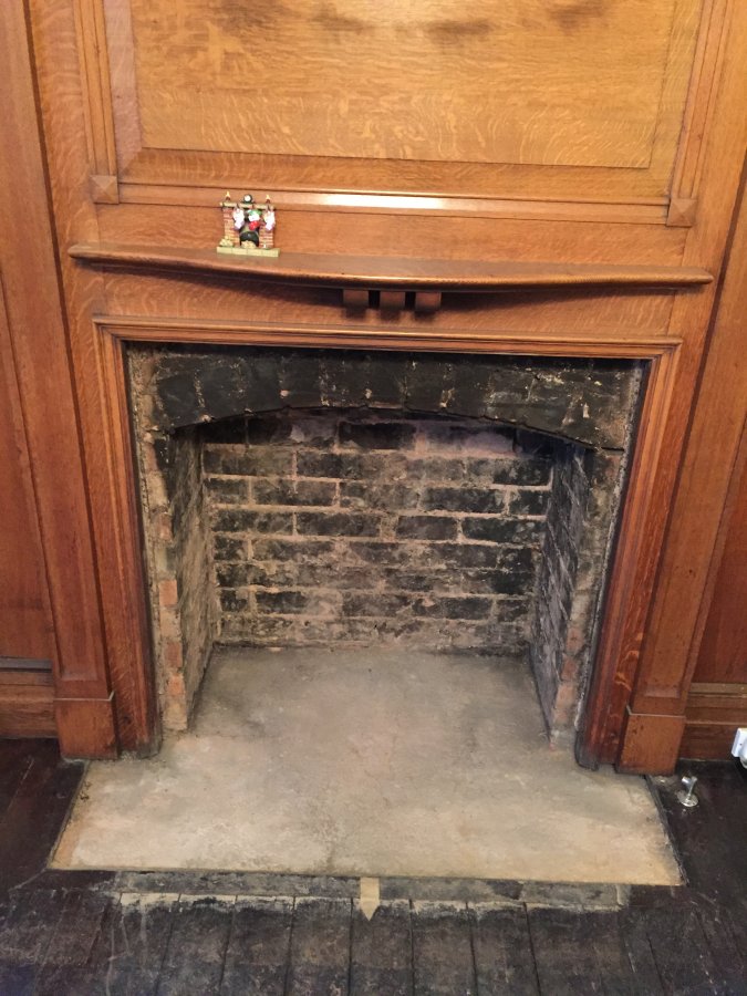

Been bashing around today and now have a decent opening. The bricks that made the throat are properly solid even when the brick fireplace was removed so I intend to leave them in situ. Can't see them falling down of their own accord when my hammer doesn't budge them.
I think I'm just gonna use a liner with no filler.
Anyone got an idea what might clean the bricks up? Would be a lot easier than rendering as they seem in good nick apart from the soot.
I'll be laying quarry tiles on the concrete hearth and fire place I think.

Don't wet the bricks whatever you do, as the soot will just soak further in. I've yet to find a method of cleaning sooted bricks up, so it'll be interesting to see what others have to say. Post a picture up the chimney though. You'll need to wire brush where you're going to set your closure plate so that you can seal around it.
Nice job so far.
Wire brushing is the only method - even a dry scrubbing brush wont be nearly as effective as a wire brush.
You could clean them up and render with a sand and lime mix or use backer board on three sides - it really all depends on what kind of finish you want. IMO old brick is best.
Your latest pic shows what appears to be (perhaps historic) smoke stains bleeding through the panel of wood above the mantel. Was there a mirror on that panel? Dont attempt aggressive removal of the staining, just leave alone.
The smoke came over the front of the brick arch it didn't penetrate the c/breast brickwork from the flue.
