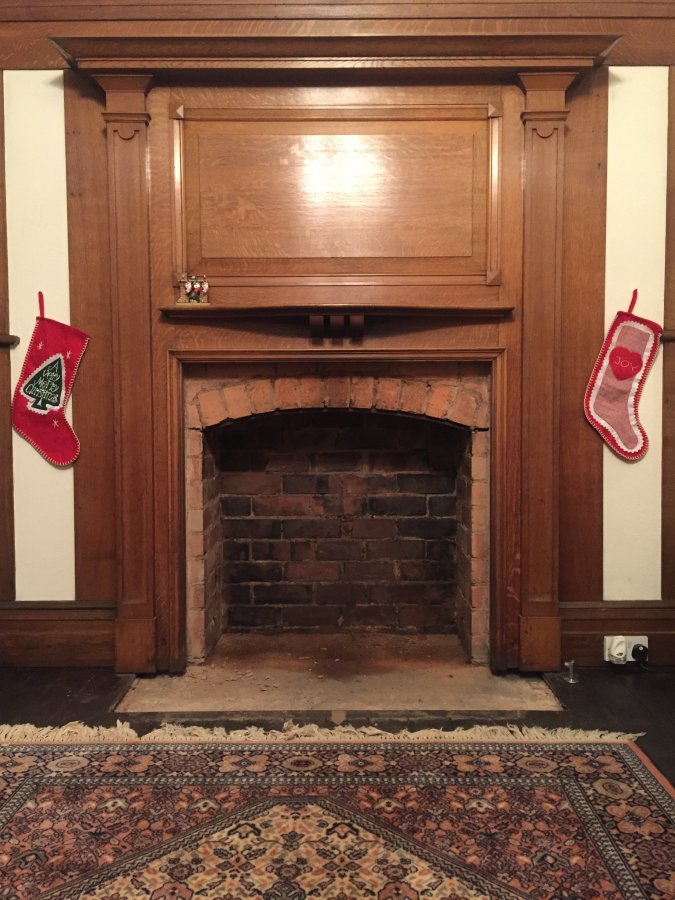

Vinn. That "mark" you can see on the wood panel is just a shadow of a token Christmas decoration hung over the top! Here's the proof with it removed!

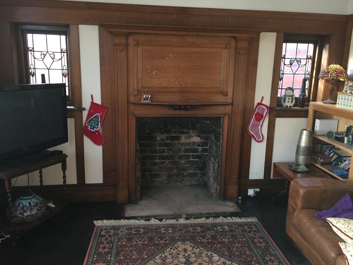

To report back on soot cleaning.....
Wire brush = removes surface soot but leaves bricks black
Cif bathroom foam = removes some of the black staining but not much
Sand paper = WINNER! Hard graft but does the job.
What do you think? Leave as brick or render?

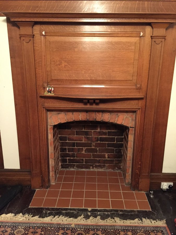

Also, before I lay quarry tiles in the hearth, I have to bring the height up a bit - not much, about half an inch. Can I just mix concrete for this? Cement and sharp sand or do I have to throw some lime in too? Could I put down a self levelling screed or would this not be good with the heat?

Leave it as brick dont alter anything.
Sandpaper is a new one - a sander might even produce better results but the down side is removing more face from the surface of already damaged brick. The protective patina of external bricks is rarely exposed to sanding.
Why is it necessary to raise the height of the hearth by 12mm? Simply spreading thick adhesive, and buttering the back of the tiles will lift the finished surface.
The idea of raising the hearth is partly to use less adhesive and partly to level to make tiling easier. Hence thinking about self levelling compound. 12mm is an average, there are some dips plenty deeper. It's all over the place really and I'm not the greatest tiler!
Glad you have voted to keep brick. I was inclined to do so as it is far less work. Should I seal the brick?
Dry fix your tile layout before doing anything else
Then use bagged powder adhesive, and first dub out (fill in obvious dents etc) and allow to dry after smoothing off.
And then, as I described above, set the tile.
Dont seal the brick, dont ever seal (aka glazing) any brick anywhere, it looks cheesy and usually fails after a while.
