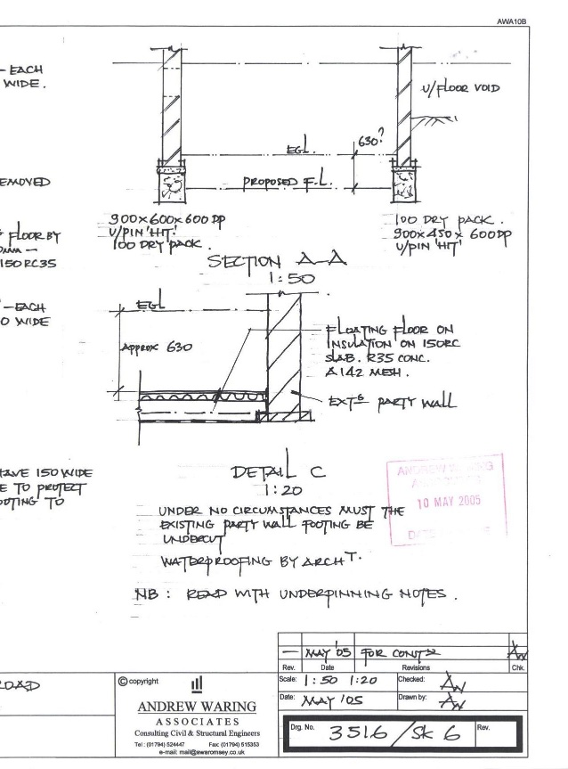

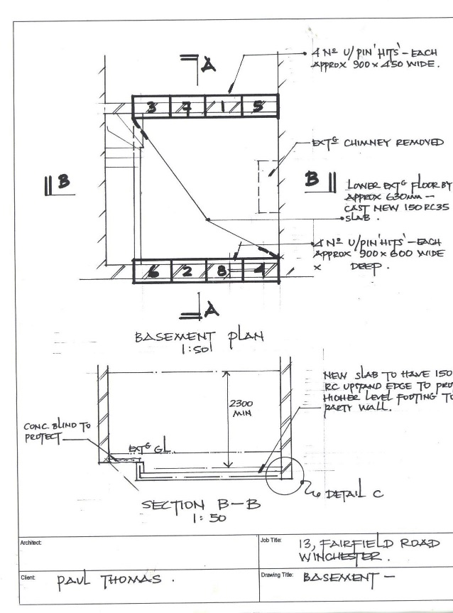

I've added some engineers drawings for where I underpinned an existing house...
