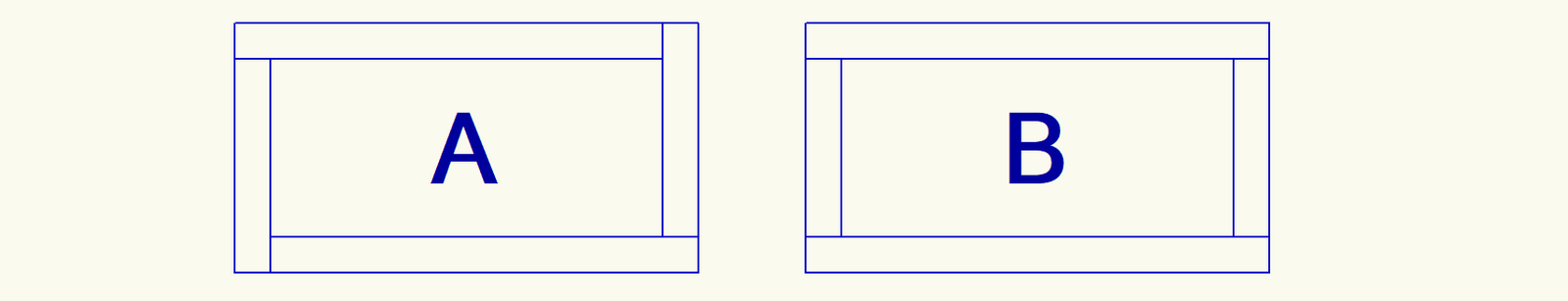

Anyway, a simple box I fully understand but what about the thickness of the wood, that will need to be calculated into correct?
Example.
A box with that is 200mm x 400mm x 600mm. I would need 2, 200mm x 400mm, 2 200mm x 600mm and 2 400mm x 600mm however if the thickness of wood is calculated into the same box, with 18mm thick, wouldn’t I need 2 200mm x 382mm 2 200mm x 582mm and 2 382mm x 582mm
Could someone please just confirm my thinking here, and if so, do you know of a simple way to calculate all of this? Even an online free calculator would be helpful.

It rather depends on how you want to assemble the pieces. Your second set of figures is correct if you assemble the pieces as in Figre A below, but would differ if you assembled them as in Figure B.
It might differ again depending if the box measurements are intended to be internal, or external.

The first thing is to do is obviously to decide on the size and as said above is this internal or external. Also important is how accurate it needs to be: a box wants to be strong and good square edges to the pieces are an important part of this. The bigger the box the more strength it is likely to need and the thicker the wood you use the easier itis to form simple joints, I would suggest that 18mm ply is a cheap strong and easy material to use and can be sanded and varnished or painted to look nice if required. The point about accuarcy is that some 18mm material is a bit thin si if you want to cut tight rebates then you have to have physical measurements but most of the time it doesn't matter.
Start with a picture of what you want to make it clear in your mind: Alec drew 2 options and B is the easier one to use and I think looks better but their is another option which I think is easier still, and that is for the end pieces to fix on the ends of the side pieces rather than between them. This allows the joints to be tight even if there is some inaccuracy in the cuts
Lets assume you want you box to be 600 long and 300 wide internally and 250 deep.
The base piece we'll make 600x300
The sides need to be 600 long and 250 plus 18 high so they will fix to the edges of your base piece. (I would rip a piece to 600 and then rip that down to the widths I wanted so they are all exactly the same length) These pieces can now be assembled into a U shape by laying the base on your bench and sliding the sides up.
For the ends we need pieces 300 plus 2 lots of 18mm wide and 250 plus 18mm high. This just goes straight on the end so if it's a fraction big or small it doesn't matter.
