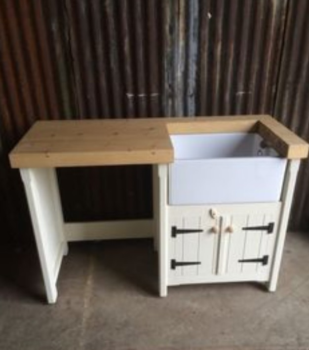

I'd like to get a few opinions on building this stand.
I'm pretty good at joinery, but I know I won't get a spray lacquered finish as per the photo.
This aside, how easy would this be to build? How should I best go about it ?
That's a mortise and tenon jointed frame and panel construction. How good are your joinery skills? If you aren't that good, maybe a simpler approach using Dominos, dowels or even (wash my mouth out) pocket hole screws might work for you.
Depends how close you want to match the photo. Easy enough to buy lacquered panels and get similar design.
A few thick planks needed for the top. PLaner/thicknesser?
Be sure to cut the ends off and use them for the side on the right. As opposed to wasting a huge chunk doing a cut out.
