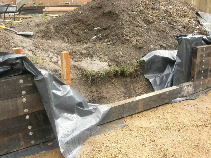

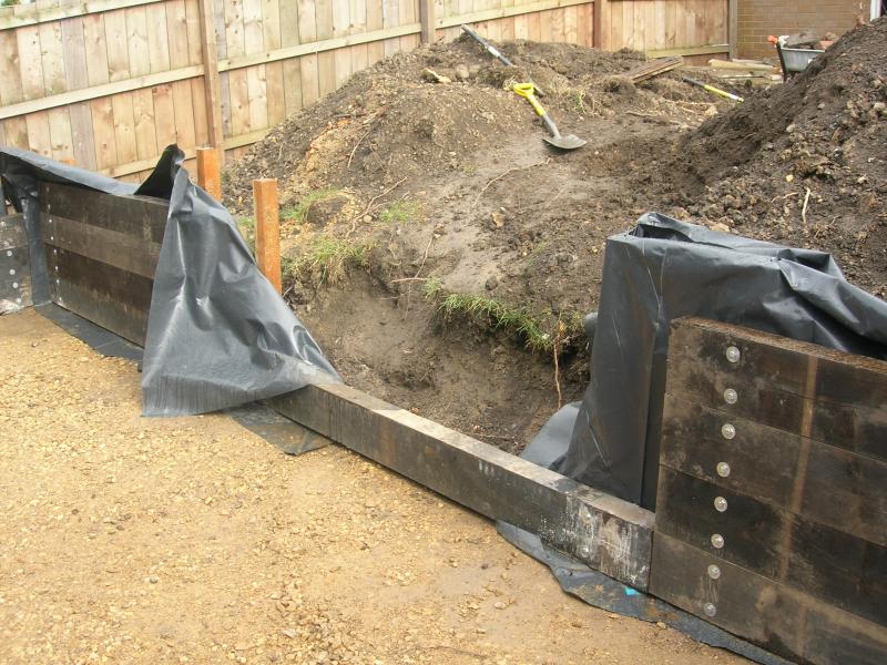

I'll be building a step into the middle of the two sleeper walls. It won't be a whole sleeper's length wide, but a flagstone width of 600mm.
Do I need to dig tout he entire space for the step, right to the bottom level of all of it? Or just dig out each layer?
I was going to create boxes almost with railway sleepers and then fill them with compacted hardcore and then mortar and stone.
I'm up to speed with many things in the garden these days, but not quite sure which way to attack this one.
Cheers
the way we do it is dig out eah step, build the sleeper box, and use some supporting pegs at the back if necessary, then backfill it. Very easy to do
Digging the step out first it is then.
Am I right with waht needs to go into it? Do I need 4 inches hardcore then mortar etc?
And to confirm, the boxes sit on the soil themselves? No need to put posts in to fix the sleeper box to?

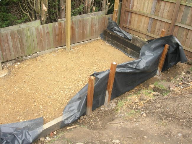

In addition to what I've just mentioned above, I've been out in the snow with the tape measure. If I do it this way that means I'm going to lose a lot of lawn space as the steps will start around 2.4m before the end.
Can I run what I think are two options by you?
1. reduce the width of the steps from 600mm to something a bit less? But can't see how much less I can go without making them too narrow to walk on.
2. build the steps side on and paralell to what will be the patio area? Can this be done?
I think the second option might cause a few problems in terms of security of the steps

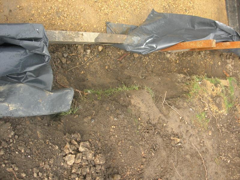

If I was to go for option 2, which is looking more favourable, are there any issues with how they are dug out? As you can see There already a bit of a void behind the sole middle sleeper. Will I need to build this back up? And will it be a case of digging the whole lot out side on, and almost builiding an identical sleeper wall the other side (towards the house), to which I can build back up and fix the steps onto.

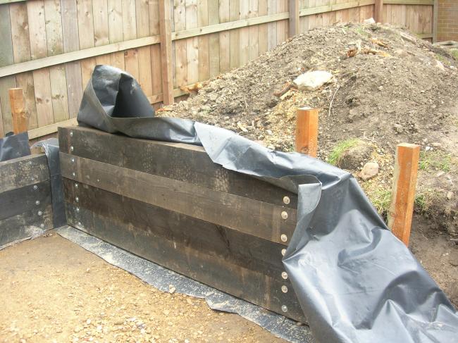

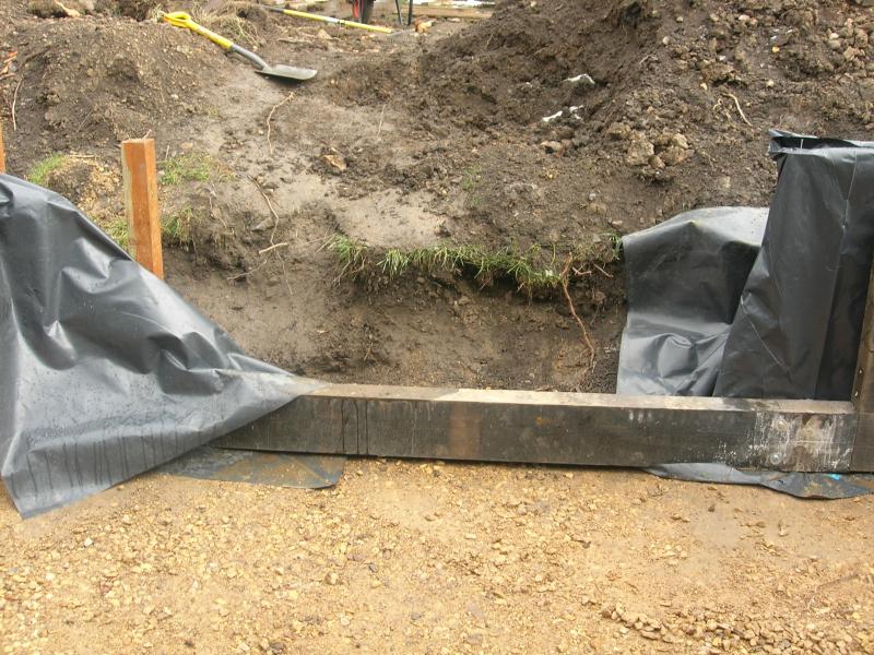

Right, taking into account everything I've mentioned above. Below is four photos of the area where the step is going

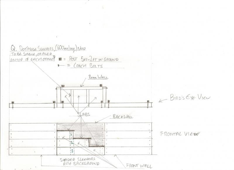

Also here is a very basic (!) drawing I have come up with which I think is an option (???).
Looking at the bottom drawing (Frontal View) Do I need to put sleepers 1,2,3 in place as cross bracing supports. Or just No. 1 for the slab to rest on?
If it's 1,2,3, then do I fill the void left with soil, then hardcore, then mortar? If it's just No.1, do I fill the whole 'box' with hardcore, soil, or could I use gravel for some of it as I'll have some spare?
Many thanks

the sleepers can be single. they should have enough support once its all backfilled and from the surrounding structure, or you can always use a support post.
are you sitting the slabs inside the sleepers or over them? If its the later then it may not last long term as the wood will move at differential rates to the mortar. we always inset them like this

1. Should it be back filled with soil, hardcore, then mortar, all in steps if you like from left to right?
2. Do I need a whacker (sic?) plate to compact everything or will something else do?
3. I've now realised that as there'll be a big drop between lawn and patio that I'll have to put up some sort of rail to save my young daughter from going head over heels! I guess I could fix the rail to the existing sleeper support post could i?
Thanks again
shall i come and build this for you, it will be done quicker! :lol:
1: yes
2: no, just use a rammer, or a length of a sleeper to do it
3:yes
