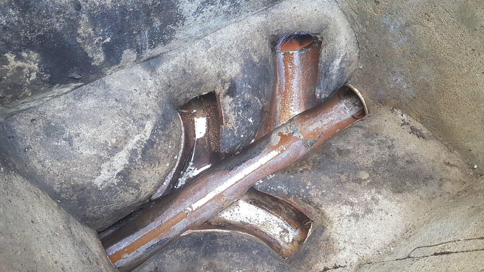

So by proper channels you mean like the one I have currently in this photo?

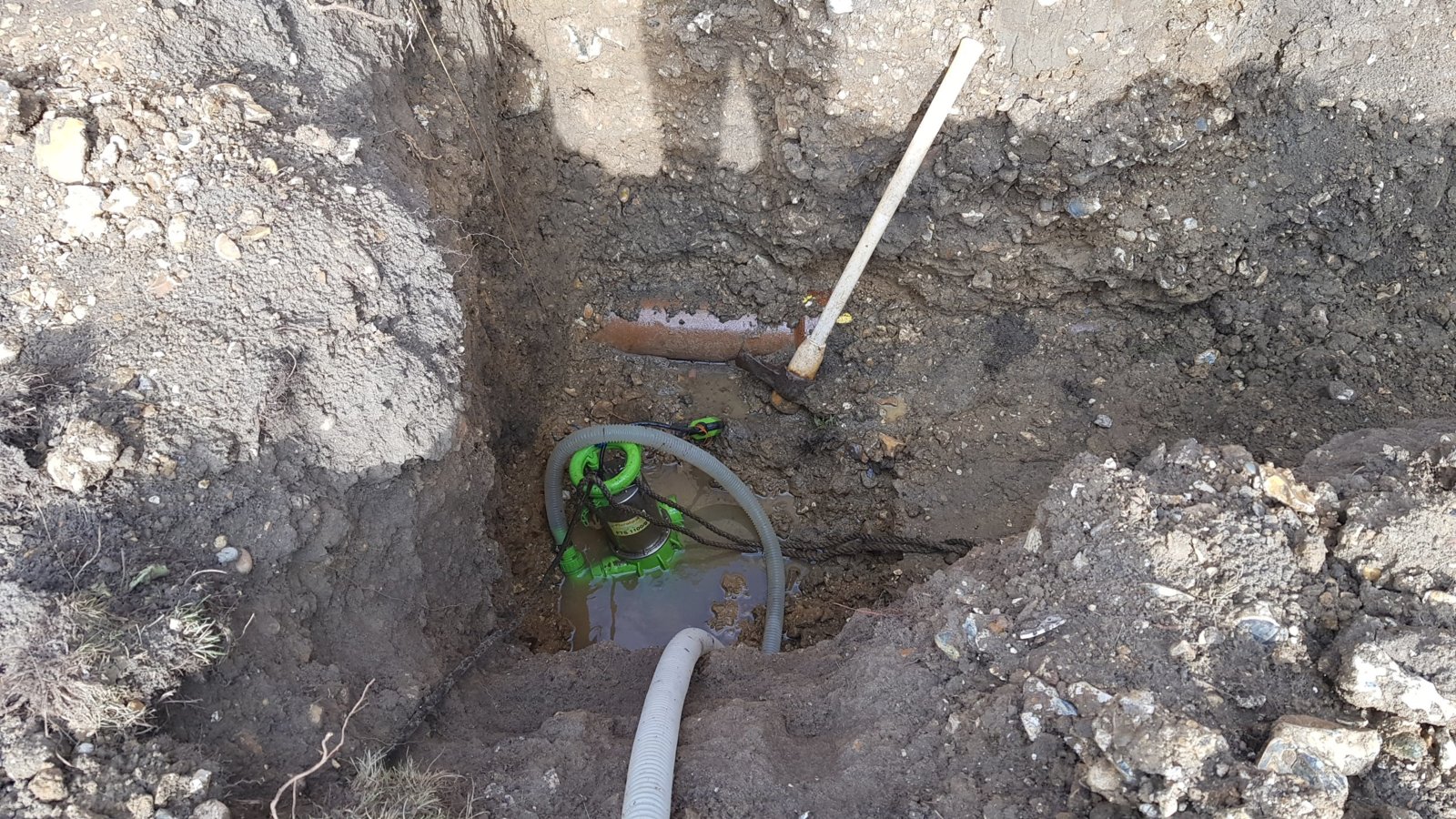

Is there nothing ready built I can buy? Like the plastic chamber but in clay? It's going to be a nightmare building this in this weather - plus the ground water is level with that pipe! You pump it out it just comes back.

I'm only trying to avoid clay channels as benching might be tricky for me in this weather and the thing sits in ground water.

The 'ground water' may well be the existing sewer leaking, looking at the pic. Be careful how much you let Thames see, before they start getting ideas about lining it or something.

As for the ground water I actually called them over as I thought I might have damaged the pipe. They came over and used coloured dye and cctv - all they said there was no damage and he's pretty sure is not sewage.
