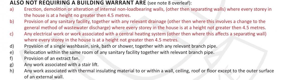

I was under the impression that adding insulation did not in most cases need building regs approval.
But I'm in Scotland, so maybe this is something that's different.
For example here's one random Google result from Clackmananshire:
http://www.clacksweb.org.uk/document/2111.pdf
